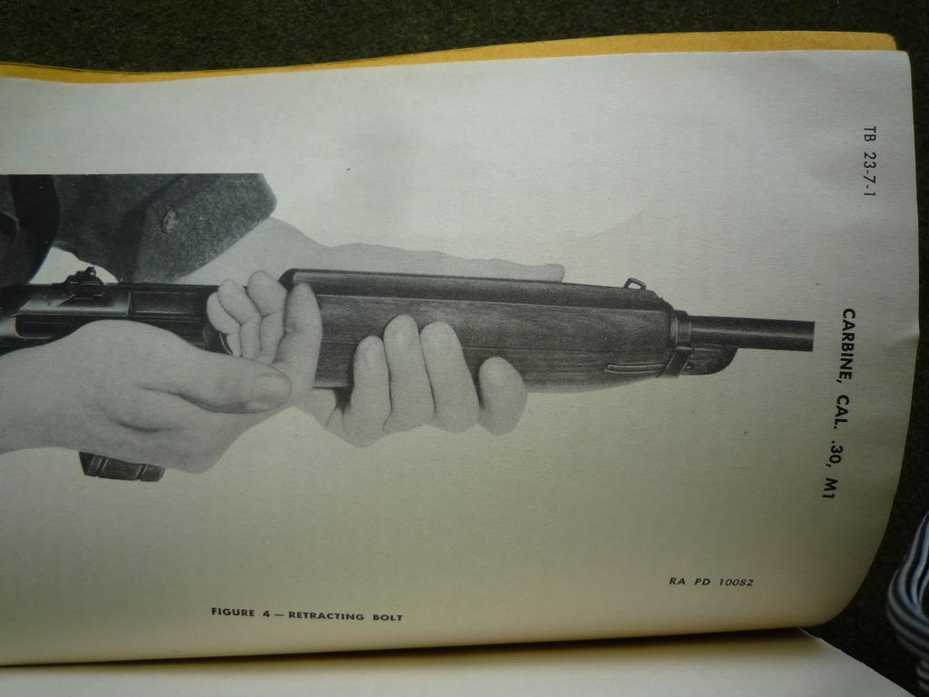

    In the post 'Unusual WWII Photo' you'll see we get a bit off topic, when discussing the proper way to retract the Op slide/bolt.
    We touched on What Is The Proper Way- to charge the carbines bolt after seeing this picture put up by JimF4M1's. Picture is from TB 23-7-1 March 1942.
    Note the picture shows the palm up while pulling back:
    And somewhere I seen or read that this was the "Proper Way', because my next trip out I tried and didn't care for this method. I thought it may have been in the video... linked below, but it shows Palm Down straight pullback using thumb and index finger:
    Cal .30 M1icon Carbine (1943 WWII U.S. Training Film)
    This video is an official U.S. Army training film.
    TF9 1206 1943
    https://www.milsurps.com/content.php...-Training-Film)
    Now after reading FM 23-7 May 20, 1942, LINK BELOW:
    I find it also states using the Palm Down Thumb and Index finger to pull the Op Slide back.
    EXCEPT: in section VI page 23 it says:
    b. Procedure.-(1) Carbine fails to fire.-With the right
    hand palm up, use the little finger to pull the operating slide
    to the rear. Release the operating rod, and if the operating
    slide goes fully home, aim and fire. To avoid injury in case
    of hangfire, the hand is so held that no part of the palm or
    wrist can be struck by the operating slide in its rapid rearward
    movement.

    No particular input on the cleaning but I would just like to say that I use the palm down method but I certainly don’t use my forefinger AND thumb.
    The Carbine has such a light recoil spring and short action, it’s pretty simple to just sling the bolt back with your forefinger.
    Even in the case of a slamfire, no body parts would be in the way with this method.

    Quote Originally Posted by rcathey View Post
    Agree, and surely no more in the way than if one used the little finger. I don't get it.

    I've read that before about the (3) cleanings with hot soapy water, and just figured that it might be something that was carried over from TB's covering other rifles that used corrosive ammo. Maybe it was recommended procedure for the others, and wouldn't hurt anything on the carbine. I don't have TB's for anything other than the carbine, so that's just a guess. My take on the "palm up" thing goes along with Dave HH's post in the other thread. If you have a FTF, you don't want to risk having the handle catch your thumb if the round goes off. I charge mine with my index finger too, but believe my thumb would still be "in the way" if the bolt suddenly flew back. I've only had one FTF (Wolf) and waited at least 30 seconds before doing anything. Next time I have one, I'm going to go with "palm up." My brother had a FTF with some Tula, and there was a bunch of smoke and fizzling. We both thought WTH, and he waited until it went quiet before pulling the bolt back. We found the cartridge had the primer installed edgewise! Still went off though, just had all the smoke and gas come out around the bolt face - the bullet was still firmly in place. - Bob

    The piston and its nut should never be removed as part of the cleaning process. Requires a special tool and replacement of the itty-bitty, wee, tiny, small gas piston nut. (Both of which would be easily lost by inexperienced troopies.) The gas piston was never intended to be user maintained. The gas system is supposedly self-cleaning due to it's location. Kind of makes you wonder who wrote that TM.
    A slam fire doesn't happen with properly loaded ammo. Doesn't happen with issue ammo either. A slam fire is caused by improperly hand loaded ammo. Usually high primers. And are not caused by the rifle.
    A hang fire is not a slam fire either. A hang fire is also defective ammo.
    Oh and it's with one's right hand held flat and slapped backwards against the op handle with the Carbine held against one's shoulder ready to shoot. When one shoots to correct left handedness. Not from one's waist as demonstrated in the TM picture.
