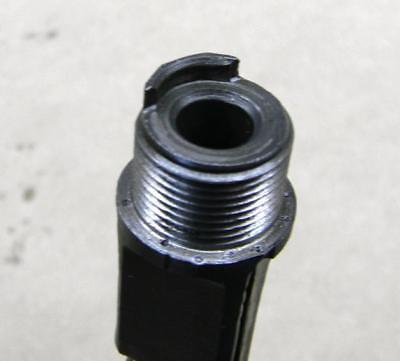

    Seems I recall a older CCNL that had a tip in it to peen like in this picture... I believe to get index marks to line up (?)
    Maybe not a CCNL, but seen it somewhere.
    Or could it have been for head space ?
    Or did I see the peening on the Receiver instead of the barrel ?
    He!! now I don't recall what I seen....
    Can someone explain it to me please?
    Pic is from a recently completed ebay auction.

    Looks to me like they peened to make the barrel tighten up sooner to line up the marks

    The way we used to give a bit of extra crush factor was to tap the edge of the barrel ring in front of the threads and then it crushed back to shape when assembled. Just a touch...
    In some places, barrels just aren't available, you have to work with what you have.

    I have seen that kind of peening on the rear face of the collar on the barrel extension of AR 15 barrels. Makes sense

    Center punching is not the correct method to tighten an over-turning barrel. browningautorifleicon has outlined the correct and commonly used method which is perfectly acceptable in most circumstances. Gentle and even peening of the edge will displace enough metal to achieve a very tight fit without any obvious damage.

    M1 rifle barrels have been peened too
    There are shims being sold for M14icon barrels and shims
    have been used on Model 1903 barrels

    I've done all kinds...over time. Carbine, rifle, .303, 1903...Winchester...whatever needed a new lease on life.
