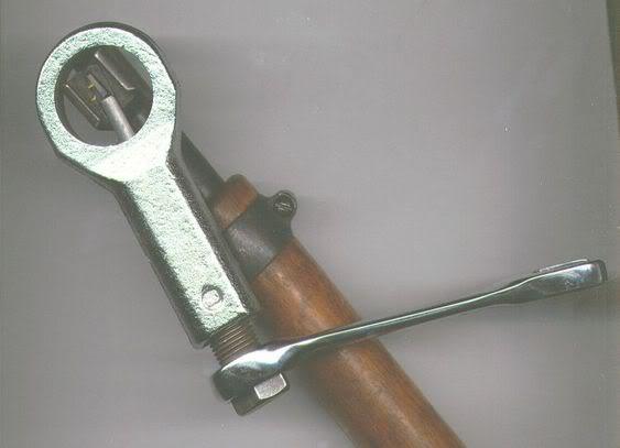

    I use this simple system. To be found in every hardware shop.
    Attachment 97780

    Yes,,,,,,,,, on a k31, but the G11 requires a bit of modification of that unit for it to work.
