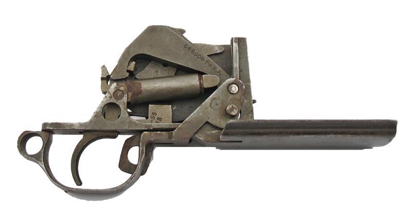

    The easiest visual external "tell" on an early WWII rifle is the milled trigger group. The early ones looked like this:
    That loop on the far left is what identifies it.
