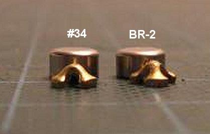

    10:22 AM
    CCI #34 primers are nothing more than magnum primers. The cups are no different than any other CCI primer.
    Loading for an AG is no different than any other semi-auto. You must FL resize every time, check the case lengths and trim chamfer and deburr as required only and watch the OAL.
    I'd use the 140's simply because they're easier to come by.
    Spelling and Grammar count!
    Advisory Panel Parashooter's Avatar
    Dec 2008
    09-24-2024 @ 01:41 AM
    Connecticut
    80
    680
    04-25-2025
    10:22 AM
    Quote Originally Posted by Sunray View Post
    CCI #34 primers are nothing more than magnum primers. The cups are no different than any other CCI primer. . .
    No and yes. Cups are same but anvils are reported as different/shorter - at least compared to the BR-2 primer. See post at So just how similar are CCI #34 250? - M14 Forum
