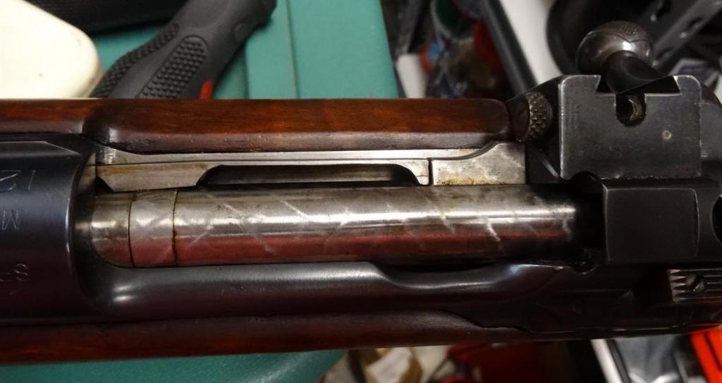

    Griffin and Howe heavy barrel M1903 target rifle
    I recently glommed this rifle at an auction and have been scouring the internet for any information about it with almost almost no luck.
    The auction pics and description...
    "Custom U.S. Springfield, Model 1903, Bolt Action Rifle, with 28" custom heavy barrel by Griffin & Howe, .30-06 caliber, SN 1269532, custom heavy walnut checkered stock, very nice condition."
    It arrived a few days ago and I got a chance to snap a few pictures before it went into my FFL's safe for a 10-day "cooling-off" period.
    Anyone have any information on G&H heavy barrel target rifles?
    The bore is very good...shiny, sharp and the muzzle measures "0" on the CMPicon muzzle gauge. The bluing is excellent.
    The barrel is marked "Griffin and Howe Inc New York"
    And "30.06 Gov"
    Bolt had striker modified and the bolt handle is marked "J5"
    Stock has interesting grain

    Finally got in and picked up my rifle.
    I couldn't find any more markings on it, other than this. Under one of the scope blocks I found "No 1x27". The X digit was drilled through for the scope block.
    Bolt body has the previously referred to "damascene"
    Muzzle is tight..."0"- on the CMPicon gauge.

    The barreled action is G&H but the stock certainly is not. G&H would never let checkering that bad out their door. Flat diamonds and border overruns are never seen on a G&H made stock. Nor would a Lyman 48 relief cut ever been done like that. Check with them, they may have records of what it was.
    Legacy Member Calfed's Avatar
    Oct 2007
    07-15-2024 @ 09:25 PM
    Land of the Free
    70
    1,014
    04-25-2025
    12:51 PM
    Quote Originally Posted by mr humble View Post
    You could be right. A poster on another forum advised that the relief cut for the sight looked like it had originally been done for a Vaver sight. I checked the Vaver sight for the 1903 and it looks like that poster could be correct.
