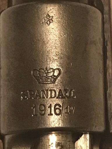

    I recently found a GEWicon 98 at Cabela’s and it followed me home.
    The question I have is the receiver shows it was made in 1916, but it looks like someone added “/17” after 1916. Is this a hack job, or were these really marked that way?

    I believe that this is a so-called 'Sterngewehr', assembled from parts available as an emergency measure during WW1. The star indicates emergency make and the appended date indicates date of acceptance using a previously made receiver. More images would be needed, such as proofs, stock markings, matching bolt or no, etc to be able to get closer to which factory made it, but the ammunition plant in Dresden was apparently one of several pressed into service to get these made. As always, experts are asked to help out here, but in my opinion this is a sought-after rifle as they are not as common as others.

    That's interesting. The floorplate doesn't match either. there may be other numbers. I wonder what the crown stamp means? It looks like the Danishicon crown, but they were using their own Krags, making some of them too.

    Spandau shows a crown over the writing.
    Exactly like this.
    It is a legit marking.
    Nice rifle!
    I love the Gew. 98.

    The Germans were a monarchy at that point in time, up until 1918 so the crown was for the Kaiser.
    I also believe that the * not only indicated that it was made with previously made parts but previously made parts that had been rejected for being slightly out of tolerances. I would have to double check it though.
