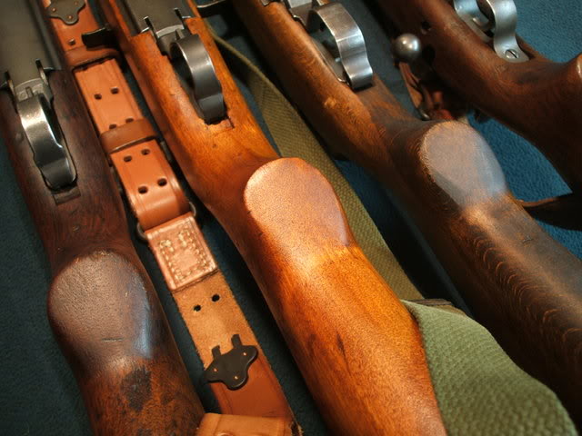

    I received my standard grade DGR stock today and am super pleased! The fitment is spot on and the walnut grain is beautiful.
    Sorry about the picture quality. The weather turned to stink this afternoon with marble sized hail and lots of rain.
