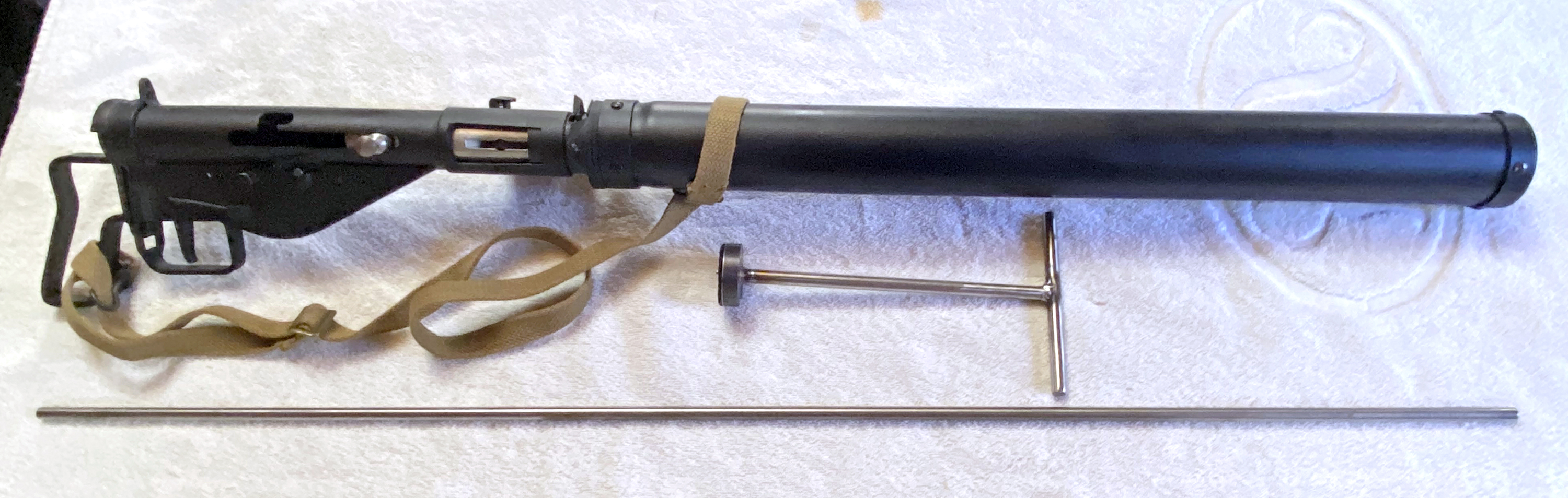

    Not surprisingly, nobody on the site has any info. However, the MOD really came through with abundant pics, just received, in response to my request! Somebody there really went to a lot of extra effort, even taking their Mk II/S apart to take the pics. They didn't tell me who the super-troop is, so I had to send a blanket "THANK YOU!!!!" Hope it gets to the right person.
    I realize this is more than a little esoteric, but my SOE/CISA can build is complete except for the ratchet plates. As I noted in my original post, in the US it's legal to put a commercial can on a semi Sten as long as you have the tax stamp (I thought we fought a war to eliminate tax stamps, but apparently I was wrong...). So I have a B&T can for an MP5 inside my big 22.5" tube. It's amazingly quiet--almost "Hollywood silencer" quiet. Super fun to shoot. The B&T is FA rated, so if I ever get a FA Sten I'll really have a...blast!
    With the advance registration and a tax stamp I could actually build an exact duplicate of the CISA can, but it's a lot easier to put a commercial can inside a cosmetic tube--same appearance and probably about 1/8 the work (and it was still a LOT of work to get the tube done anyway).
    Anyway, the MOD provided these pics, which I'm posting in case anybody is insane enough to make an operational replica. I realize these are more of historical than practical utility, but here they are (all pics from MOD; no copyright was mentioned). The parts are definitely black, but I've lightened the images to make the detail easier to see.

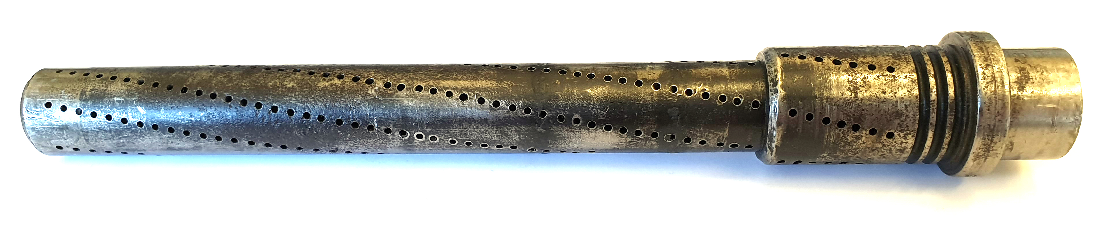

    Finally, here's the drilled barrel. Peter's book gives a clear explanation of how this drilling was accomplished.
    Attachment 111154

    That's a lot of holes! Does the muzzle end get a deep counterbore? Seems with that much bleed-off the bullet might not make the end of the barrel...

    Peter notes it was to reduce bullet speed to subsonic, and that the CISA unit was very nearly silent from 40' (yards? can't recall) away.
    Yes...that's a lot of holes. I assume the drill press operator got intense psychological counseling after completing each barrel.

    The need for the extra ratchet locking mechanism is simple. The original locking mechanism is adequate for the standard shroud and barrel but was to feeble for the extra dimensions and weight of the suppressor. The increased surface area of the additional ratchet made for a much more secure attachment.

    You're right about the need for an additional closure for the big silencer (we'd call it a "suppressor" in the US, but Peter notes it was called a "silencer" during the war). My build, which so far does not include a second closure, has a tendency to work loose if the big tube is held wrong during firing. I have to be careful when I let other guys shoot it; I check barrel nut tightness after every shot or two. I also filed the teeth in the barrel nut catch a little deeper to help it better grip the barrel nut.
    From looking at the pics and showing them to several machinist friends it appears fabricating a similar unit on non-CNC equipment would be quite a difficult project. I'm toying with the idea of having the locking unit drawn up in 3D CAD and printed in one of the new 3D aerospace printing substances. Expensive as hell, so probably won't, but nice to dream about.
    Childhood fantasies tend to be expensive when actualized...but the mod looks cool and shoots like a dream. And I have the only one like it any time I to go a range.
