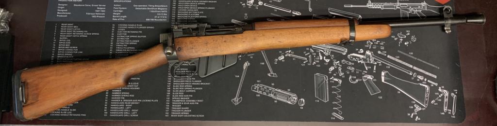

    This is the only one so far...

    Quote Originally Posted by Nick S View Post
    That is enough to show it is a No4 body.
    The lightning cuts for a No5 body don't appear to be there.
