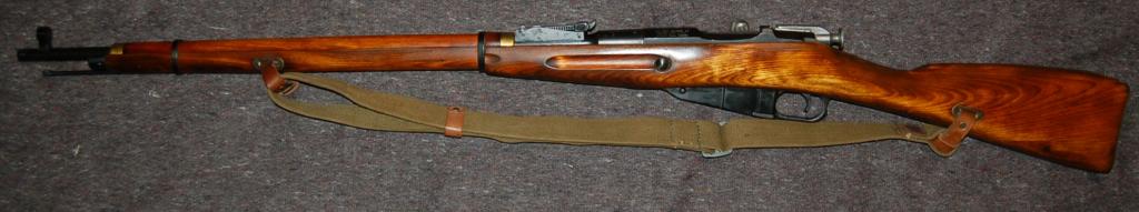

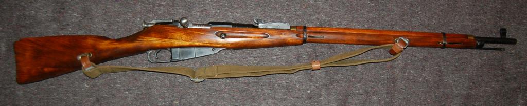

I got lucky and picked up a 1930 91/30 yesterday (yep, one of the very first 91/30s) at an auction. The bluing looks great (re-arsenal?) and it is in a pre-war stock. The problem is the stock has been "bubba painted" with a spray paint camo pattern (I'm sure it fooled a lot of deer!). I have reviewed earlier threads but none of them mention what the original finish on a pre-war Mosin Nagant stock should be. The stock on this gun needs to be stripped and I want to return it to its original finish. Can anyone advise what that would be or where I can find the info on it? I know it is not that nasty red shellac finish. Thank you for your help!

I should mention it is all matching (receiver, butt plate, bolt and magazine floor plate).

out of the garage. This rifle is pretty cool, in that 1930 was the first year of manufacture for the 91/30, so this is one of the first 40,000 made. I can't see any refurbishment marks on it since whoever had it applied some other type of varnish and the camo paint patches on it pretty thick. It is all matching so I'm thinking it may have lived a privileged life somewhere until Bubba painted it. I'll strip it tomorrow and see if there are any refurb marks on it. A really nice rifle like this truly needs to be put back to it's original look and feel.

She is a pretty rifle, Hex at that. I have a host load of Mosin Nagant, all different variants. two still in the cosmoline
. I have some info on them if you need any. Just PM me if you want what I have electronically and ill email the stuff to you.
