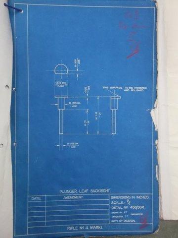

    No 4 Mk1 Trials Rifle Rear Sight Plunger & Spring
    A favour from members who are lucky enough to own a trials rifle with its original rear sight.....
    I'm after the details of the spring and plunger (dimensional details ideally)
    Many Thanks

    There's no plunger, it's only a ball bearing and if you measure the hole with a vernier or plug gauge you'll find out what size is required. I'm afraid I don't recall except that it is possibly a few thou larger than the major diameter of the shank on the later plungers. The ball bearing idea wasn't a great one as the small contact area no doubt soon led to deformation of the hole and looseness in the sights.
    A plain cylindrical plunger made up with a half round end would be another option if the hole is too badly worn at the top to hold the sight consistently enough for shooting - if one wanted to shoot such a rifle.

    Are they so different from the No 4?
    Very different
    Trials rifle rear sights had circular cutouts for a ball detent for the raised and lowered positions
    Std production No4 sights had flats that rested on the familiar spring loaded 'top hat'

    Quote Originally Posted by waco16 View Post
    Very different
    No matter how I looked I couldn't find detail on them... The standard sights I have...
