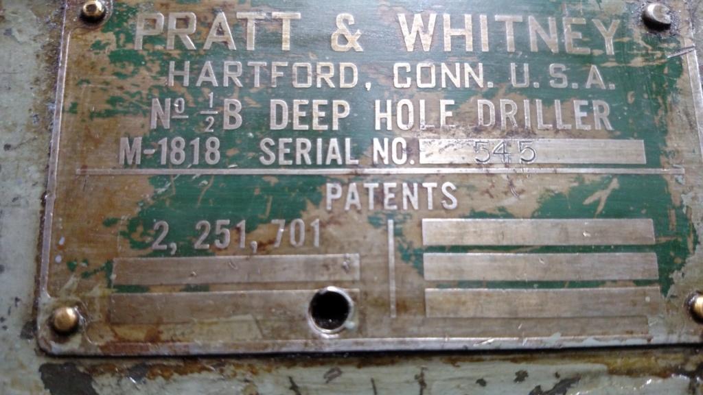

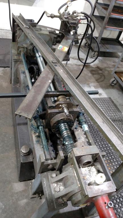

    The rifling machines on site at what was previously Montana Rifle Company/Remington were designed and fabricated right there. They look about as technologically advanced as a club - but at one point those two machines were rifling about 20,000 barrels a month. The guys we brought back said they were most reliable machines in the shop, and the new guys (after they'd graduated from the barrel lapping benches) were put on the riflers because they were the most simple and easiest to run.
    After working with those 1930's Pratt & Whitney machines for nine months, it leaves me with a bit of professional curiosity about the machines and methods used to deep hole drill and ream Long Branch's.

    Those rifling machines welded up out of HSS don't look too inspiring I agree, but obviously they did the job and I assume that is because the barrel itself is guiding the broach/button?
    The old P&W deep boring machines, now those I wonder about: they don't look like they've had a rebuild since new? Were the ways ever re-ground?
    If I understand the process correctly those determine whether the hole that becomes the bore is the true to the blank or not, but maybe that is that all taken care of when the blank is profiled between centers before rifling?
    Pretty much: the buttoning rod is pulled through the drilled and reamed blank, coated inside with a slippery soap. More or less self centering.
    I found no documentation while searching for service manuals, etc that said anything about their history of servicing. Pratt & Whitney did a spectacular job of ignoring any and all email and phone inquiries about any documentation they might have. Which is kind of remarkable, considering how many barrel makers STILL use them, particularly custom barrel makers. Dan Lilja also in Montana being one, if I remember correctly.
    The old MRC staff we found and I talked into coming back (or maybe they wanted to come back anyways) told us that they were told "run 'er till she breaks" first by Remington during their ownership, and then again by the new MRC owner group who bought it after Remington dumped it. So yeah, they're in sad shape, the running gear even more than the ways.
    After doing QC/QA on hundreds of barrels prior to shipping, I never saw one that was off-center to the round barrel blank. Or at least, not one that could be determined to be off center by eyeball. At regular intervals, a newly drilled barrel off a drill is mounted between centers on a test fixture and checked for runout with dial indicators. When I left we were using a +/- of about .005", if I remember correctly .
    We were not doing any profiling. We had more than our hands full producing rifled barrel blanks in the caliber requested. I believed that was an enormous mistake, particularly when it would have taken a comparatively very small amount of additional time to place a rifled blank in one of the unused multi-axis CNC machines and end up with a profiled, drilled, threaded and chambered finished rifle barrel to sell.
    So sell the blanks for somewhere around $32 each, depending on caliber and length; versus several hundred to sell a finished barrel ready to go.
    Which is one of the reasons I'm not there anymore. Stuff like that, while sitting on a gold mine like that in a time of demand like the last year and now. Those machines desperately in need of a rebuild and needing time and constant adjustments to turn out a finished drilled and reamed barrel would be much easier able to handle making perhaps only 5,000 barrels a month to be used to produce finished barrel. Versus productivity rates of 35+K a month of rifled barrel blanks.
    Sadly, I doubt my friend who bought the carcass of MRC will still be operating by the end of next month. Insisted on taking too much of a bite with the condition of the machinery he got with the purchase.
    Really sad. I used to sit there thinking what it would cost to tool up one of the unused machines to do simple .303 barrels of optimal bore and groove diameters, or even replica Lee-Enfield and Ross Rifle barrels.
