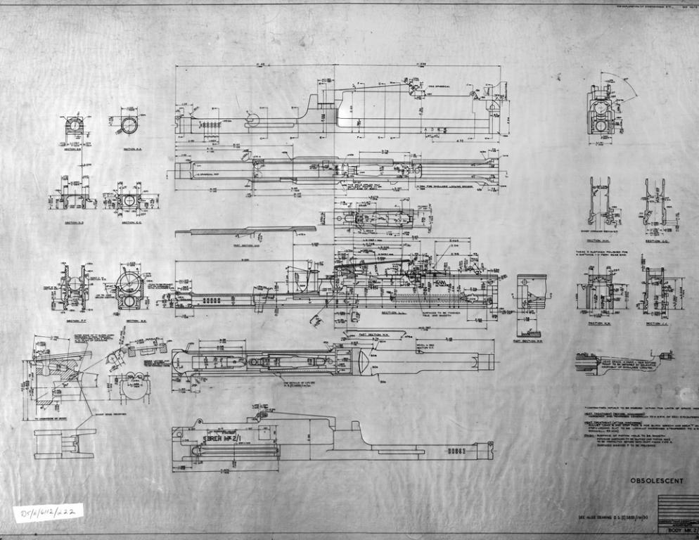

    Thanks for the schematic Snafu. the piston is half way across the front row of gas port when the bolt is fully forward. The gun is a rebuilt gun. The upper receiver was not cut up, and I scrounged the rest of the parts. 1 thing I did noticed when I did some comparison with my buddy's mk2 is that in my case there is a lot of play between the bipod sleeve and the gas cylinder. Starting to wonder if the gas cylinder outer diameter is just worn out to much that its letting to much gas escape? I read somewhere that this was a big issue with early MK1s and that's why the gas cylinder what modified.
