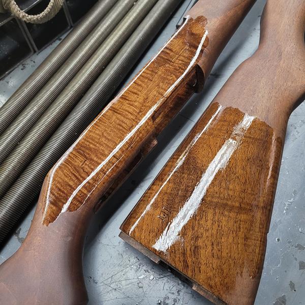

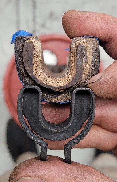

    Ended up with a NOS Italianicon BM-59 stock. It had its front tenon, its barrel channel, as well as the op-rod clearance routed way off. Lots of chiseling, but the tenon fitting is the interesting part.

    The option that was left was to chisel the tenon down to the point where the ferrule would actually locate correctly in relation to the receiver, then epoxy in place.

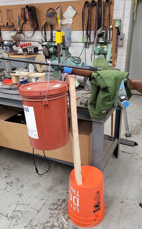

    Receiver then clamped in the stock with its trigger group. Front ferrule loose to the wood, but the tenon spaces filled with epoxy. I had some 3M 2116 Grey from a project at work. Fantastic material.
    A 40-pound bucket of oil was hung in front of the lower band to deflect the barrel as the epoxy cured.

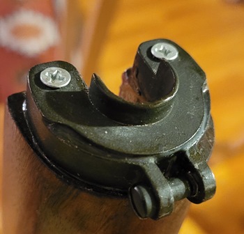

    After the material set over the weekend holes were drilled through the ferrule and into the wood and the face of the ferrule was countersunk. Both holes were countersunk just enough so that the screw holes cleared the lower band.
    Yes, the zinc on the screw-heads look horrible. I was out of time and the rifle was needed for a match.

    It was quite a bit of work to save some pretty curl.....
