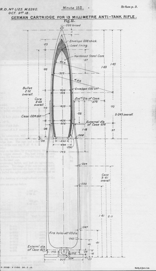

    **ISBN 3-933481-06-6 - A dimensioned original Mauser drawing of the T-Gewehr cartridge is on P. 108

    Note re. bullet diameter.
    I see that you quoted the T-Gewehr bullet as 0.525" diameter. But the Mauser drawing gives it as 13.2mm (=0.5196mm). With a groove diameter of 13.28 = 0.5228".
    In other words, the bullet was quite clearly smaller than the groove diameter Do not fall into the possibly disastrous trap of assuming that the bullet had groove diameter!
    0.525" = 13.335mm. That would be seriously oversize for the T-Gewehr.
    Be very, very careful converting between inches and mm.
