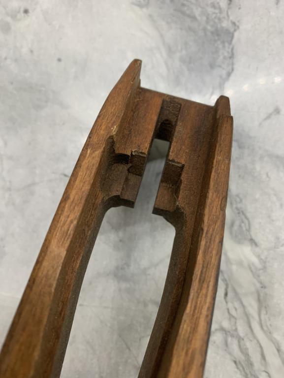

    I checked the nose cap and it seemed like there was a gap so I tapped it tight to the nose of the forend and still won’t clear.
    Here are some pictures of what I’m dealing with.
    Basically with the nose in place, the rear won’t clear and with the rear dropped in the nose won’t clear. I also added a picture of the draws to show where they are making contact, maybe I could shave a RCH off the face of them but with this contact the nose is not yet seated so i don’t want start working the draws until I can get it in place first.

    How about a pic of the knox form at the barrel ring to see if the barrel has indeed been set back one turn. Common solution for excess headspace and a #3 bolt head... That's just about the length of distance we're dealing with by the pics...

    Yup. Looks like a bit of front body pad visible in one of the pix.
    If you haven't already done it it might be worth taking off the foresight protector to see if the transverse locking pin is missing from the foresight block. If it has been removed at some point then the block could have offset backwards. May or may not be this, but if it is it's an easy fix.
    Thanks for the tip!
    This one is full length, I even compared it to 2 barrels here, one that is full length and one that is turned down one thread.
