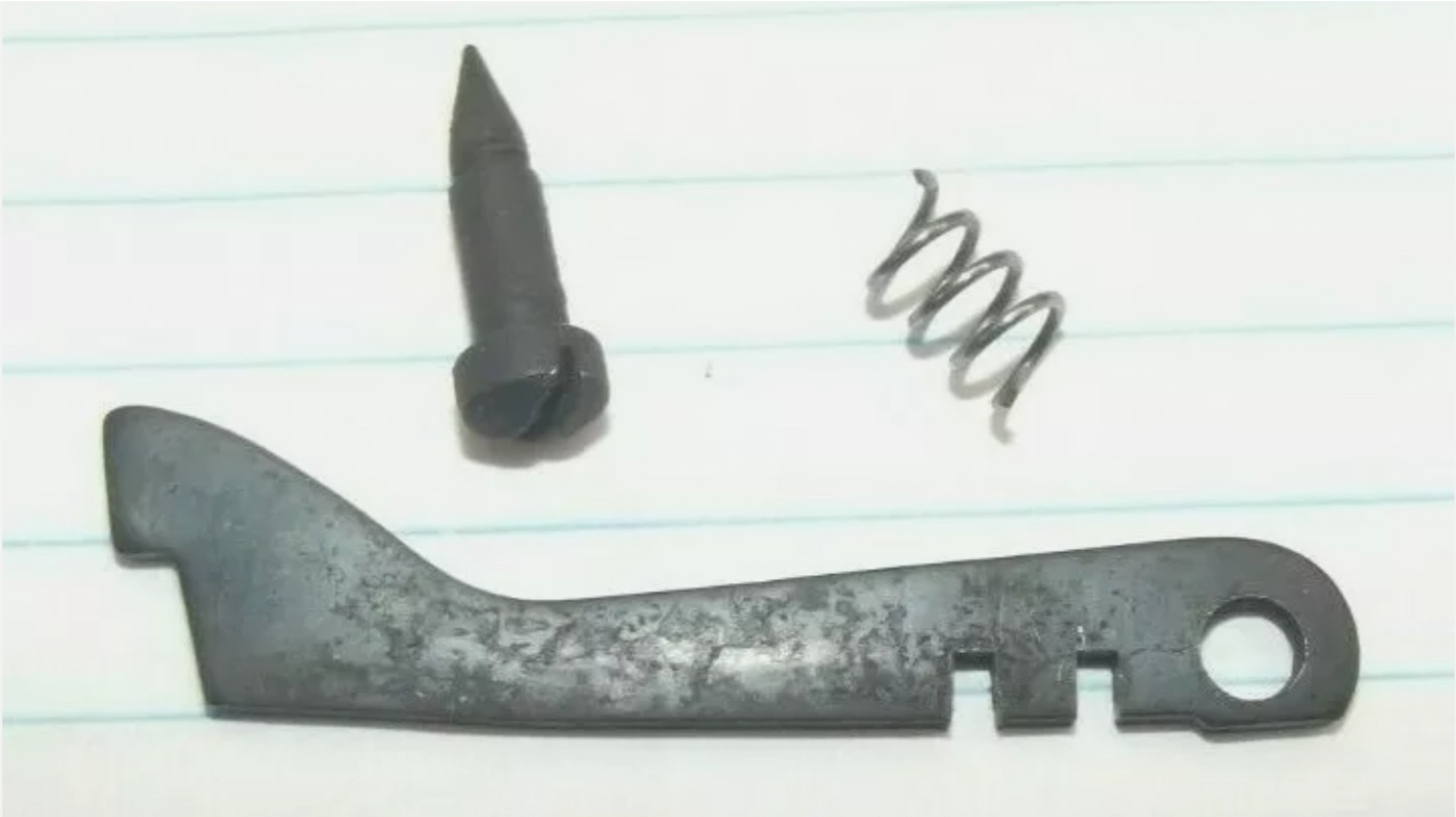

    This is not mine nor do I know the seller this is just a heads up.
    Break proof NOS coil sprung ejectors. They are on my P14 and M1917. I haven't seen these for sale in years and it says the seller has 2 left. Ever break one early into a range day? These last forever. Grab them boys.

    Repaired several using coil spring from tire valve.

    Or use a spring from a pen. Interestingly, two CAI stamped rifles I bought both had the modified ejectors in them.

    The ones for the Remington 30 work just fine. I think they are still available at Nurmrich? But as said a ball point pen spring and the broken ejector will work for most shooting.

    Simple mod you can do yourself with a small spring and Dremel cut off wheel. I have done many.

    I bought a 1917 Eddystone years ago that came with 2 government issue replacement ejector springs installed. These are discussed in the C. R. Stratton book page 42.
