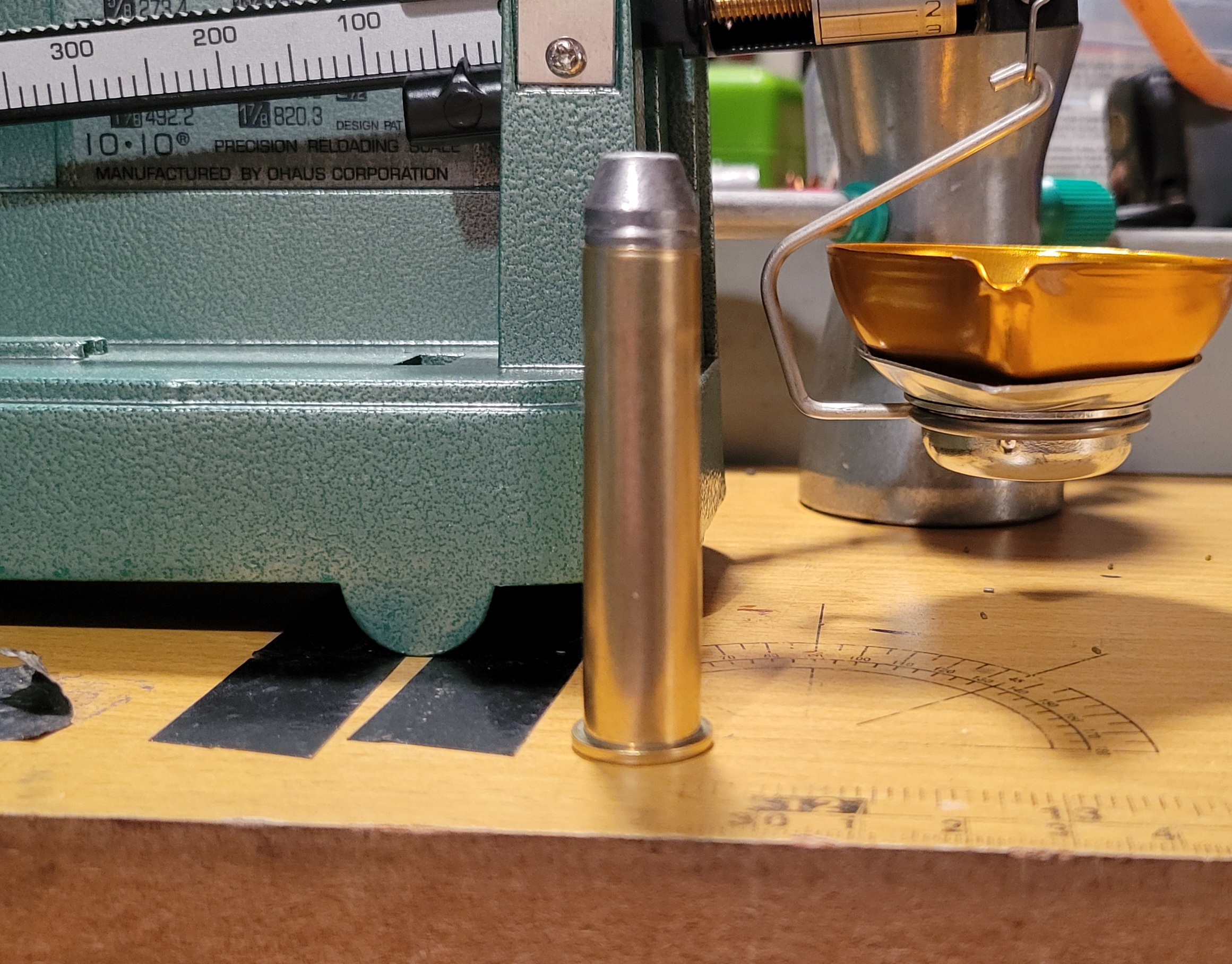

    Ok so this is nothing to shout about however there are a boatload of excuses I can attach to it. Front sight is way too low and a wrong middle band doesn't let the Buffington lay down all the way. Over 60 year old eyes and a 130 year old Buffington sight! Ammo I didn't load myself ect ect ect.
    This is my first time using a rifle of this type and I have to admidt it was a lot of fun. My brother was at the next bench with his AR and we had a laugh about the huge technology gap in the century between the 2 different service rifle types. This 8 round group was all I could do during a single range session. My brother did 5 magazines.
    Obviously the big holes are the trapdoor and the orange spot I added to the bottom was my point of aim. There's a lot of potential in this huge boomstick and I will develop it over time. I had a lot of fun and that was the point of this exercise.

    No, it looks good. Lots there to work with and the bore was stellar. Once you start loading and get the bugs out it'll be fine.

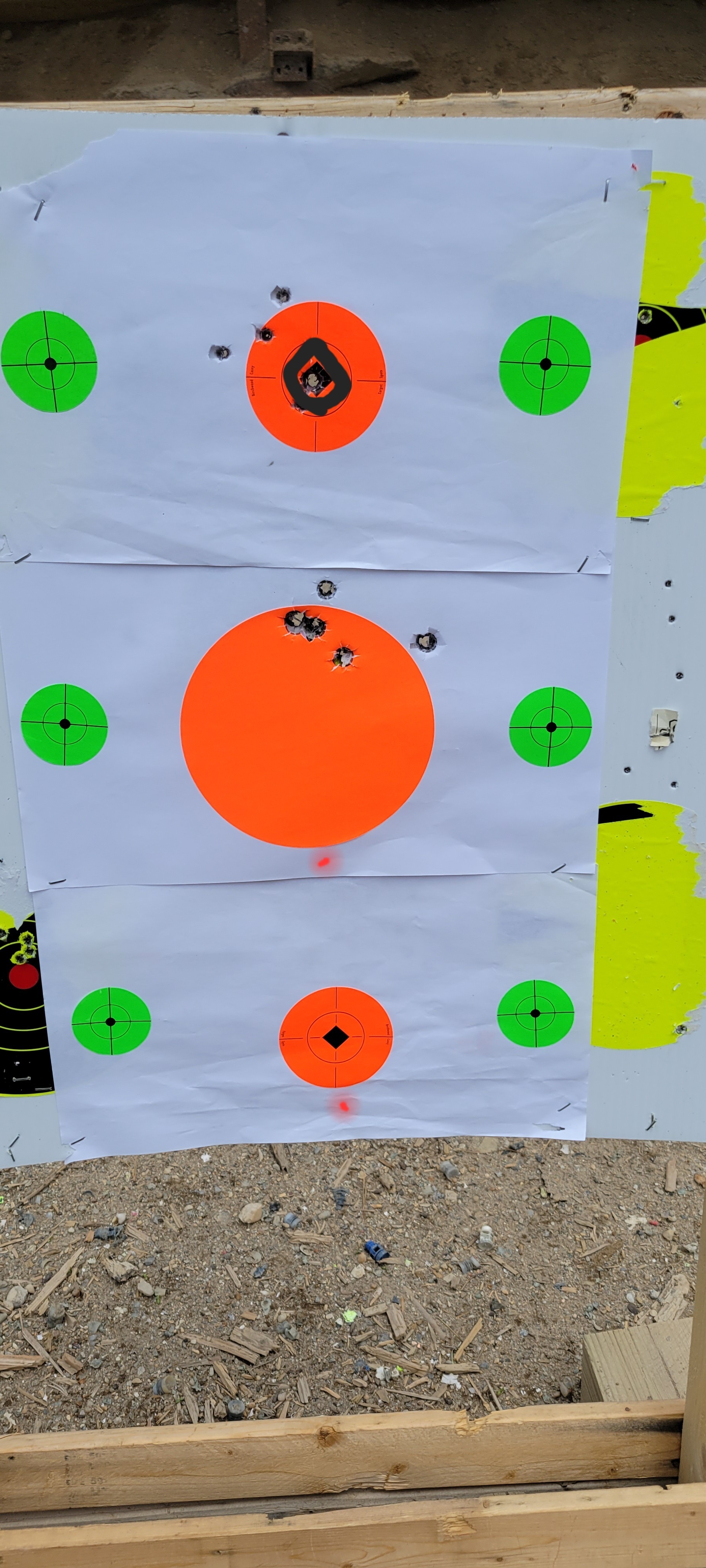

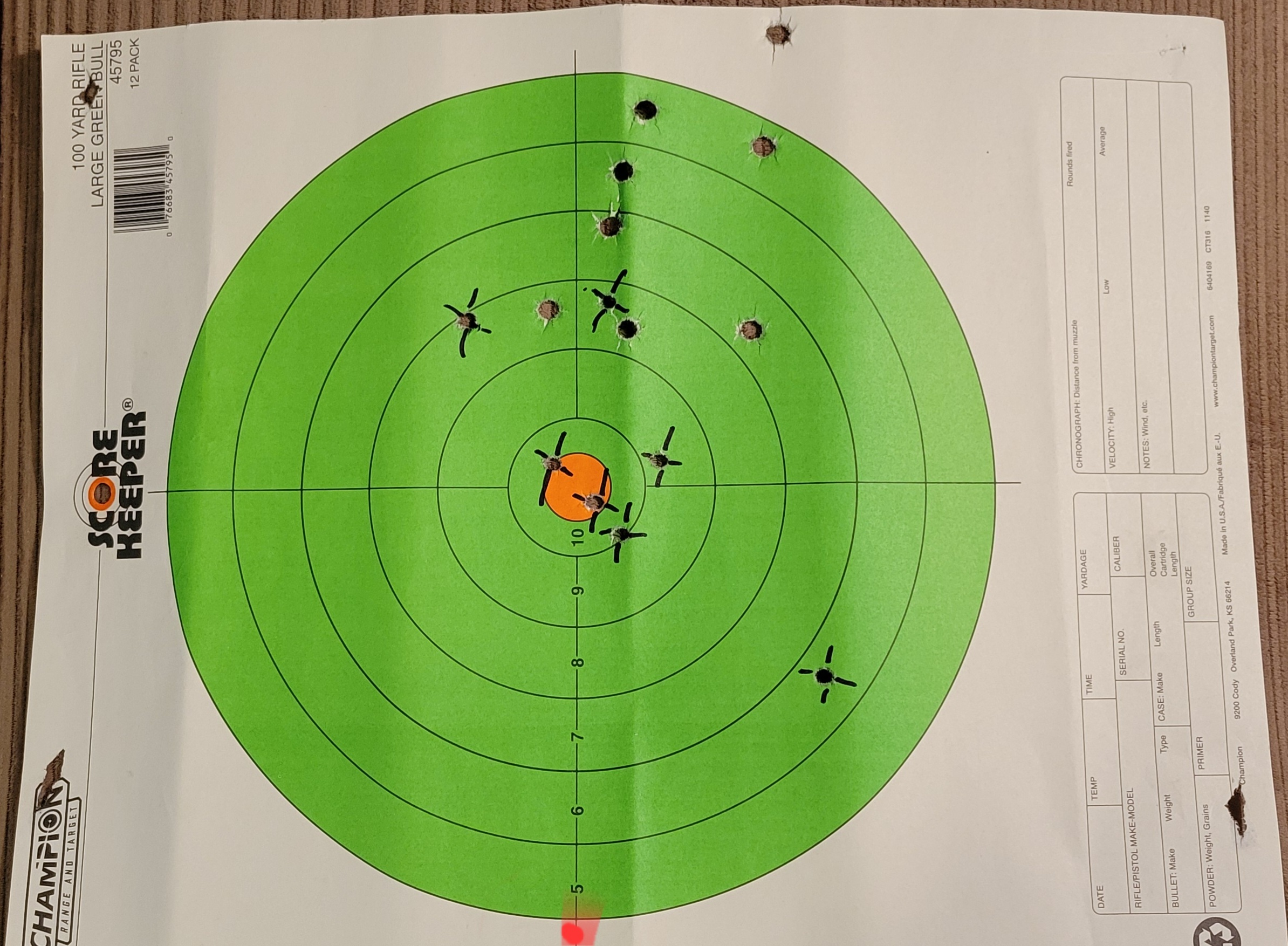

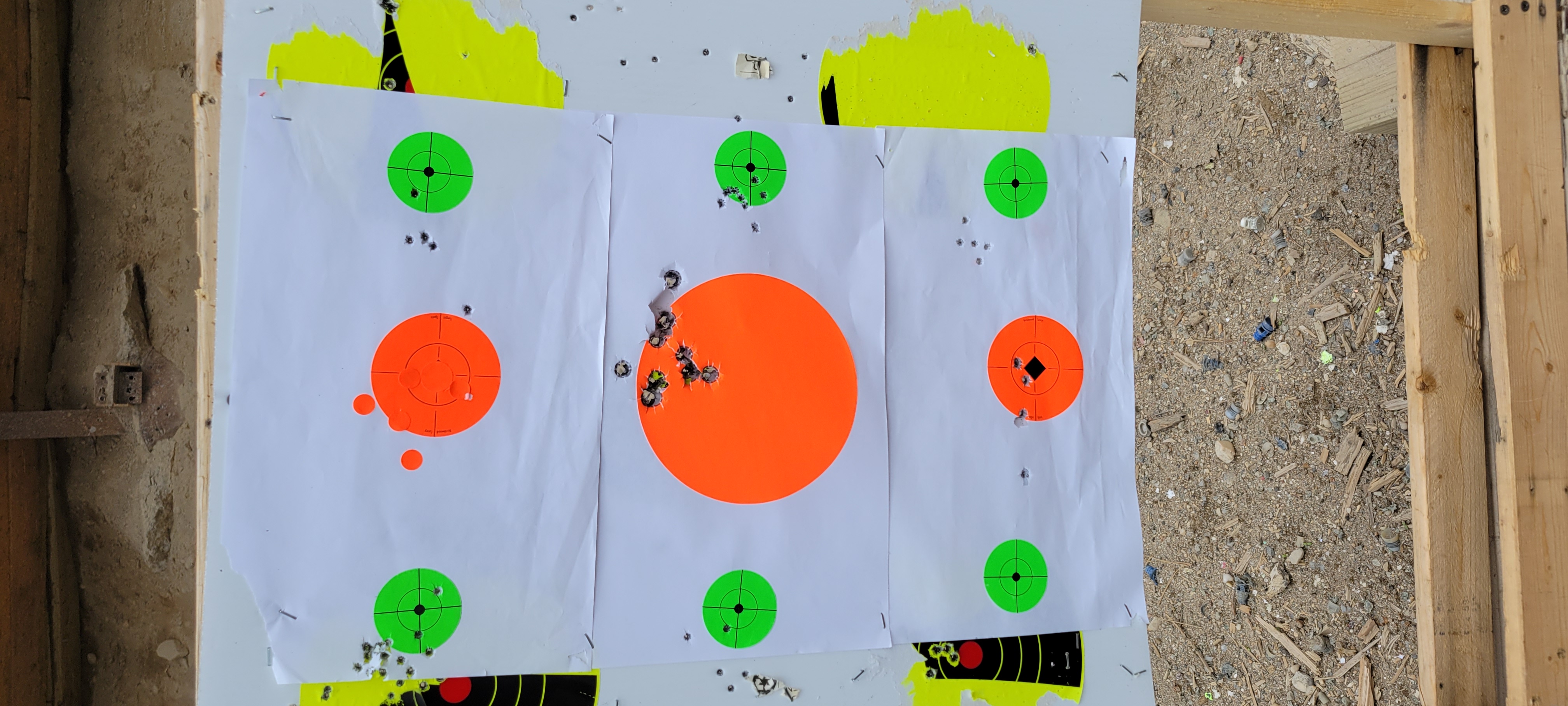

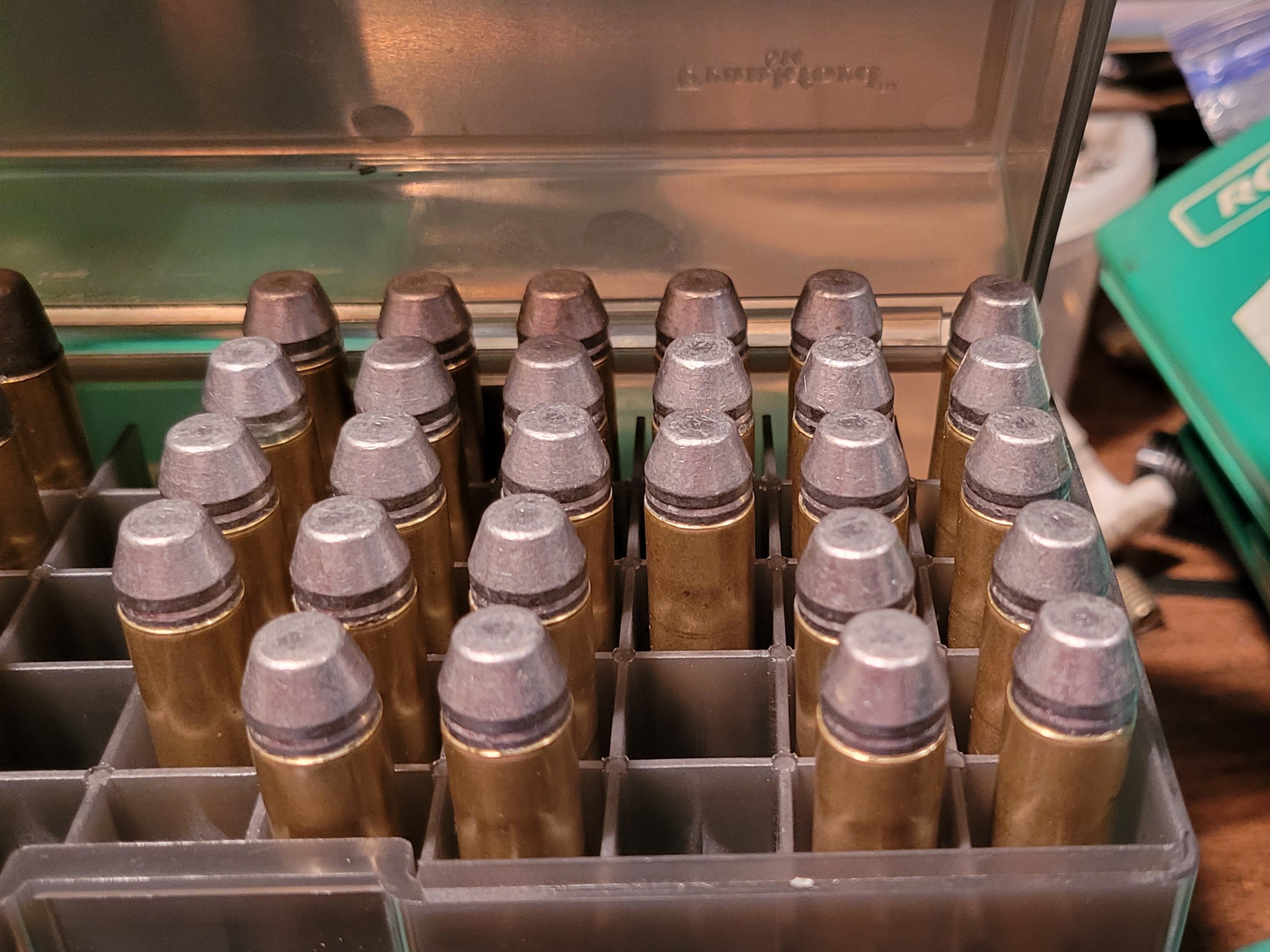

    2nd Range Trip 5/13
    So I got back to the range today with the trapdoor only this time the majority of the rounds were mine. I'm kind of a perfectionist when I load anything, charges weighed to the granule, cases uniform length, primer pockets and flash holes uniformed. You can see in the box I have them segregated by headstamp. Had both W-W and R-P cases.
    The bullets were 300gr flat noses that came with the rifle. The Hodgon starting load for this bullet and H4198 powder is 30grs with a wad and CCI 200 primers. Used an extremely light crimp with the Lee factory crimp die. They are claimed to be 1390fps at 14,400 cup. Nice and mild on the shoulder and the rifle. Followed that recipe and got these results.

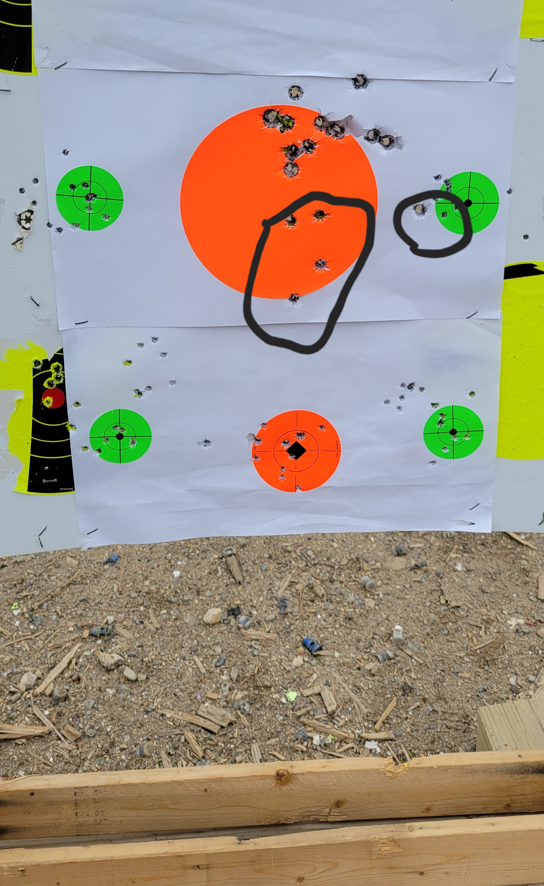

    Still shooting much higher than expected. First shot was a dead center in the dot above when aiming 6 o'clock on the large dot. Moved down to 6 o'clock on the bottom dot and did what you see here. I need to figure out why i pull this rifle to the right so often. 12 shots total of my ammo, it was a rather abbreviated range trip today. I added reference dots for my point of aim.
    The 5 shots in the black circle were the 405gr rounds that came with the rifle. Those are not very precise. Same hold, same point of aim. It did become obvious to me by using those rounds that the rear sight did drop some with the correct middle band relieved for the Buffington sight. I'll just shoot those rounds with no hope of good grouping just to empty the cases so I can load them myself.

    Different profile of bullet than I ever used but your groups look fine. At least on the right road.
