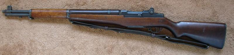

    I don’t know very much about the complexity of collecting these guns.
    David

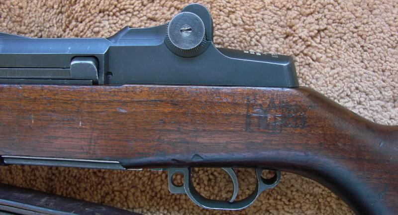

    SA EMcF rifle
    I have a SA 1.5 million rifle too, also with the SA EMcF cartouche, barrel is SA 4-43. Some of the additional parts are:
    bolt -12SA heat lot S04<>
    op rod rev 6 SA
    trigger housing -12SA, trigger guard milled
    hammer -3SA, safety -9SA
    Type 2 lock bar

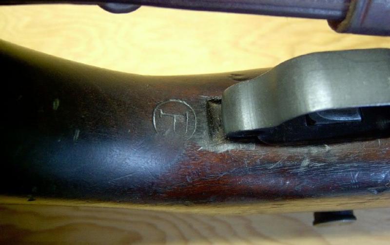

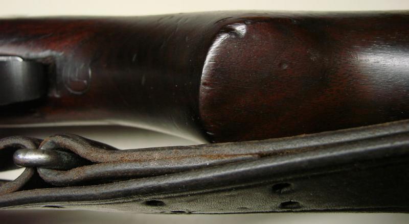

    Question on your SA EMcF stock, do you have the small crossed cannon stamp on the bottom of the pistol grip ? Also on the left side of your stock where the clip latch is inletted, is it a flat bottom or tapered ?

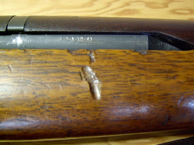

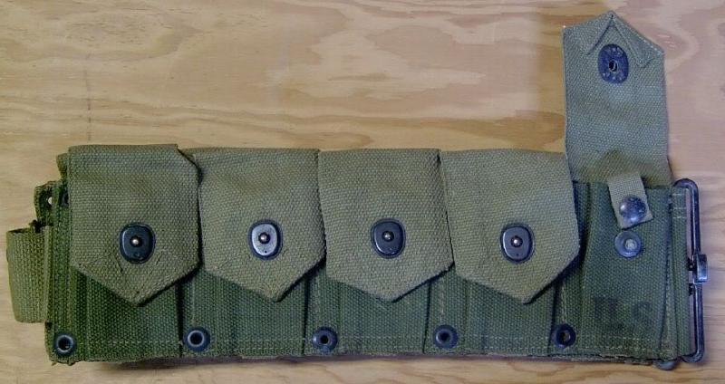

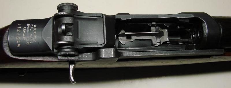

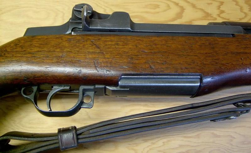

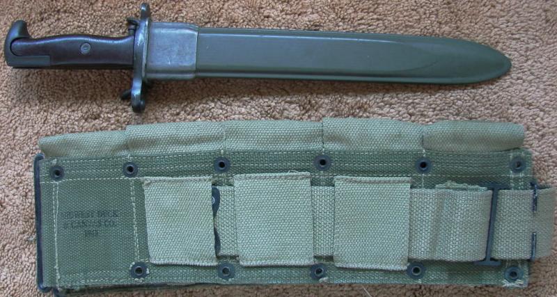

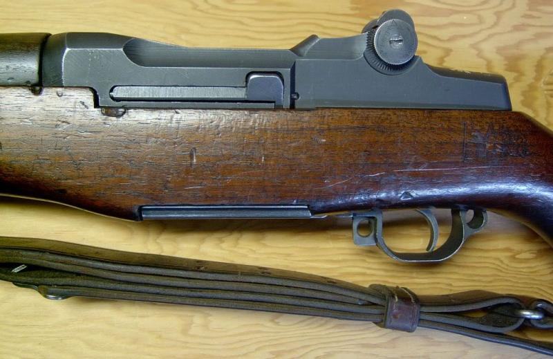

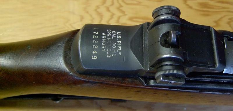

    Thanks for all the comments.
    I will take the gun out of the safe to have a closer look at it.
    I have attached some additional photos that were taken when I bought it.

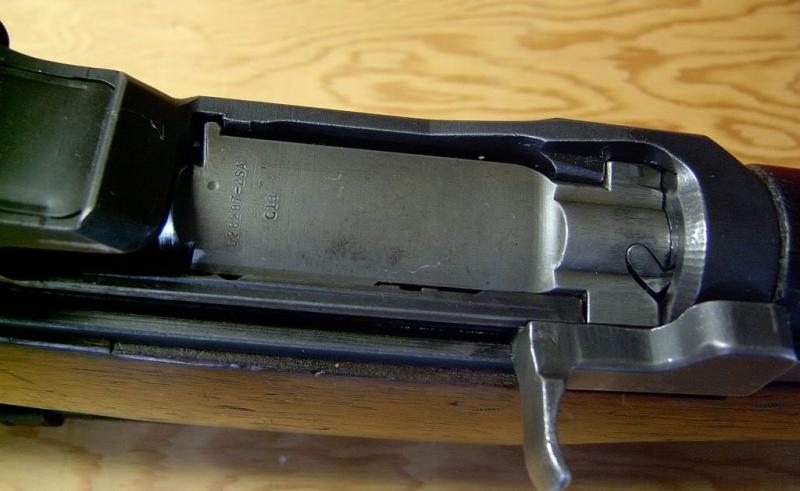

    I don't believe the bolt # is correct for a gun in this serial number range.

    bolt
    Your C13 bolt is late 1940/early 1941

    Thanks RCS,

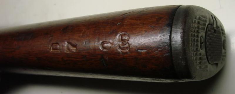

    No crossed cannons escutcheon on the bottom of the pistol grip that I can see.
    (Click on images to enlarge them.)
    A rack number on the stock?

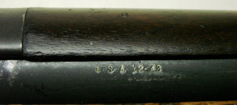

    Is 1-S-A-12-43 correct for a EMcF inspected, 1722249 serial numbered gun?
    I guess it is time that I start to find out what this gun is all about!
    (For the positive or the negative.)
    Thanks for your help.....any thoughts are appreciated.
