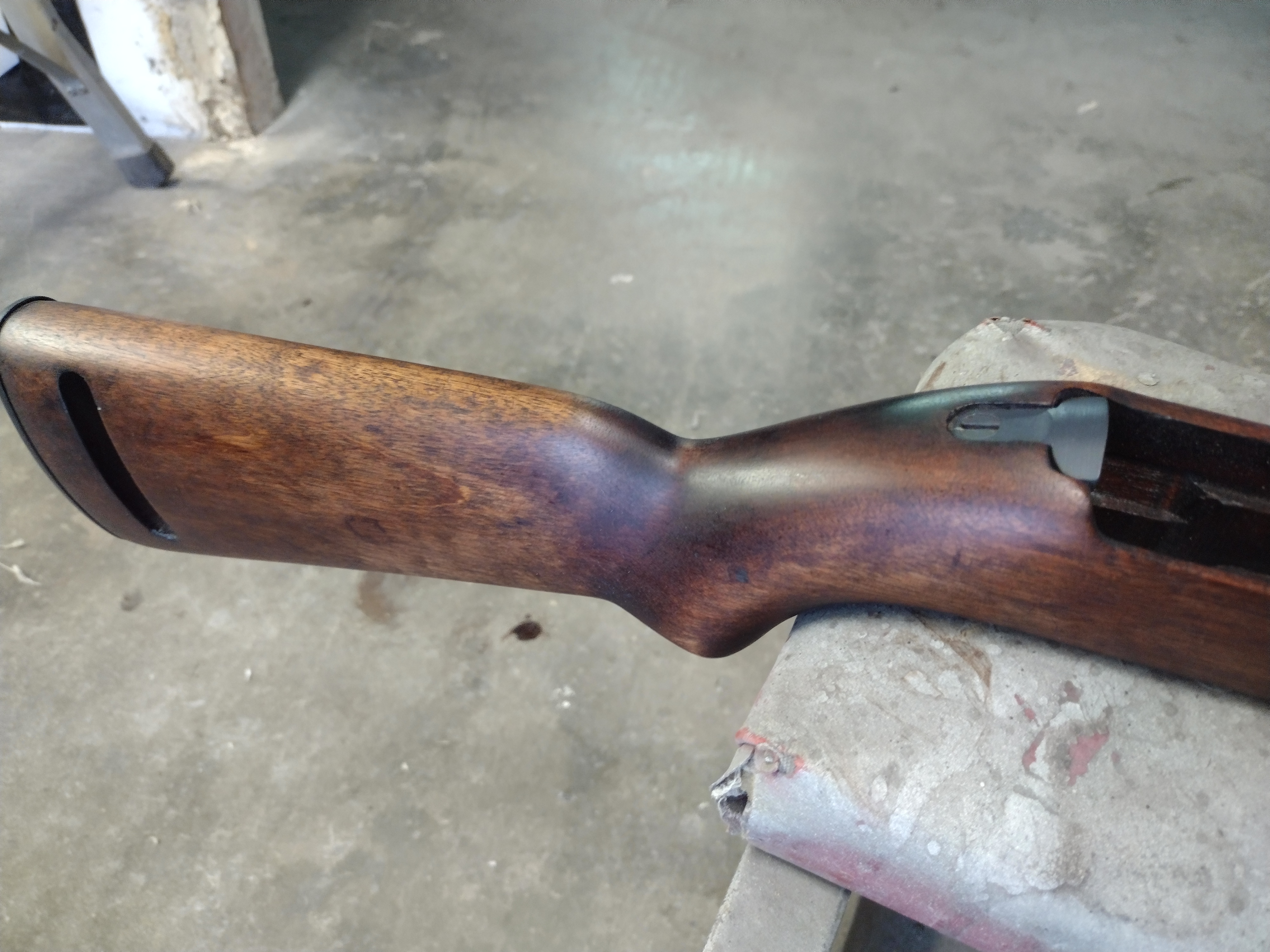

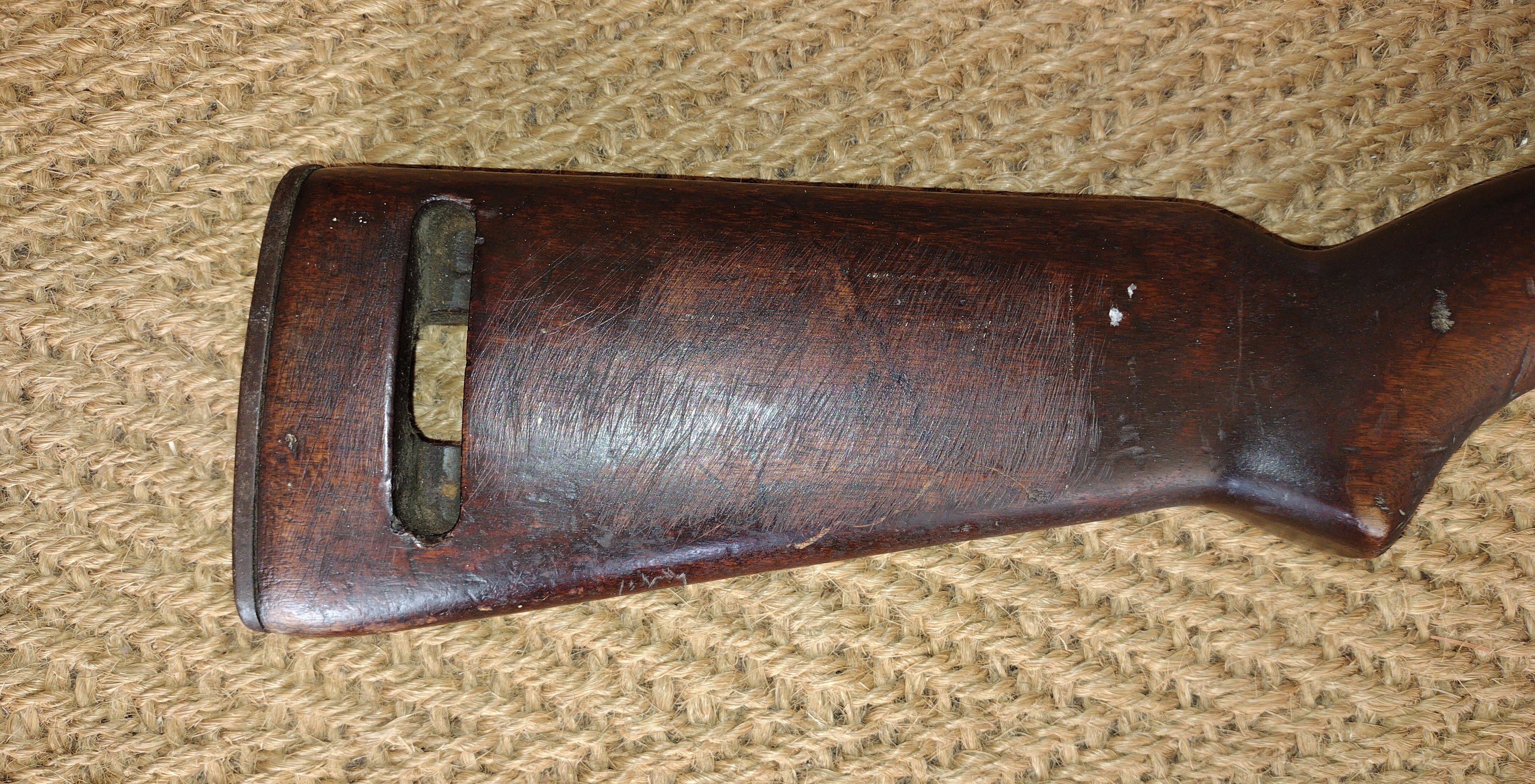

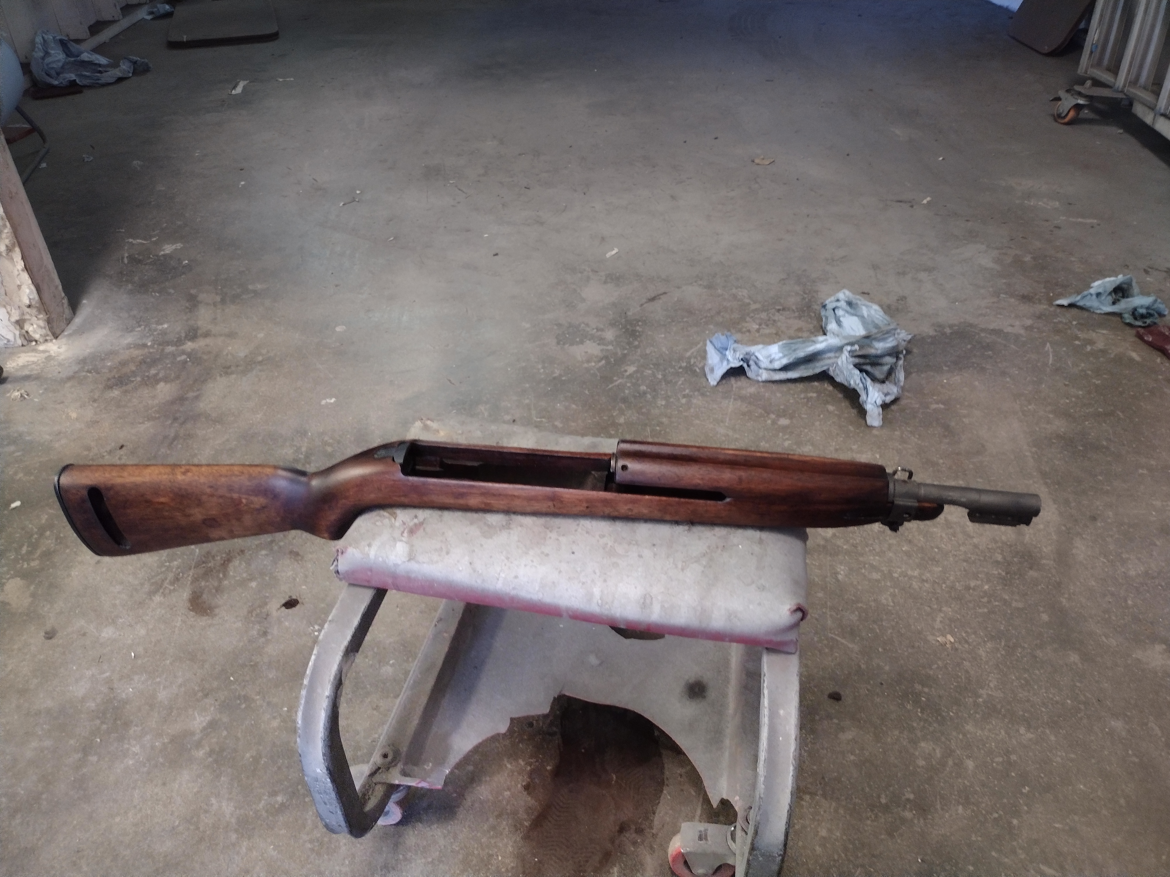

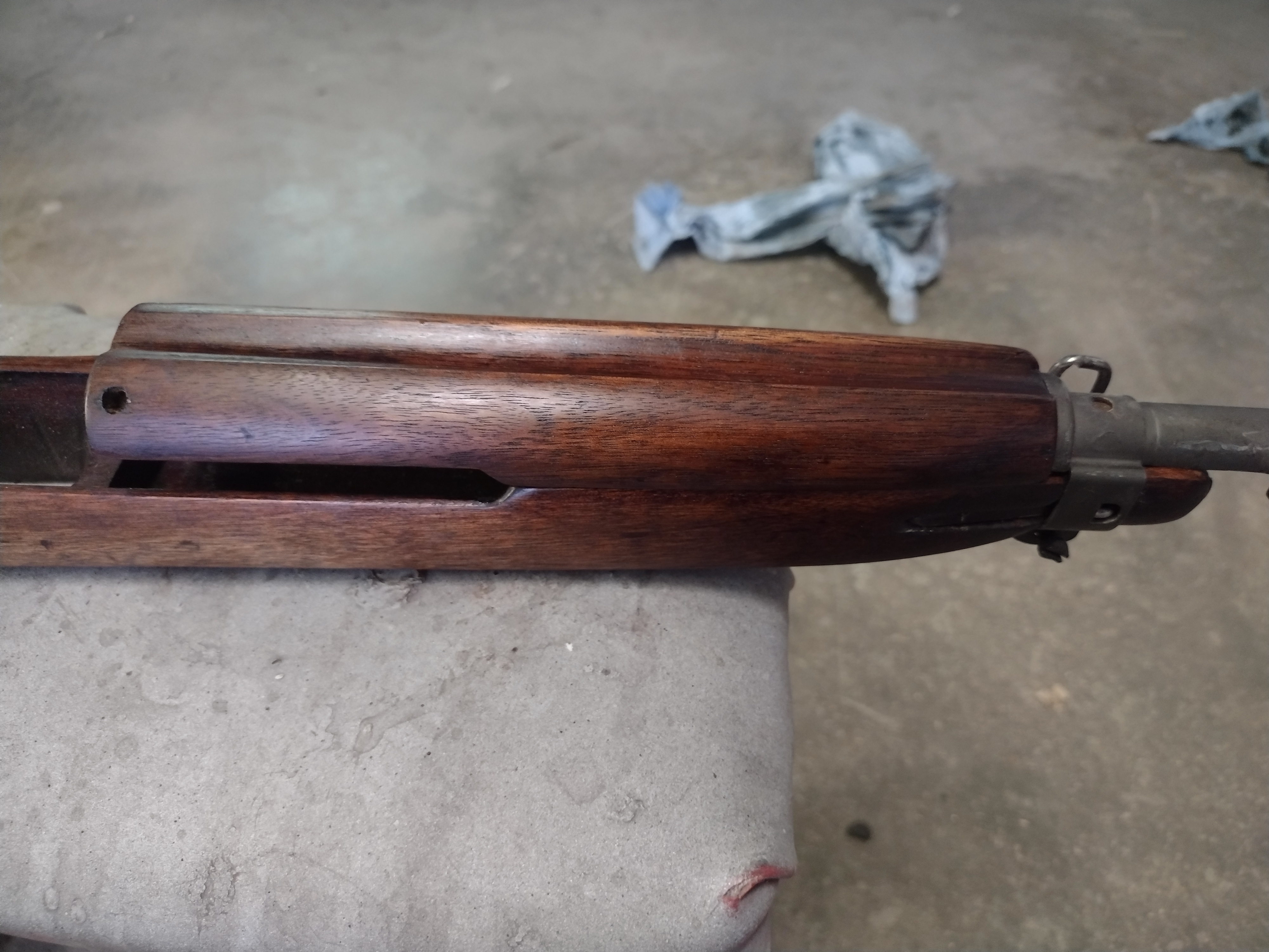

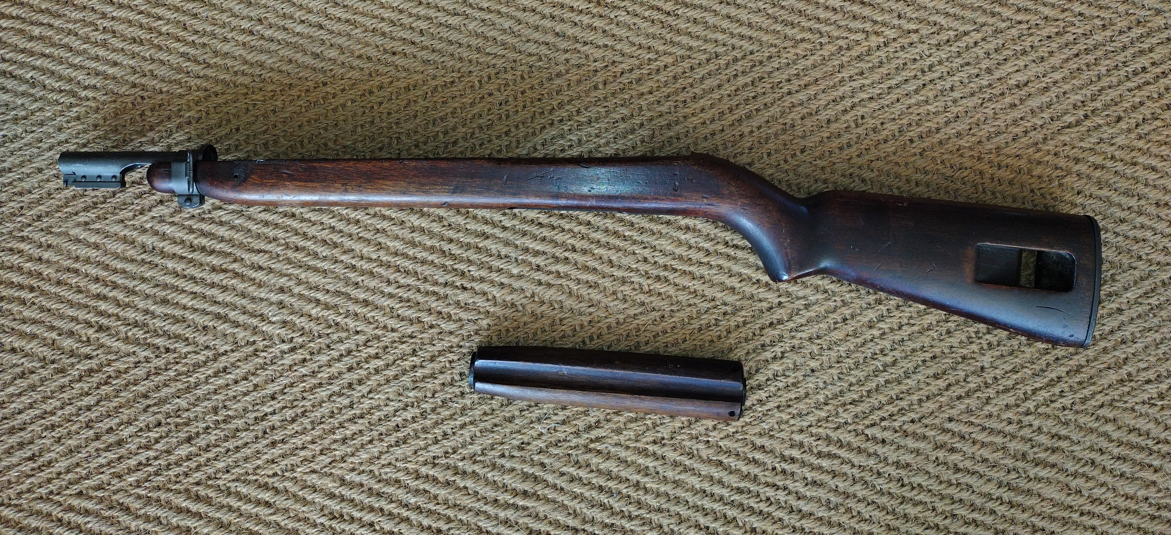

    M1 Carbine woodwork
    I've been looking for a type two stock set for my M1A1icon carbine for a while now, they rarely come along here in the UKicon with virtually all woodwork available Type 3 ( M2 cut) pot belly.
    Having restored an M2 set a while ago, I luckily came across a very reasonably priced Type2 and two rivet handguard, both 'rather rough' and apparently unused. Covered in light dents and scratches all over.
    HR Irwin (replacement) stock with no P or Cartouche makings and a RMC (Rock Ola) two rivet top cover.
    I initially assumed the stock was Walnut, but it had been coated with a thick storage grease that had gone rock hard.
    Having stripped, steamed and sanded the stock I came to the conclusion that the wood was Birch, so started dyeing the stock to match the Walnut two rivet top cover.
    So far, 7 coats of raw linseed oilicon and she's coming up nicely.
