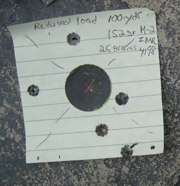

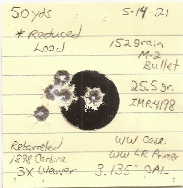

    I have about 10 boxes of 152 grain M-2 projectiles made by Frankford Arsenal in 1947. My Kragicon rifles and carbines shoot them well in my reloads.
    Bullet diameter seems to run .3085" to .309".
