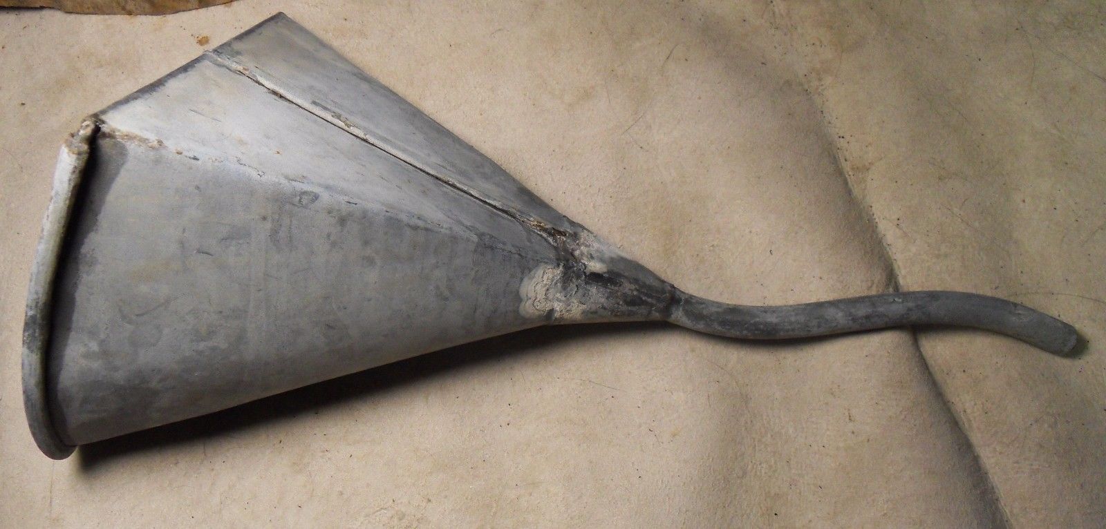

    If you are worried about chemical corrosion (such as from merciurail primers) just do what the military did :
ID:	129179   Click image for larger version
Name:	Funnel In use.jpg‎

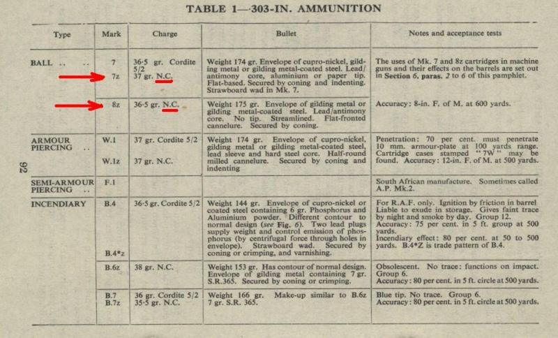

    The accuracy deterioration using cordite and then NC does seem extreme. It indicates that 'all' LE rifles having fired cordite are now inaccurate, as cordite rounds aren't around any more?
    I think that is probably true for the well-used barrels with 'cordite erosion' half way up the barrel, but there are still a good number of 'lightly used' LE's about
    By the late 40s I think that Cordite was well on its 'way-out' and MKVIIZ had been introduced. Cordite rounds finally ceased production in the UKicon in the early 60s.
Name:	Mk7 M8 ammunition.jpg‎
