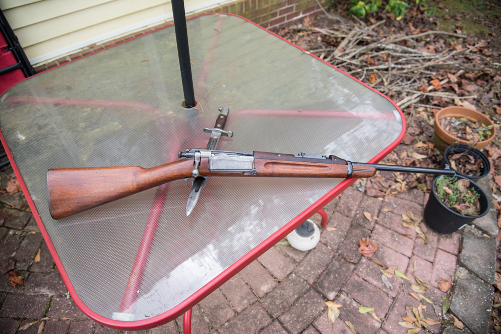

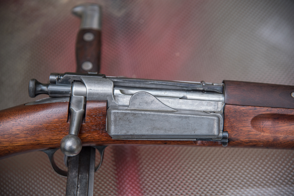

    I have an 1899 Kragicon Carbine that I'm restoring. I am through with it, but for one thing. Previously, it had an ugly bluing job applied to the receiver, which was left in-the-white at the factory. Although the bluing didn't look all that bad, it wasn't the original finish, and that's what I'm after. I have chemically removed the bluing (no polishing at all) and it looks much better. However, I'm now left with metal that has no patina, or age on it. My other Krag receivers are more of a grey-color. I know there is no way to replicate the aged look exactly, I've heard that vinegar and salt can be used to achieve an aged-look, but I don't want to try it on a valuable firearm without getting some more info on this approach. Have any of you done this? Or, is a method other than the vinegar and salt method better? Here is a before and after close-up of the receiver, and an overall pic of the rifle after my restoration. Thanks for any help you might give.

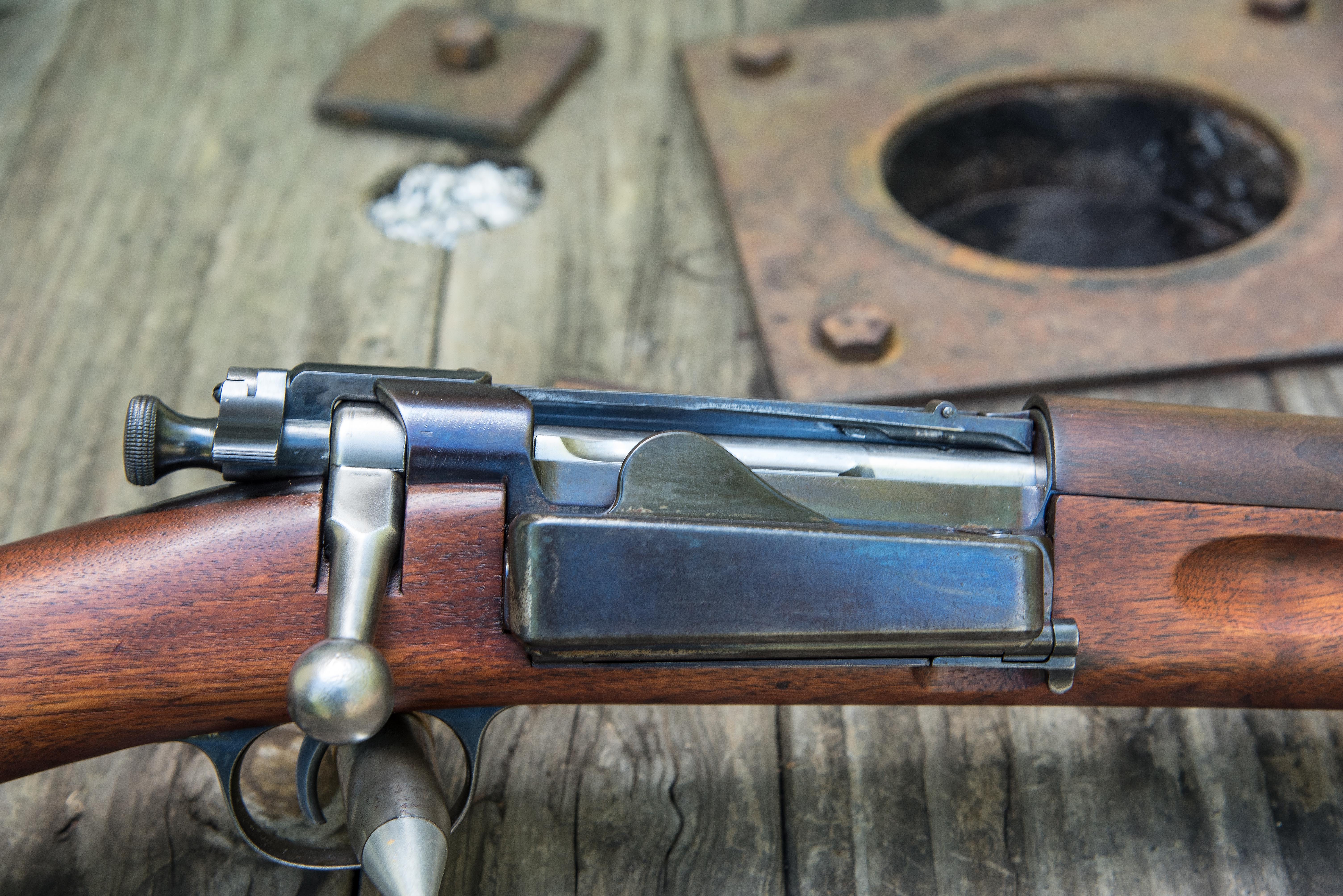

    I assume your middle picture is before? and the 1st/3rd are after you stripped off the original finish? If so I think you'll be pleased with the results of a couple, very light applications. You can really control the outcome very well with Mark Lee's #1, much more so than other solutions. Heavy initial coats will produce deeper/darker results in the end. The final lighter coats just evens it out. So use light applications if you want a slightly worn, "vintage" look.

    Well, like I said, the receiver had some cheap, improperly applied bluing applied to it when I got it. So, stripping that off did not cause any harm as I can tell. Case hardened metal, of that age, usually has a dark grey finish. That is what I am trying to replicate. Only the bolt body has been polished in any way. The extractor still has the fire blue.

    Thanks. This rifle is put-together with donor pieces from all over. This is a cut-down rifle stock.

    The "before picture" shows an aftermarket Buehler safety-lever. Was this action drilled & tapped for a scope at one time?
    Good catch! That is one of the things that I fixed on this restoration. It has not been drilled and tapped. Someone, somewhere along the line had a Buehler lever they weren't using, and it went on here. This rifle has been thru a lot of hands, each trying to "improve" it. I suppose I am too, but my improvements tend more toward the "restoring to original look."

    Yes the metal will grey as the finish wears however its never complete there are always some of the darker blue spots that remain. When worn I've observed that it still retains a slighty mottled look as opposed to a uniform grey.
    There are no-drill scope mounts for Kragicon rifles available. If there were 2 slots cut into the stock at the top on either side of the receiver ring it might have had one of those installed hence the reason for the Buehler.

    Photos can deceive, but there still seems to be a bit of color in your Kragicon's receiver and magazine-gate. You can probably just leave things as they are.
    To my eye, the finish on the barrel-band and darkness of the handguard are more distracting to the overall appearance. Still, a nice carbine to use and enjoy.
