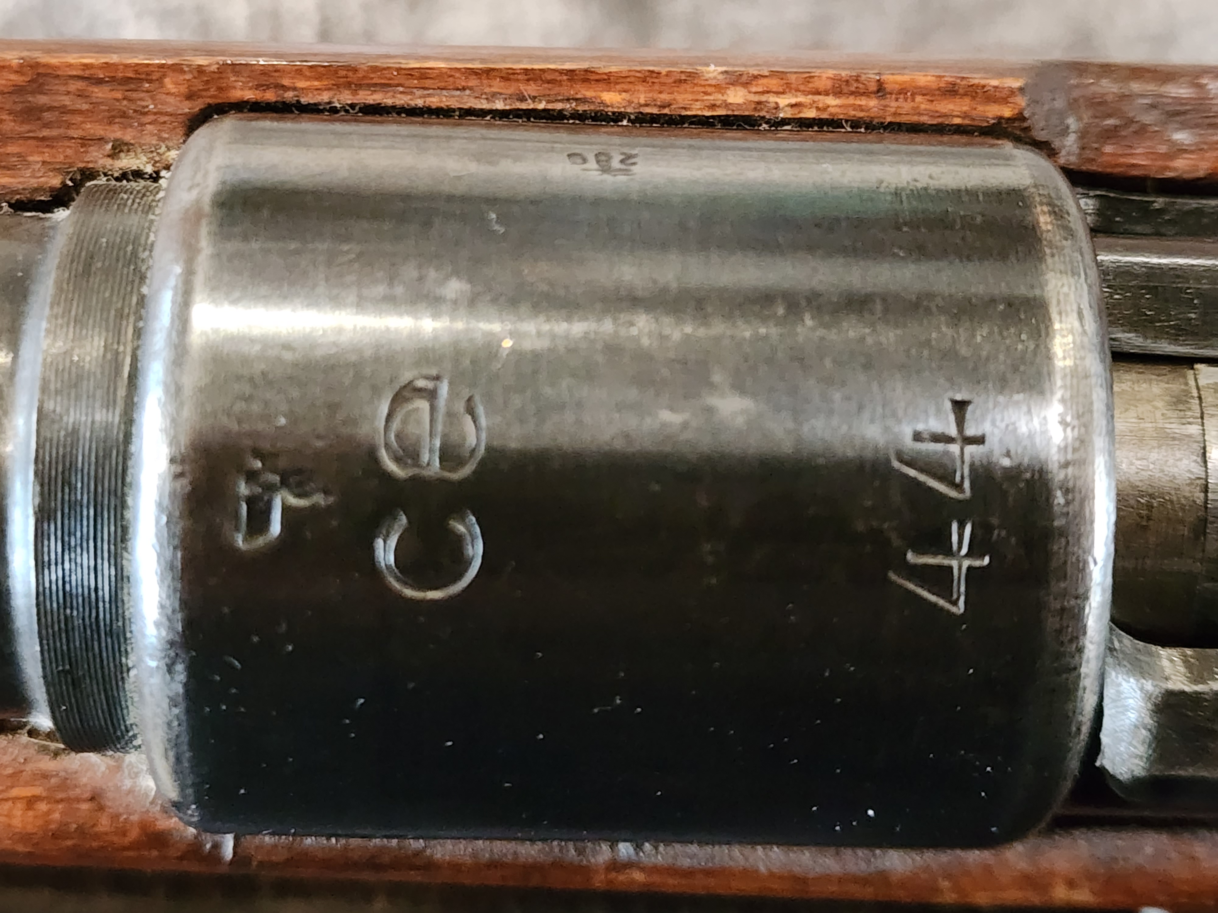

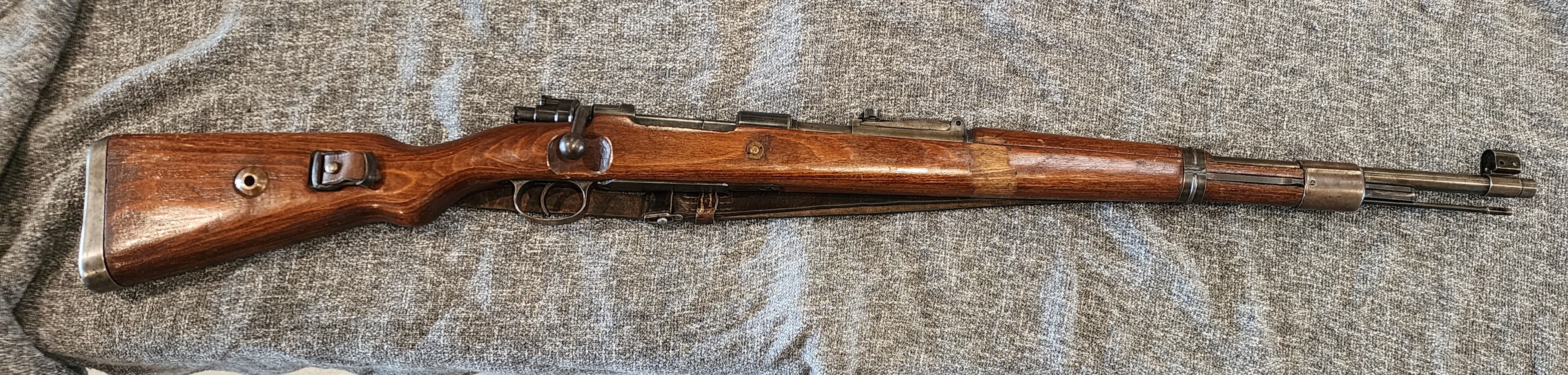

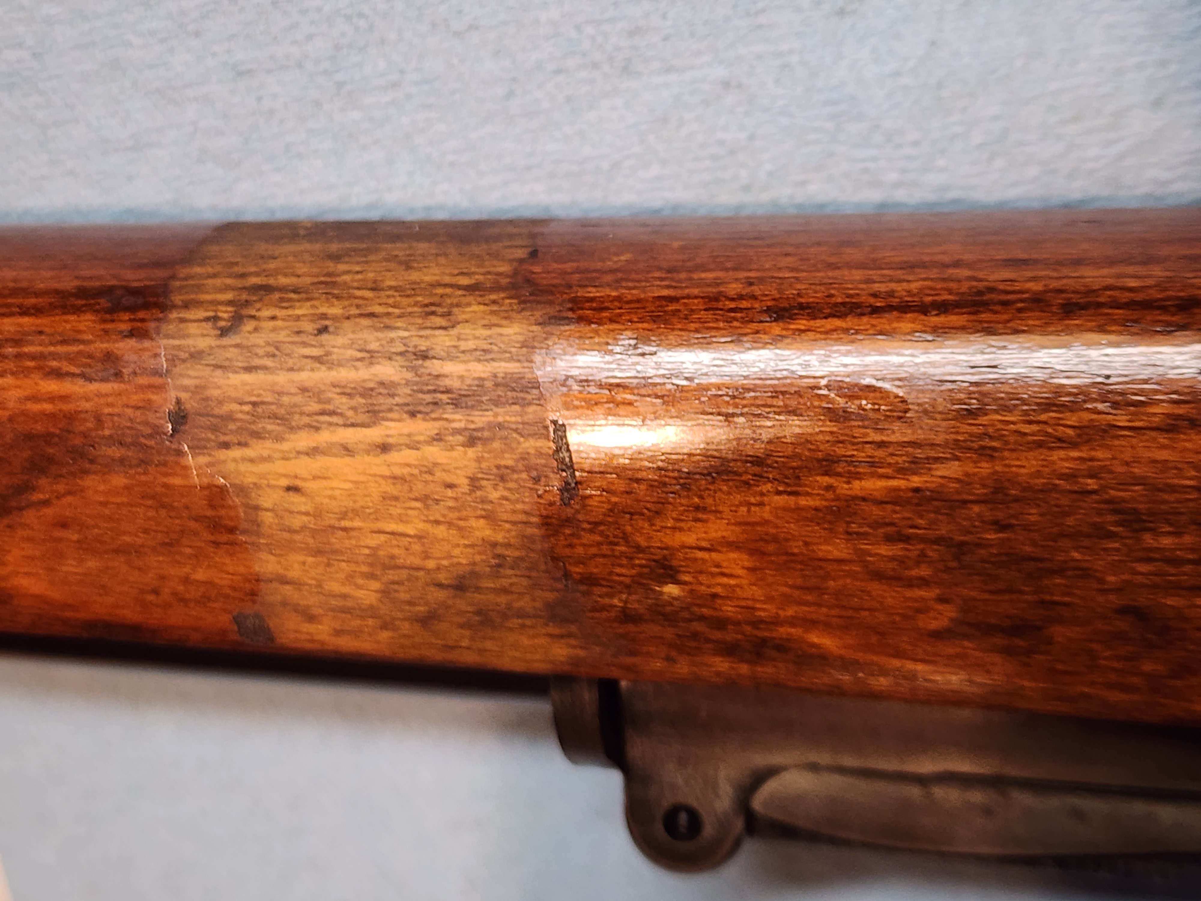

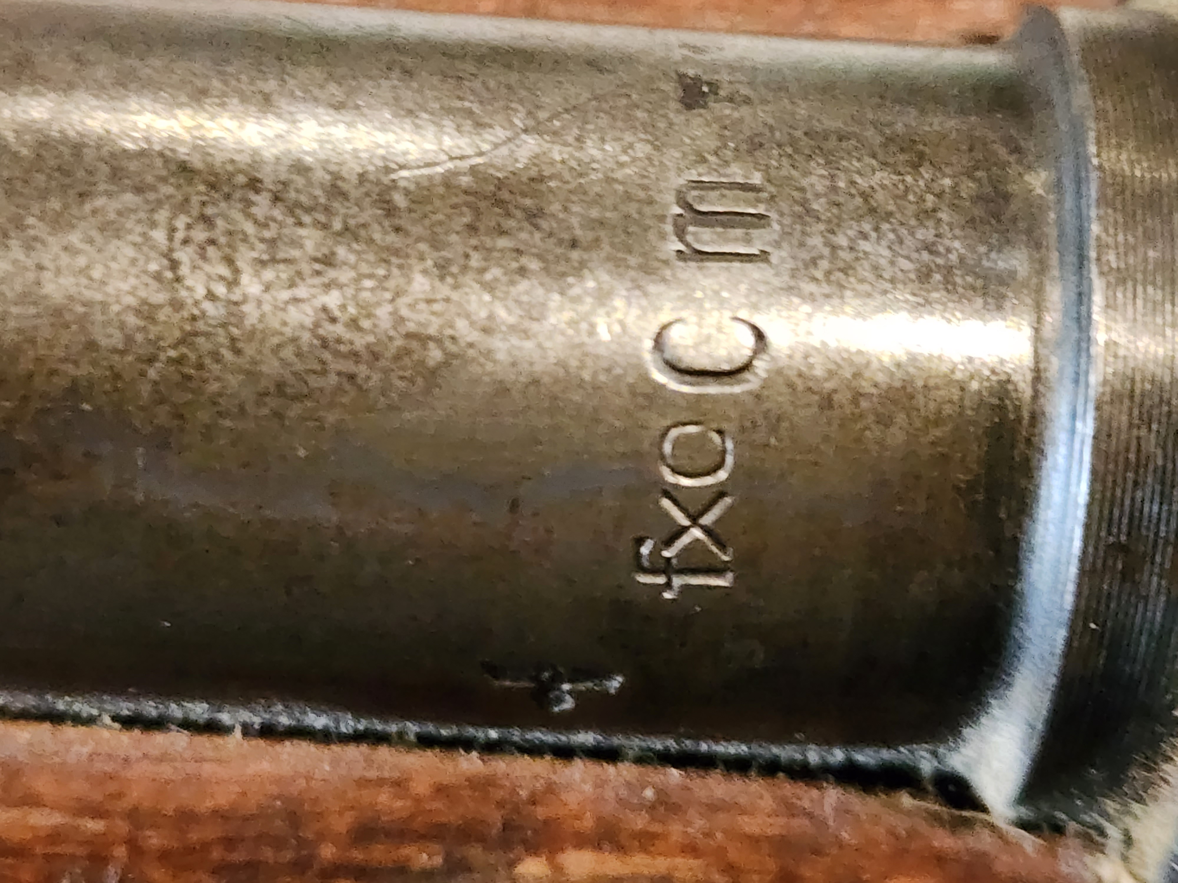

    I am in the process of cleaning and conserving a CE44 Kar98kicon for a friend who just acquired it from a private collection. Upon first review, it appeared to be all numbers matching and may have an original sling (I was hoping someone cold confirm that since I know nothing about slings). The rifle has been sitting in rack for many years and the sides of the rack have worn away part of the finish on the stock (see photo).

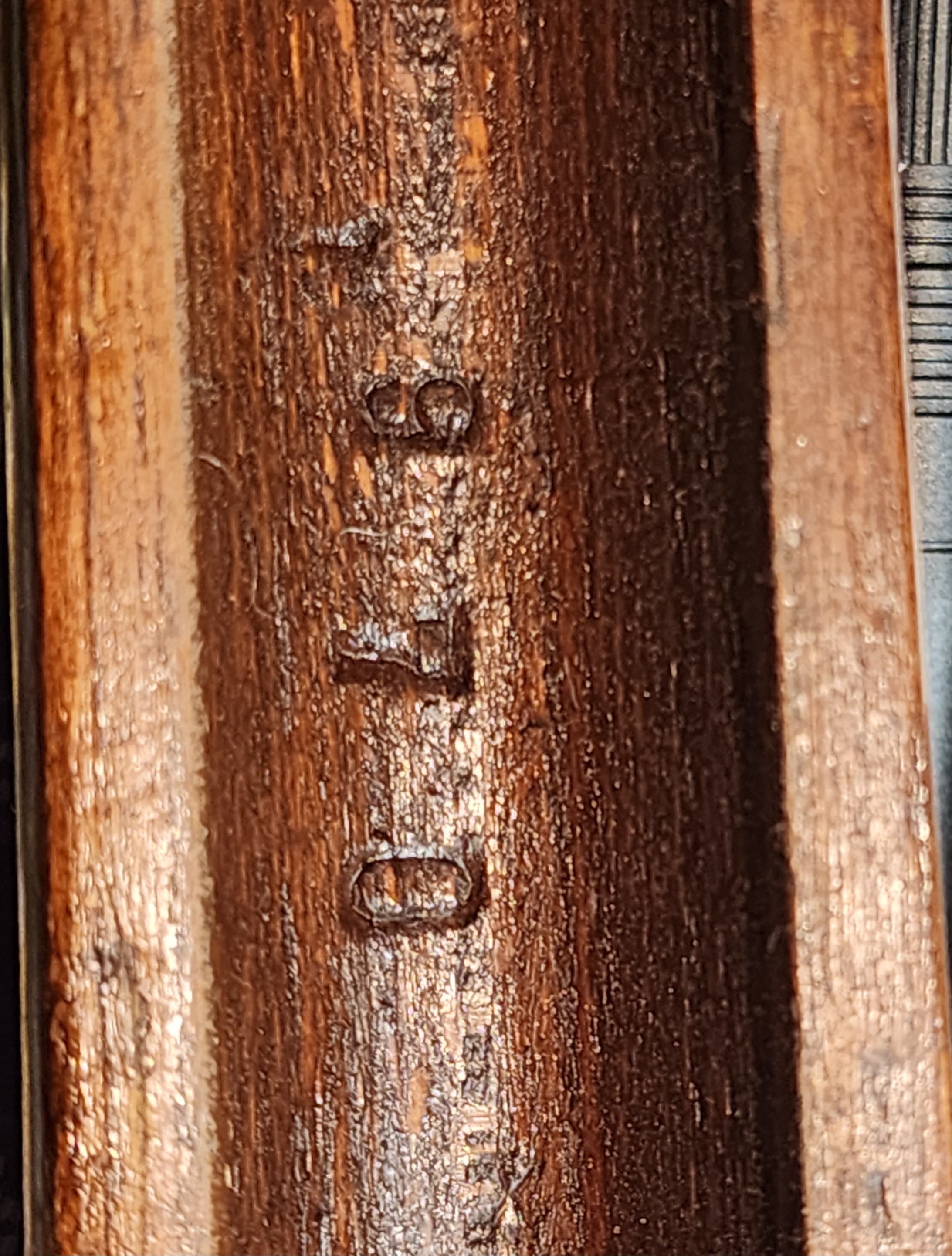

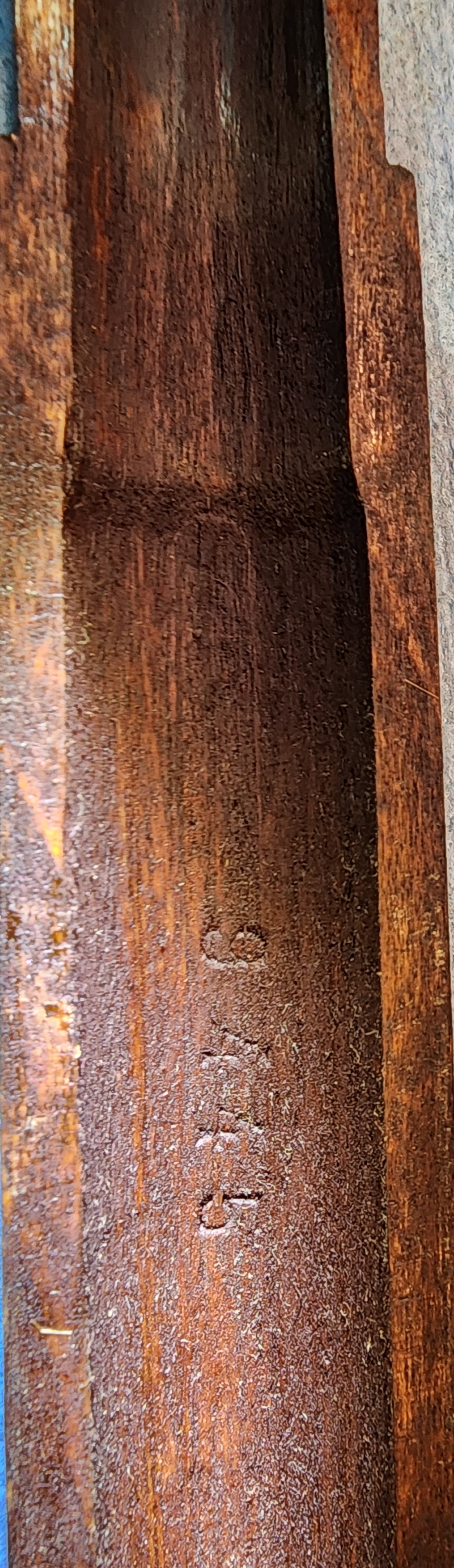

    All of the visible numbers matched. Once the rifle was dismantled, all of the numbers inside matched except for the number located on the inside of the front (small) wooden handguard. Everything shows "970" or "70" except this handguard which has "9445" stamped in it. Should this part be numbered "970" also?
    How can I determine if the sling is original (I included a photo of the buckle)? Can anyone provide a recommendation to repair the damaged finish on the stock?

    I have no plan to strip the stock since the rest of the gun is in such great original condition. I'm just hoping to restore that "worn" area and blend it back in with the original finish.

    That doesn't look like rack wear to me.

    The finish on the stock isn't original to my eyes, its looks like some sort of varnish finish, probably applied by the vet after he brought it back to make it look pretty.
    The finish under it, which you are looking at in that 'worn' strip is the original stock finish.
    Looks like the handguard is mismatched going by the photo's of the serial number are matching on one piece in a photo (I'm guessing the stock?) and doesn't match in the other, which I'm guessing is the handguard??

    It is definitely rack wear. I saw the rifle in the rack and the wear mark corresponds to the rack. The M1Aicon I purchased from the same rack/collection has the same mark corresponding to the rack. I know how to fix the M1A so no problem there.

    Thank you sir! I think you have identified the problem. I compared this stock to the stock on my all-matching original AR41 and you appear to be correct. The key is the firing pin take down disc in the stock. I should have noticed it earlier. There appears to definitely be a coat of some type of varnish on the stock similar to what we see on Russianicon captures. That is why the rack mark exists since it rubbed off the varnish. I will contact the owner and recommend he let me strip the coating and then rehydrate the top layer with raw linseed oilicon. This is why I love this site - you get great information from some very knowledgeable people!
