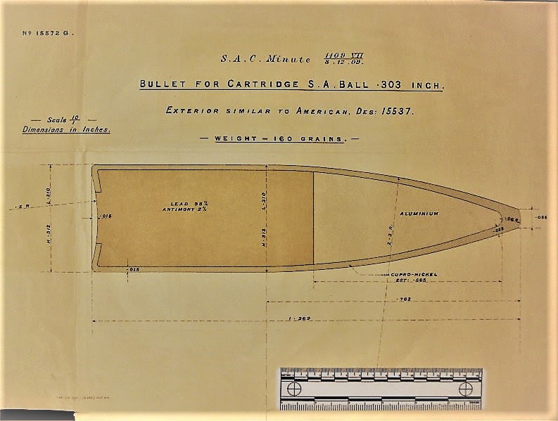

    A friend and I talked along those lines I do have in my MKVI collection rounds from our troops that have carved crude X's in the nose to perhaps aid expansion as the MKVI round was full lead and did not posses the aluminium filler in the nose that the MKVII has. (See pic)
