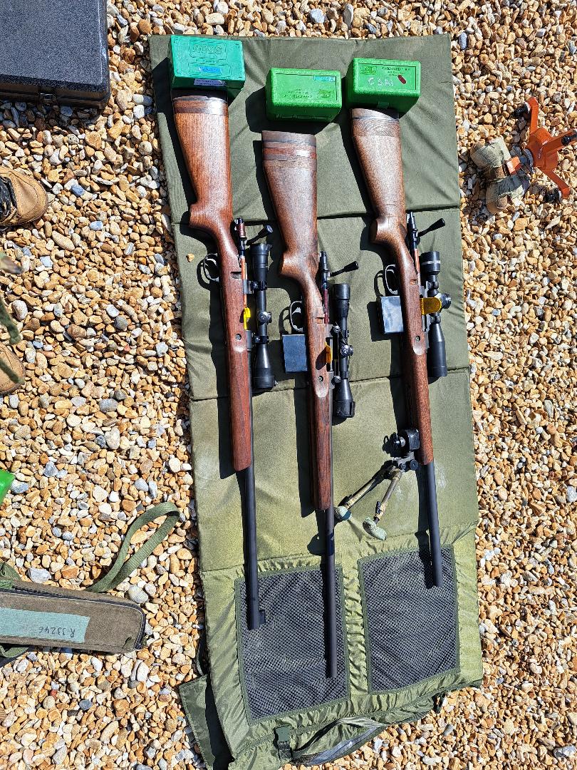

    Thanks for the help, I had it on six clicks on the windage on sunday at 300 mtrs so 3 moa.

    Is the middle rifle an M85 with standard bottom metal?

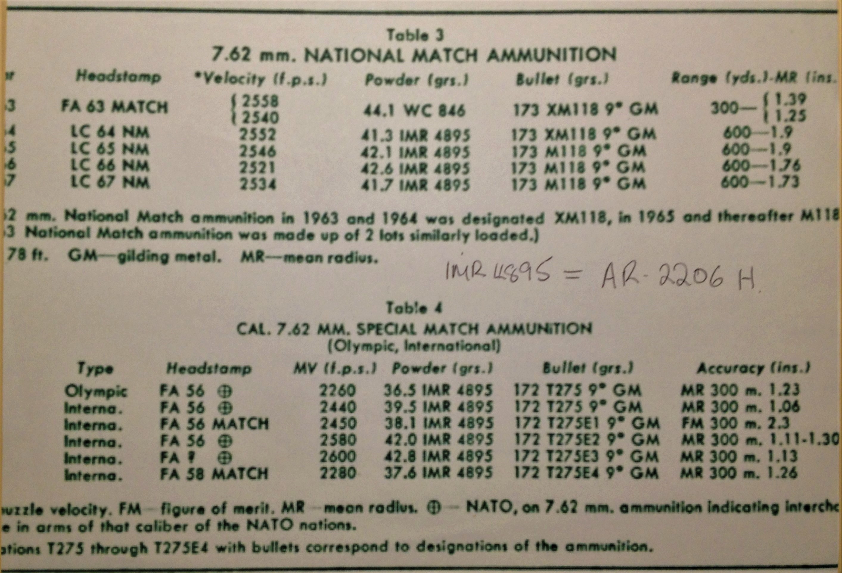

    Some other data if any one is interested in Match loads.
    I have not loaded any of these loads so the usual applies chaps start 5% lower and work up I take no responsibility with the load data

    Lovely set there.

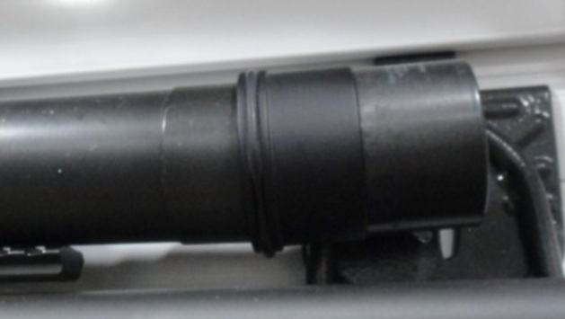

    On the topic of the Unertl 10x, does anyone know if the C3 Scope was threaded for a ARD/Kill-flash?

    Hello Kevin,

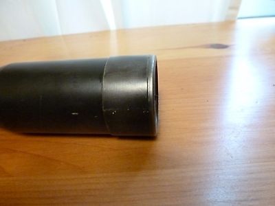

    The C3 Unertl is not threaded to accept a screw on ARD. A special adapter was used to slip over the objective that allowed for an ARD to thread into as depicted below. There is one for auction currently on GB.
