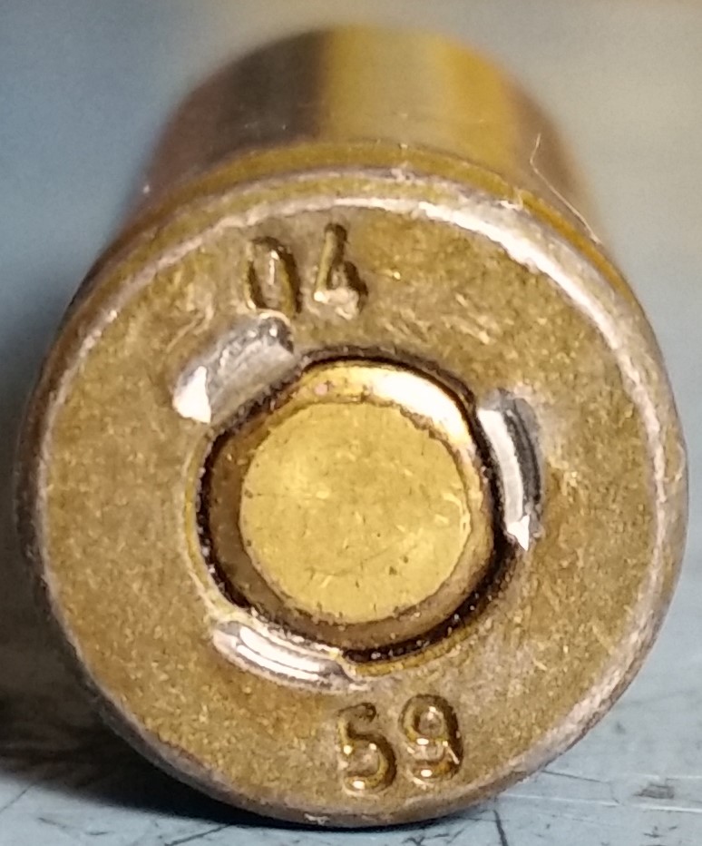

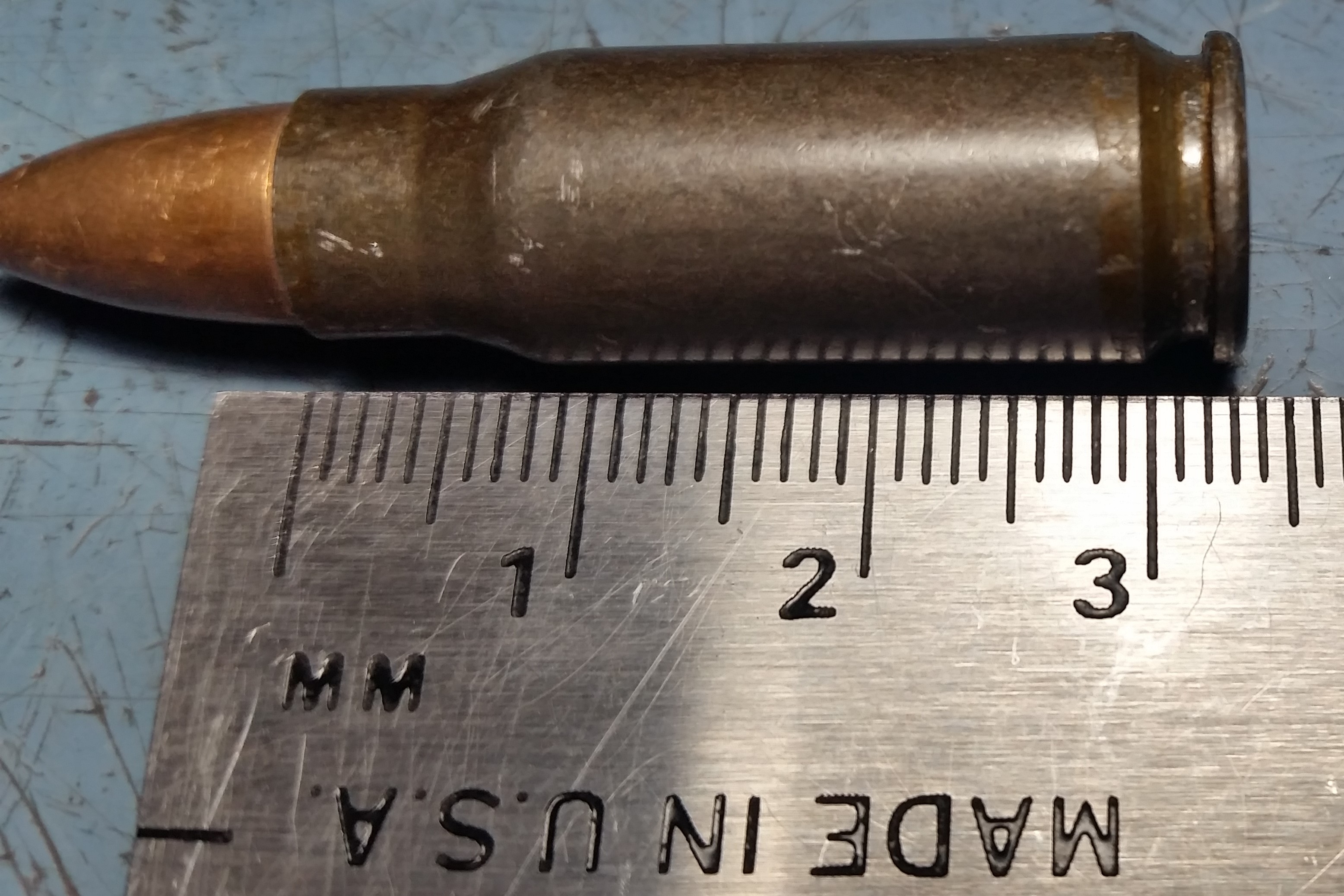

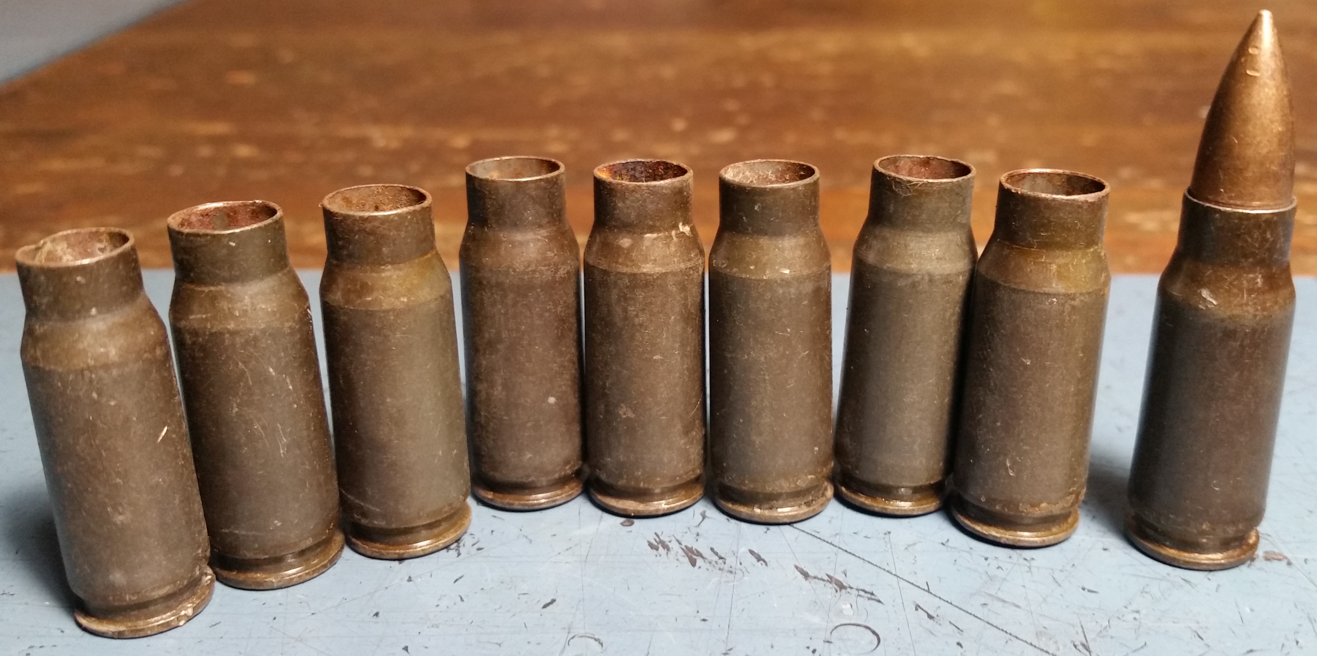

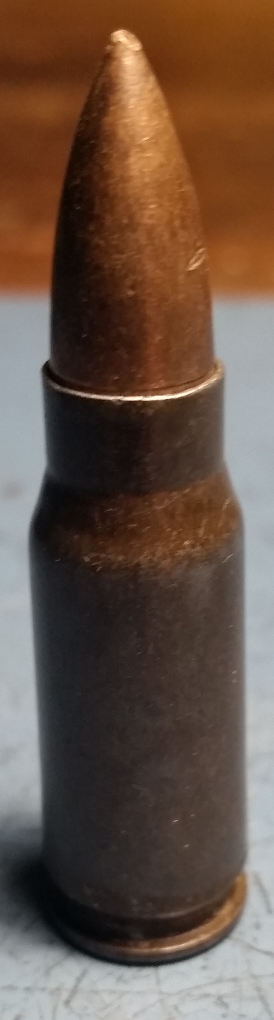

    Out shooting .22 last Friday and I was alone on the range, which is normal here. I happened to look at the ground in front of the firing point and found a loaded cartridge that really shouldn't have been there. Also, nine others, empty. Have a look and tell me what they are? By the way I already gave one empty away to a friend.

    My Pacific Peso's worth: 7.92 x 33 (Kurz).
    Probably East Germanicon, very post WW2 manufacture.
    One of your neighbours is either a true eccentric or owns a VG1 or STG.
    I remember making a whole bunch of brass cases from 7.62 NATO brass, several decades ago. Then there was / is the local bloke who makes full-length 7.92 x 33 BLANKS for his Movie armoury StGs (x2 at last count).

    You are correct sir...in all statements. I found since I had a brand new one in my collection already but the thing is these have been long sequestered in this country. Hard to guess which exact one it is but they have been out going through just a few. This was between last Friday and the week before or I would have found it then. Once before I found a trials cartridge from when the FNs were being tested. That came home too.
    I had the opportunity many years ago to make a batch of 600rds 7.92x33K for a shooter that had an Mp44. I used Federal once fired .308 and sized, cut and inside chamfered...trimmed and loaded them. I guess they worked out just fine. Long time since we've been able to shoot those though. At least pre '98.

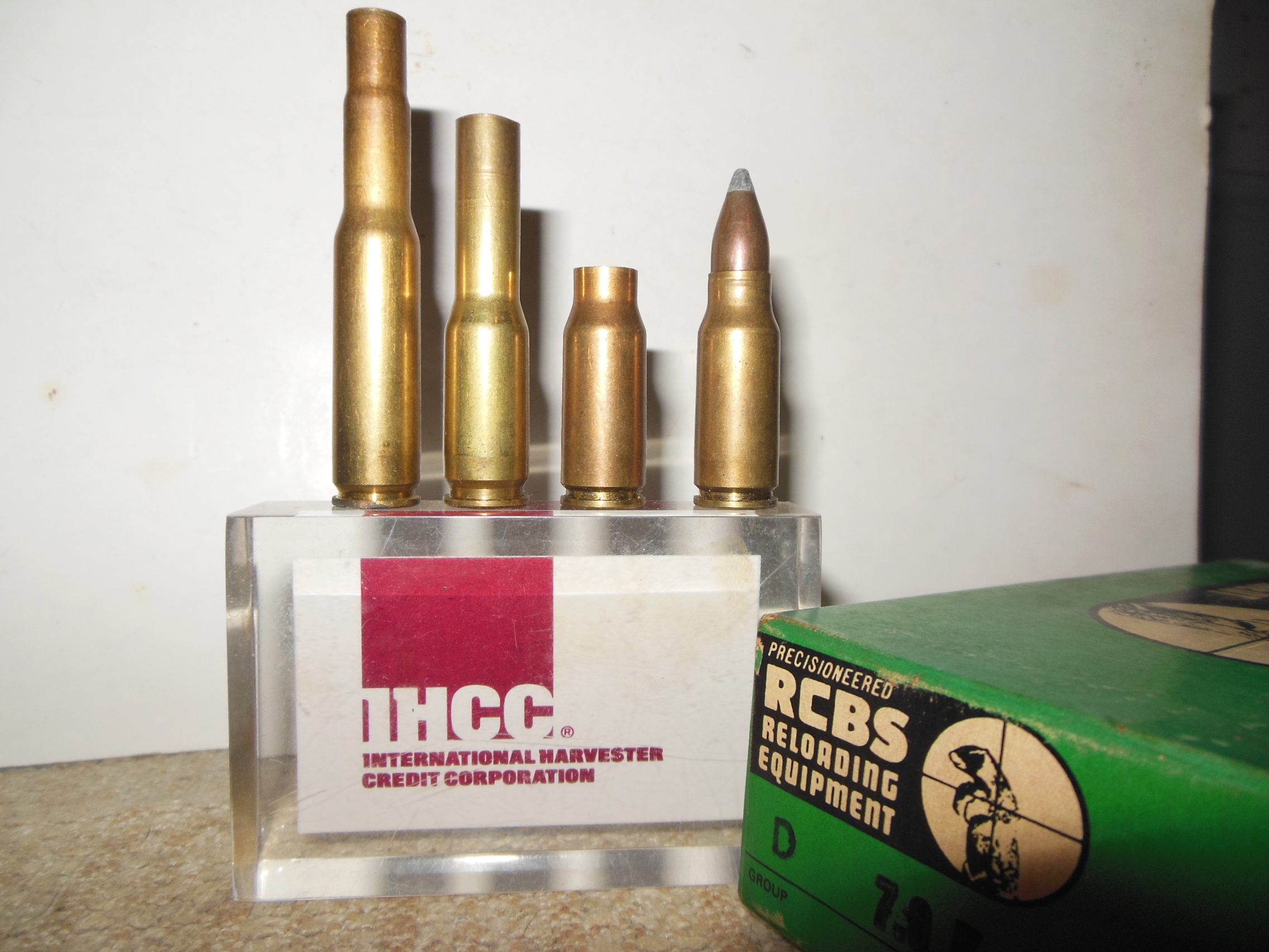

    7,92x33 necked down to 30 caliber
    There was an ill-fated attempt years ago to convert the M1icon carbine to fire the 30 cal Kurz cartridge. Believe it was around the late 60's or early 70's ? Anyway it used a new longer barrel and modified slide, bolt face opened-up too. The 30 Kurz would fit in the carbine magazine using 110 gr bullets.
    Could not generate any following and it was just too unsafe.
    Here is a photo of the 22 K-Hornet next to the 30 Kurz cartridge (supplied Cartridges of the World with my 30 Kurz cartridge photo years ago)

    The scale cartridge is rimless, 22 (K) Hornet is a rimmed case.
    I suspect it is a (Melvin Johnson) MMJ .223 ? Based on .30 Carbine which is in the similar length (33mm) to 7.92 Kurtz.

    Lee Enfield, I did mis-identify the first case, it is the 5,7 Johnson next to the 30 Kurz
