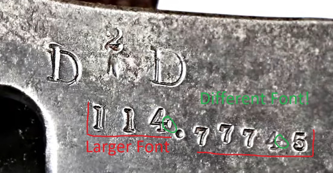

    Oct 2009
    Europe
    1,889
    05:22 PM
    Since I've had some discussions with Ian on the serial number prefixes I'll also upload the two crops that I've done based on the YouTube Video in here. Note that the font size of the prefix is different as well as it uses different fonts for the same letters. On the contrary, the font for the rifle action serial is identical on all of them and fully uniform to any other Britishicon WWI P.14 sniper rifle. In my point of view these therefore would indeed suggest to be Australianicon added numbering prefix, but not for the fact that Australia has set up these rifles, rather than for rebuild and/or inventory.
