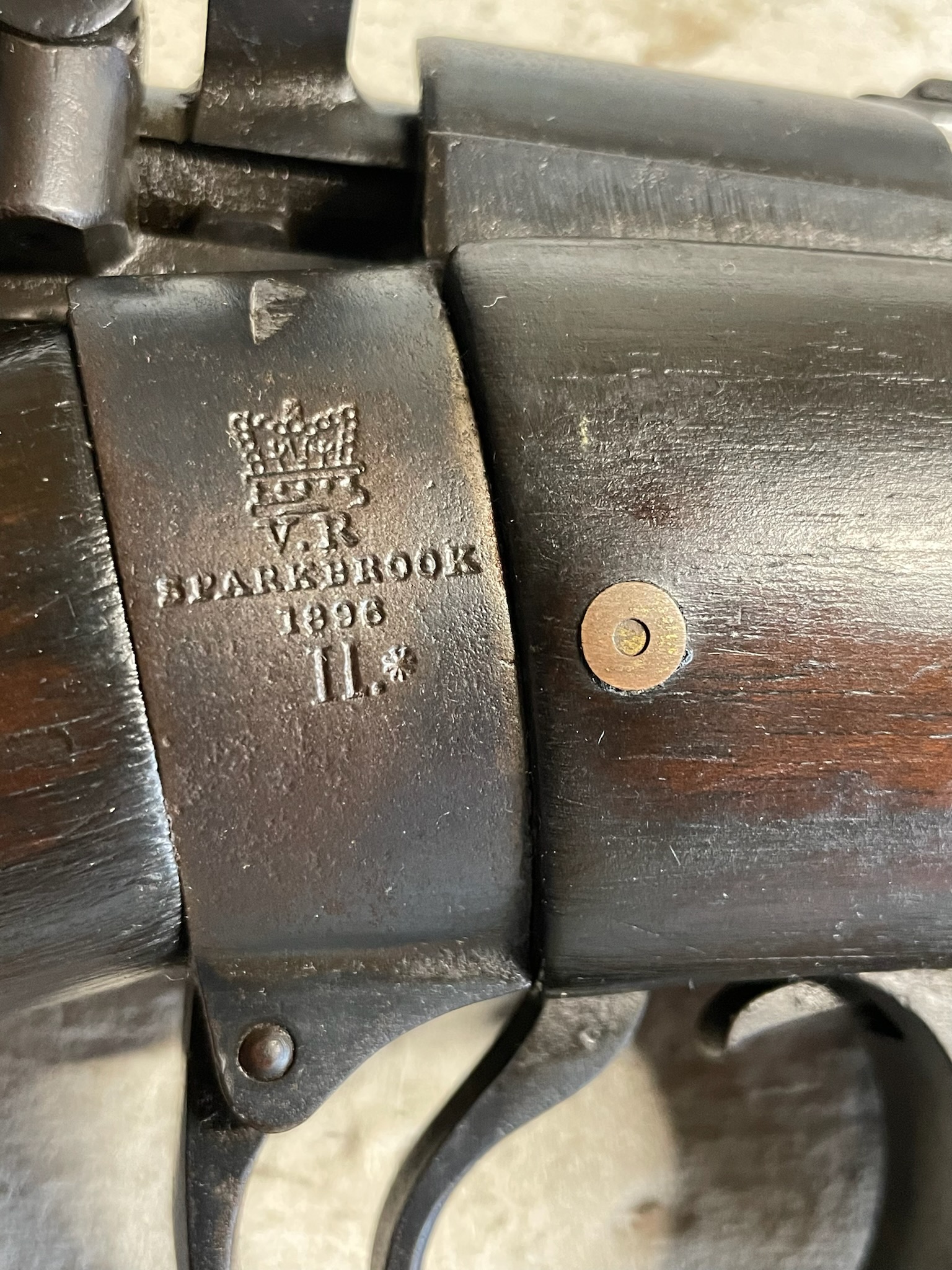

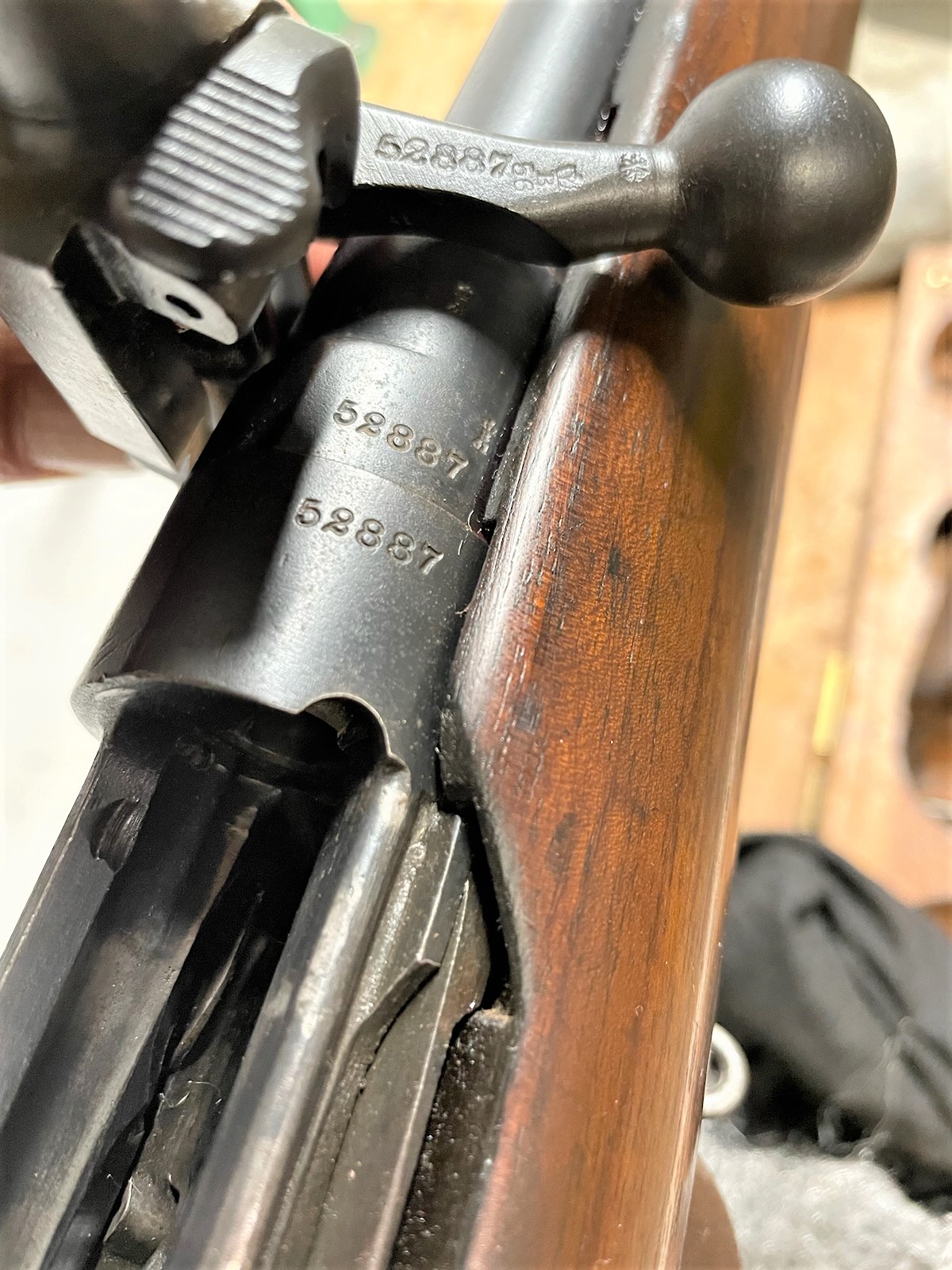

    A matching numbers Sparkbrook MLM Mk II* produced in 1896, and overhauled by the Plymouth Naval Depot in 1913. Heck, even the rear sight still matches!
    Fortunately for me, I have been hoarding a small batch of Long Lee parts. When I pulled the rifle apart, I found something unusual; the buttstock, noscap and forend were numbered to one another, presumably when it was overhauled (?)

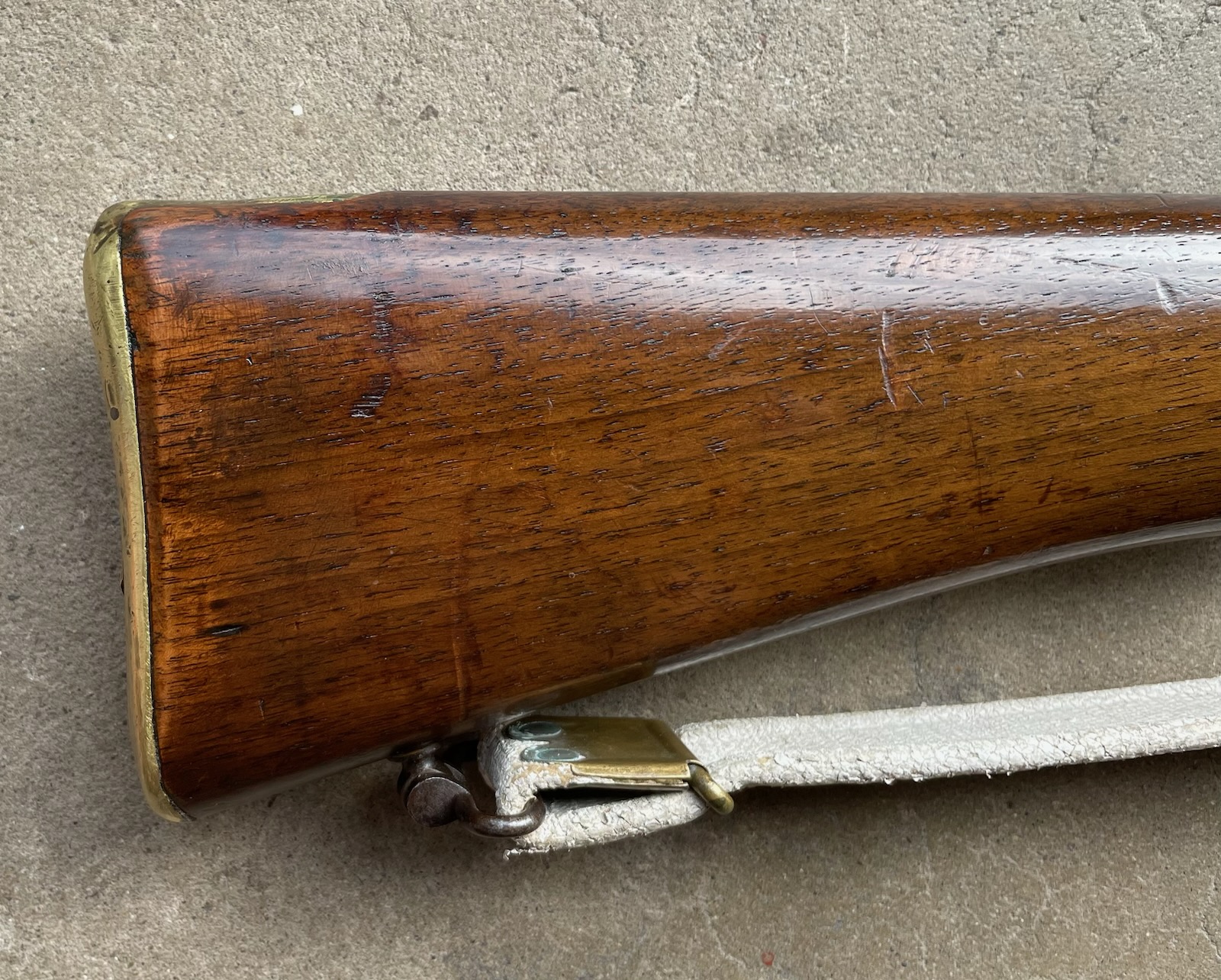

    So with that in mind, I set about fitting a spare brass buttplate to the original stock. I wanted to keep as much of the original pieces as I could. The worst part was, the previous gunsmith had cut the stock off flat to install the recoil pad. Once removed, I spent several hours re-contouring the cut end so it would accept an original buttplate. Once fitted, I had to file down the edges of the plate to match the stock, which also involved removing a small amount of wood. Several coats of stain and RLO got it just about right.

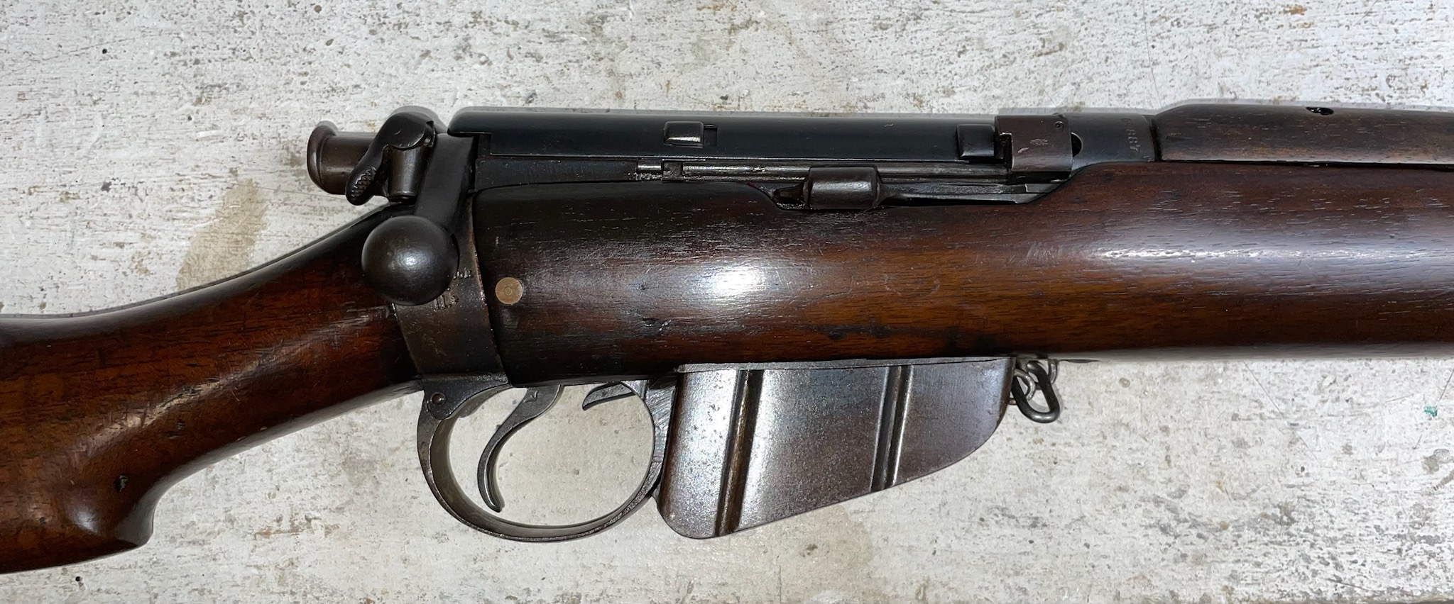

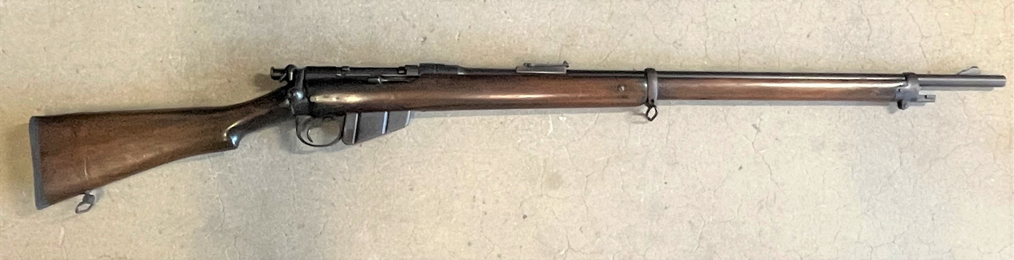

    It had a late war Lithgowicon SMLE magazine installed. This was swapped for the proper chained magazine and trigger guard assembly. I had a genuine Sparkbrook manufactured dust cover I have been hanging onto for at least 10 years. That went on, as did a spare handguard.
    So here it is, before and after:
