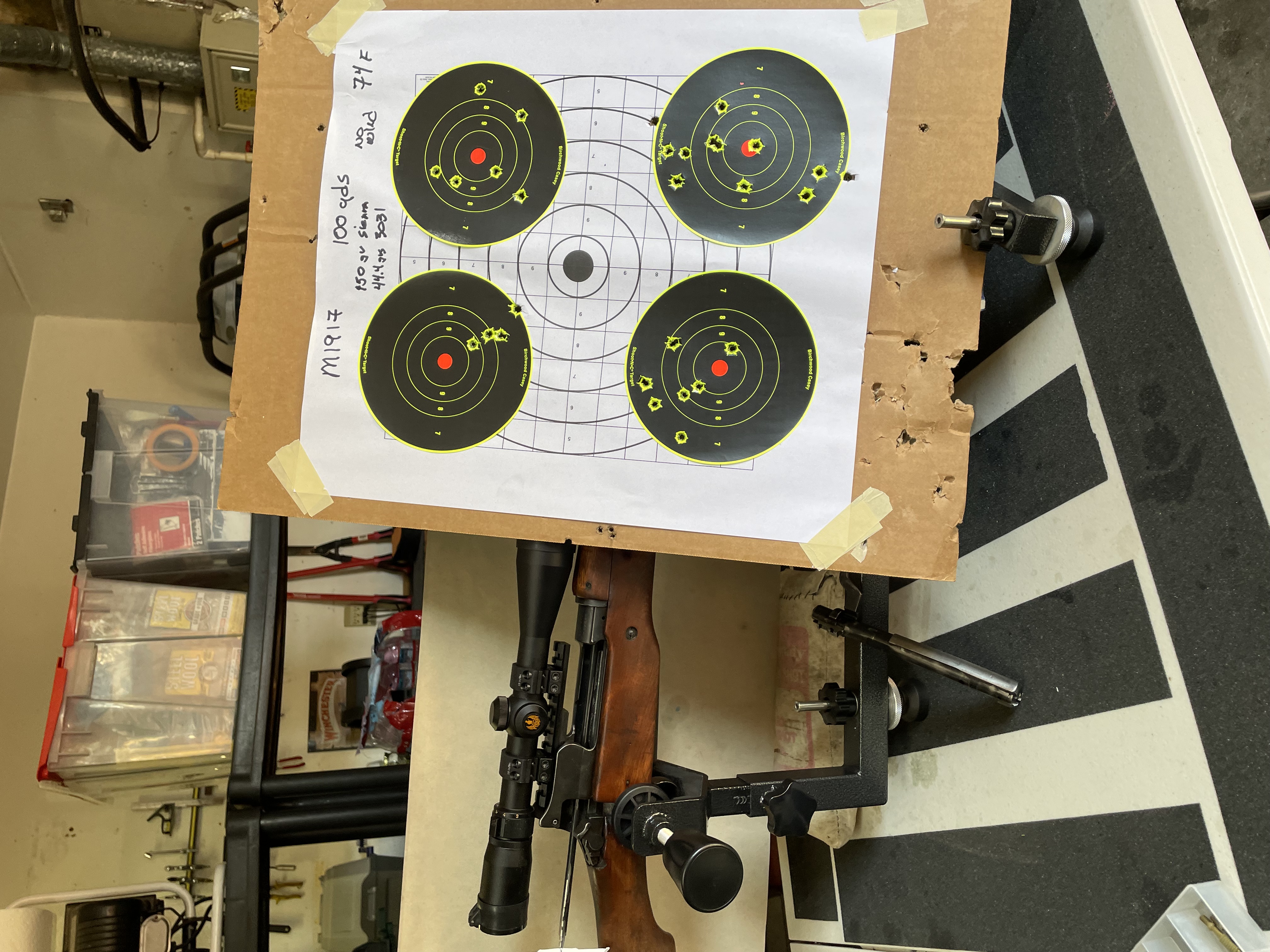

    The trigger is a mess. But I think I can tighten this up some with some work. By no means a tack driver. Yet.
    I have a lot more experience than expertise, still have both eyes and most of my fingers though.

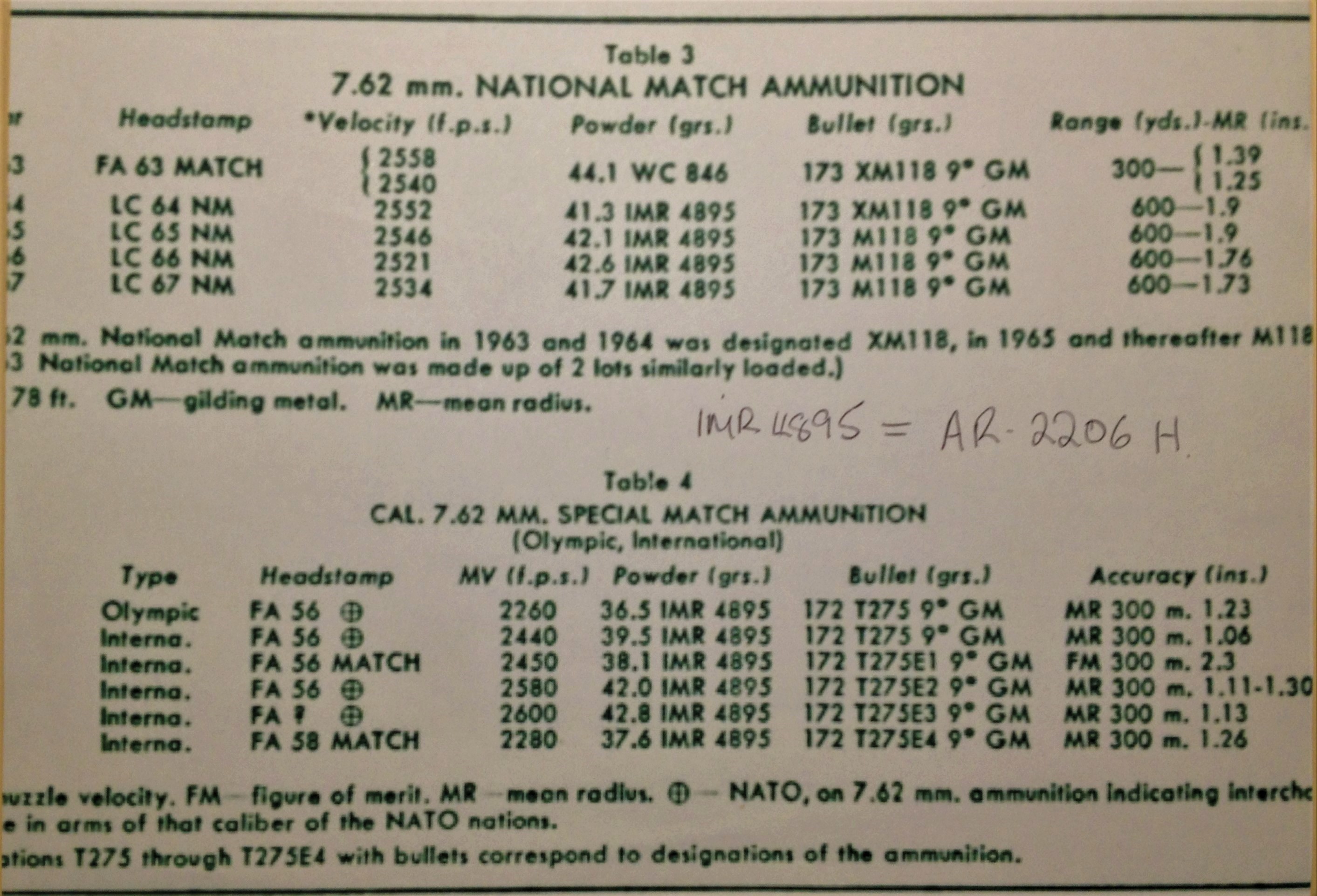

    Check this chart out on sniper loads tested and the powder albeit in 308 and not 30/06 as I checked 3031 and it may be that that powder is to fast setting up different harmonics causing shot dispersion.
    3 targets show a general central dispersion with 1 target dispersal low right I'd have a look at a slower powder.
    I tried for a long time to drive my 6.5 x 284 at the speed U.S shooters were 2950 fps/140gn Berger VLD's it would not really group all that well dropped a 100 fps off the load and it all settled down.
    But it took 1 barrel to work that out mind you that was with 4 different powders / 5 different projectiles / 2 different primers / 2 different cases / 10 types of jump and 2 of jams !

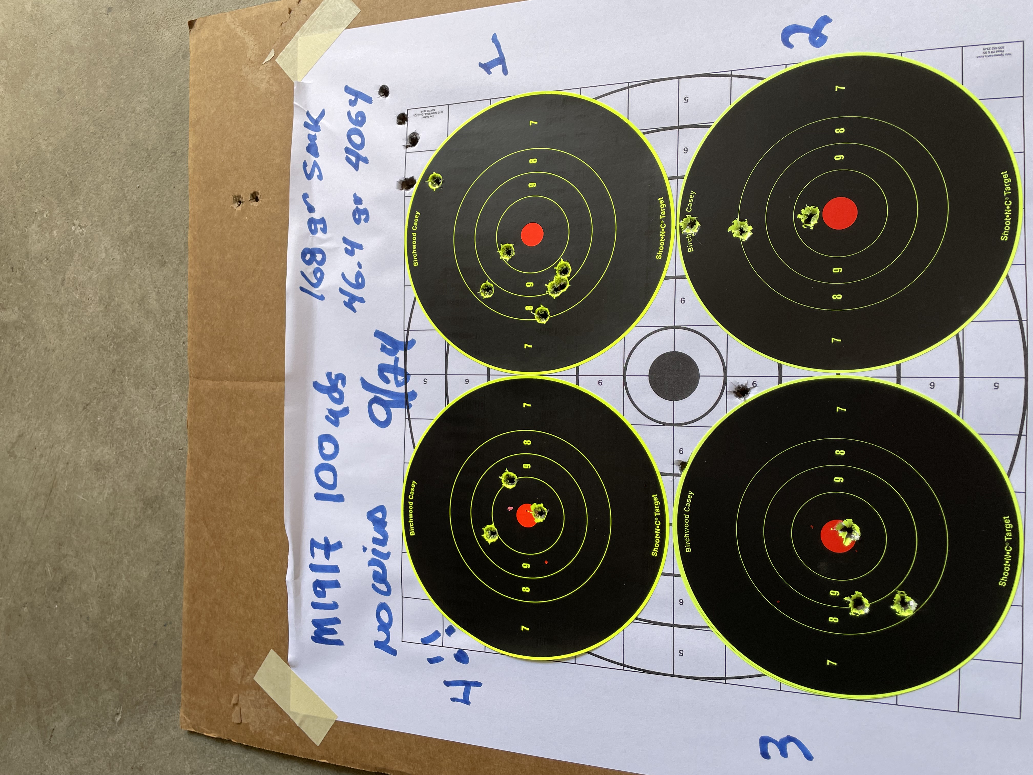

    Redux
    I went to the 4064 with your guy’s suggestion and with a heavier bullet and I’m somewhat pleased. My last six shots at position 3&4 are utterly acceptable in a 105 year old Hunslayer. 180 gr is next. Thanks everyone.
