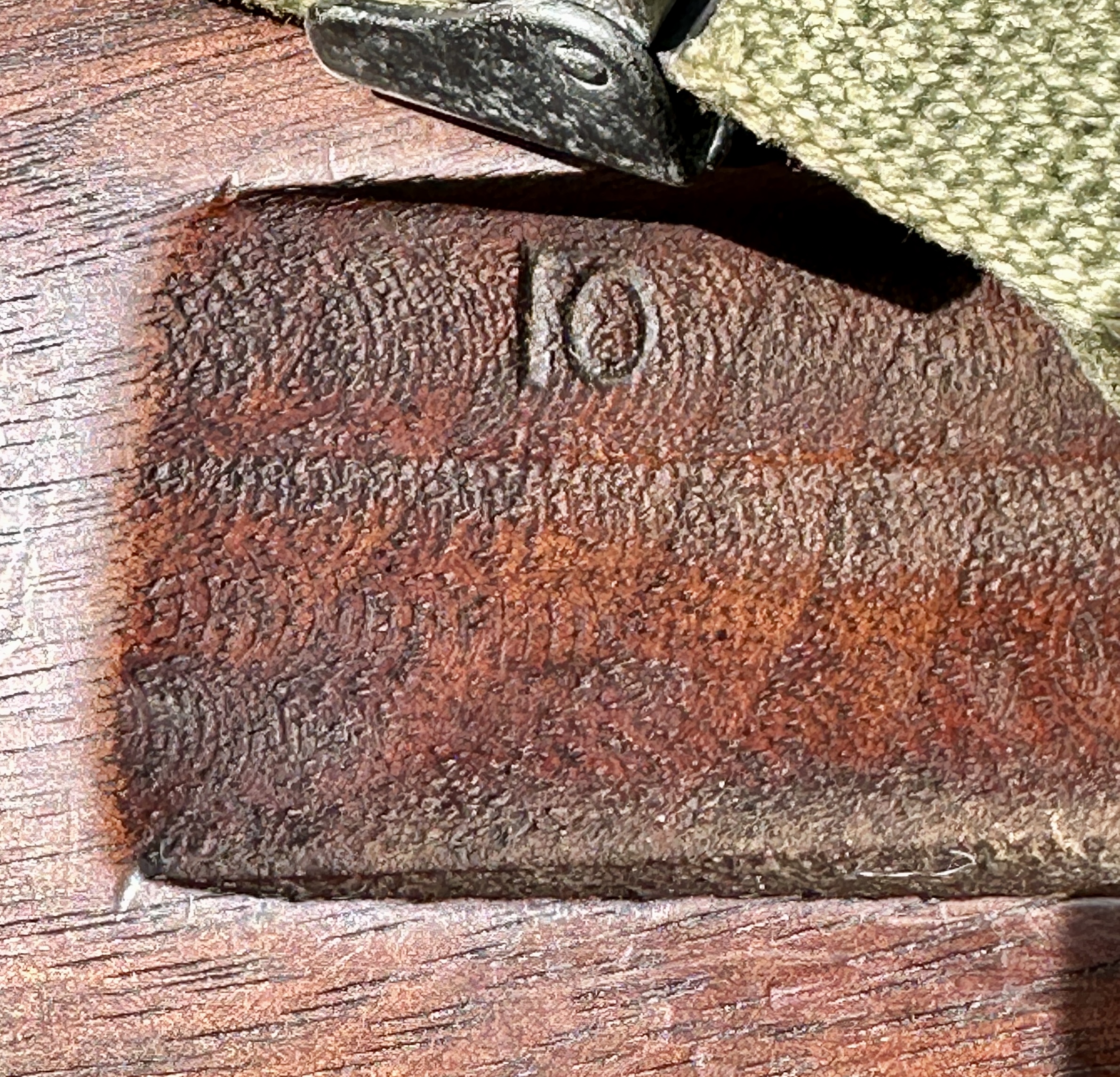

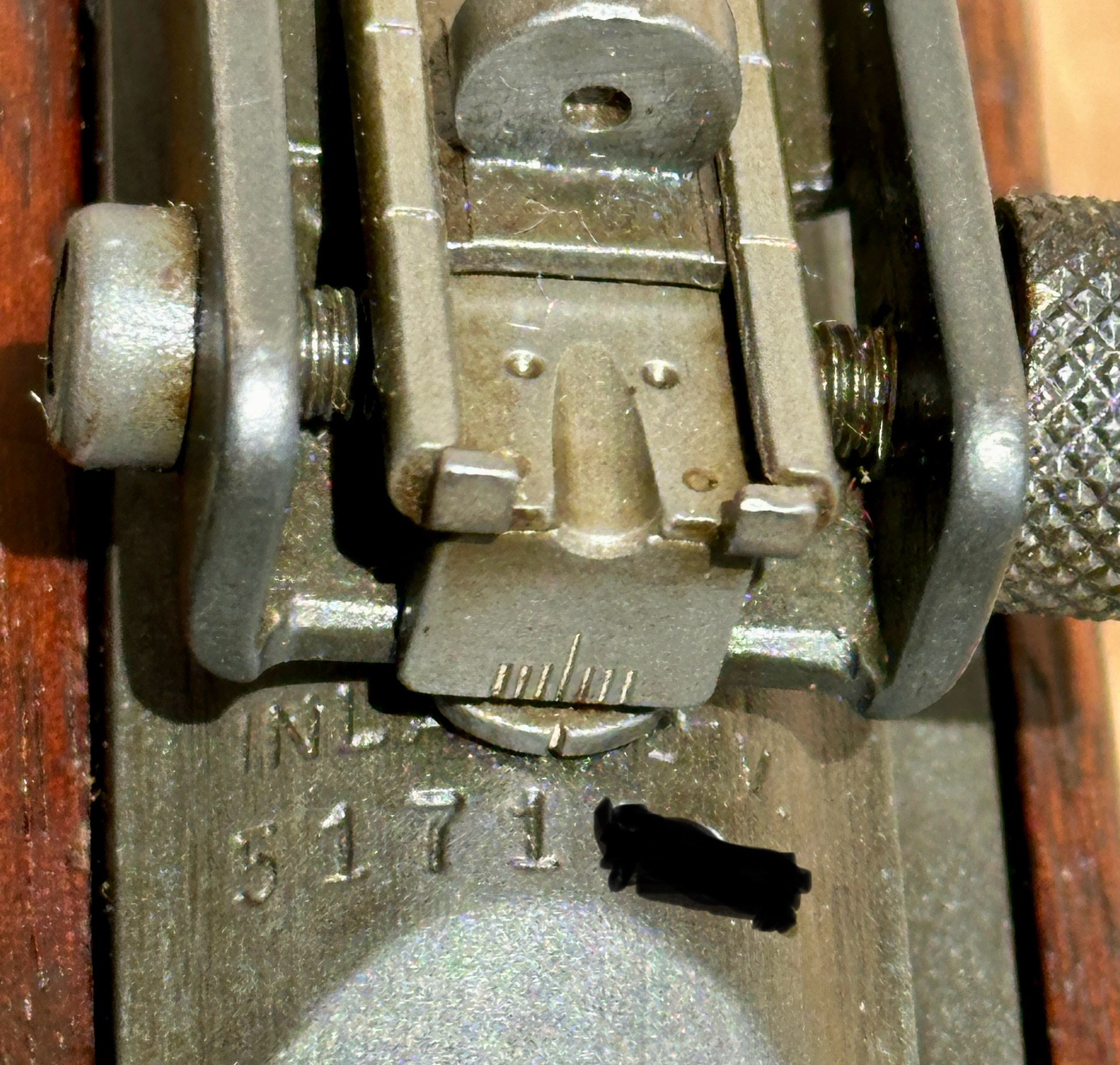

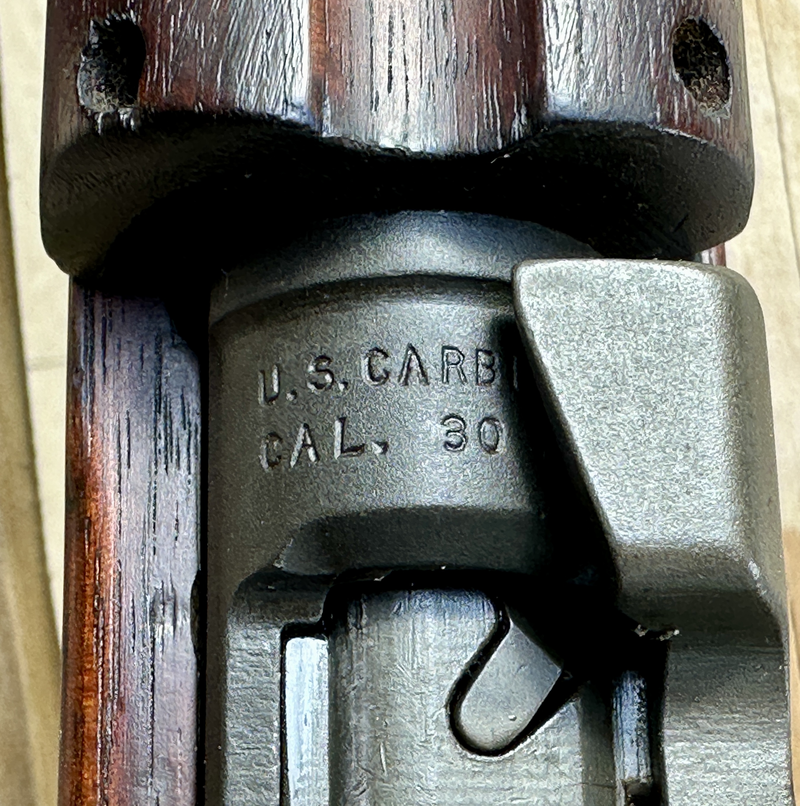

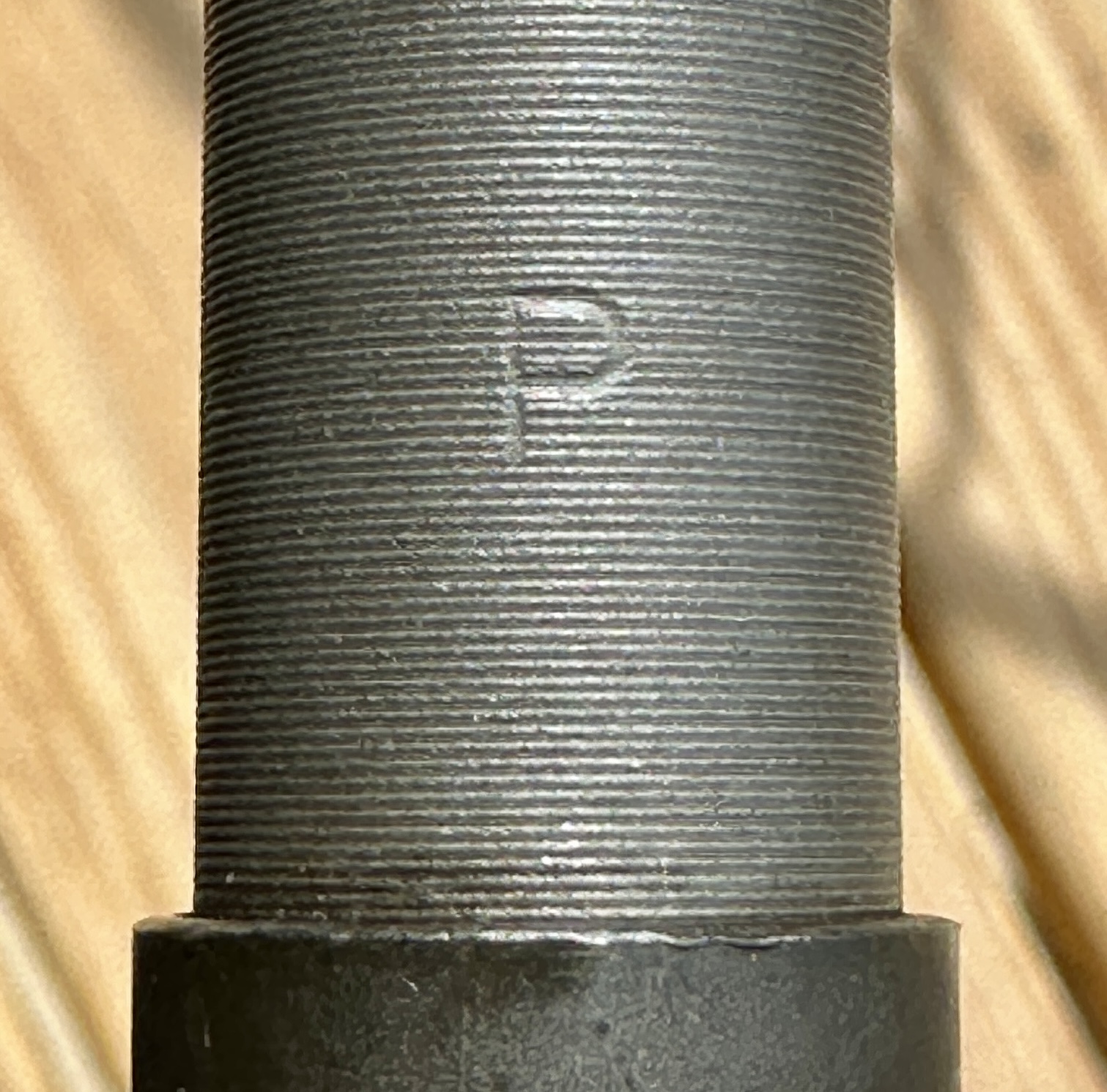

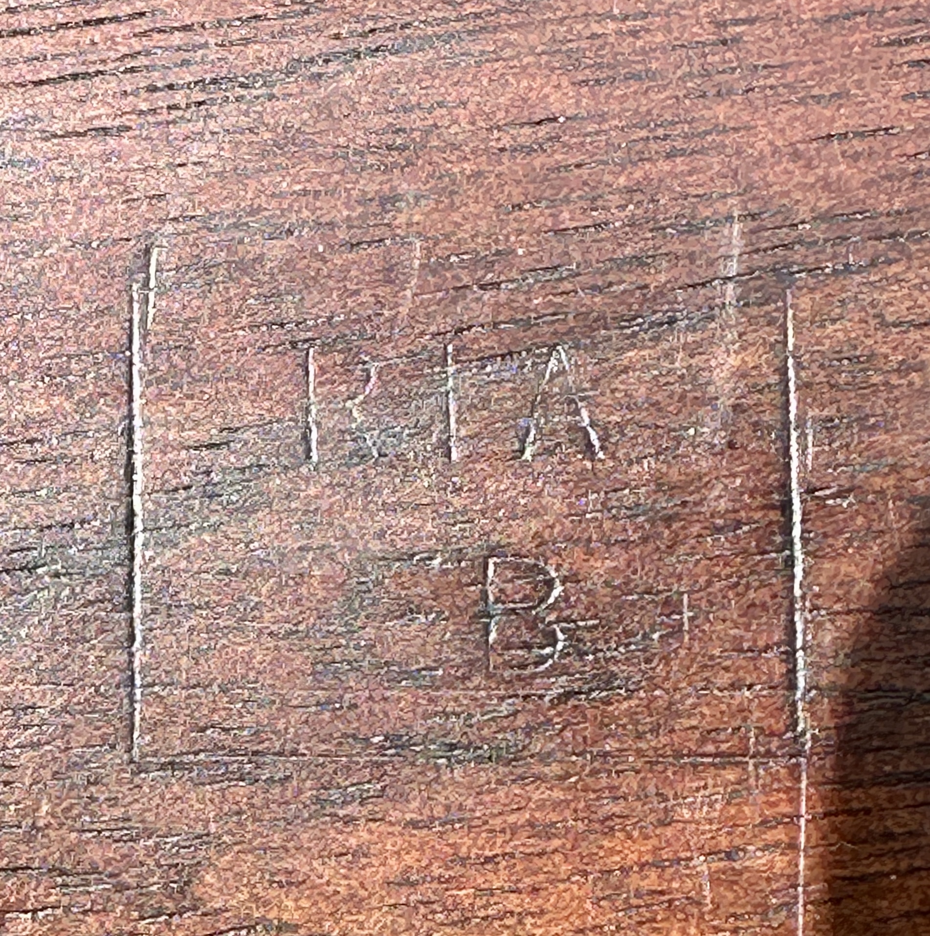

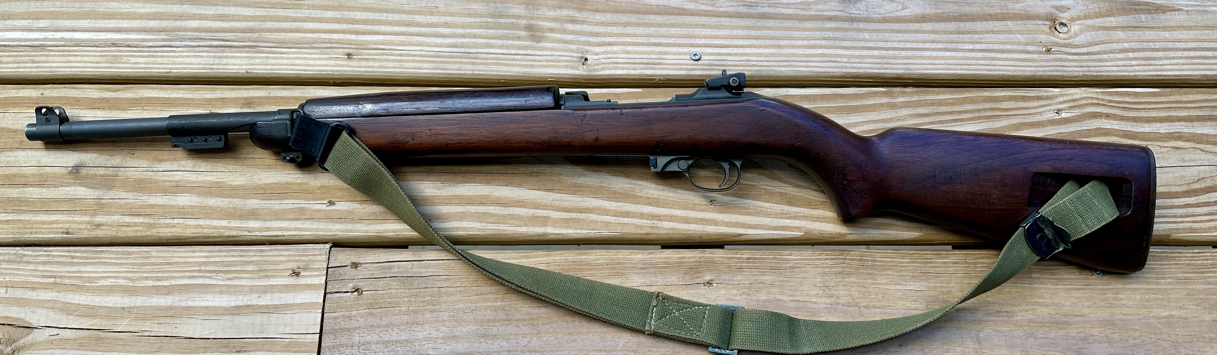

    Late Uncles Inland M1 Carbine. Still teaching my boys.

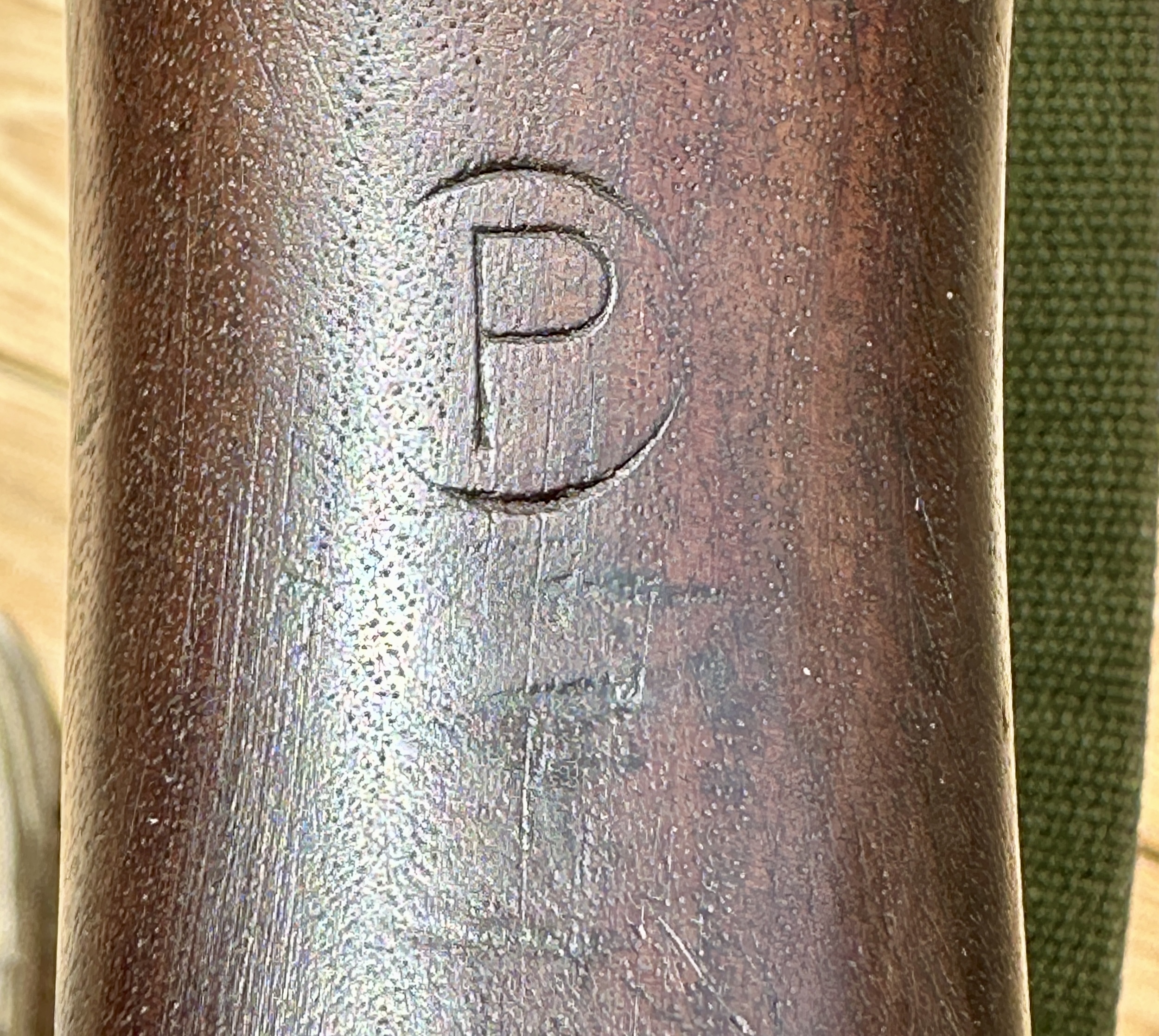

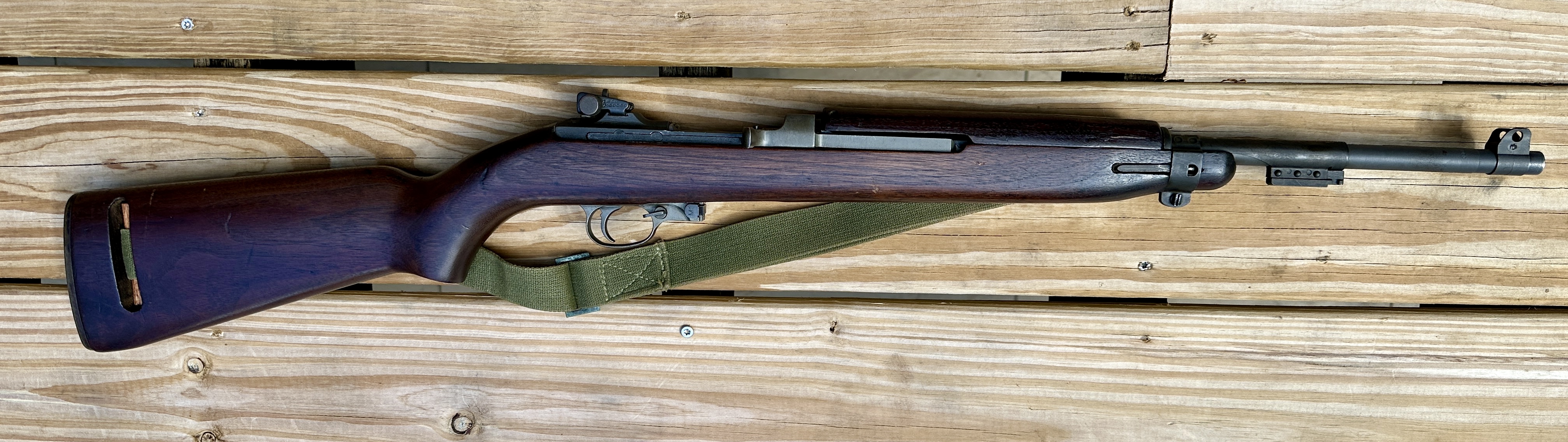

    My late Uncle, who served in WW2, purchased this Inland M1icon Carbine directly from the Government, pre CMPicon, for approximately $34. His son was went with him to take delivery of the M1 at the train depot. Cuz was 10 at the time. Fast forward to 2016 and cuz lends me the carbine so my then 10 year old No. 3 son could learn to shoot. Now we are in 2023 and my No. 4 son is 8 YO and once again he is learning to shoot with the same M1 carbine. I am sharing pictures here in hopes someone can clue me in on what the worth of this old family heirloom might be, not that it would ever get sold.
    Best I can tell, it’s all original. Let me know if more photos are needed.
    Would changing original springs out for general shooting be a good idea?

    Really nice rifle!!! It is not all original since it appears to have the post-war refurbishments installed. It is in terrific shape and in California that is easily $1,500. Of course, it sounds like the sentimental value is off the scale for you and your family so I have a feeling your grandkids are going to learn to shoot with that rifle!

    If the carbine shoots and functions as it should then leave the springs alone.

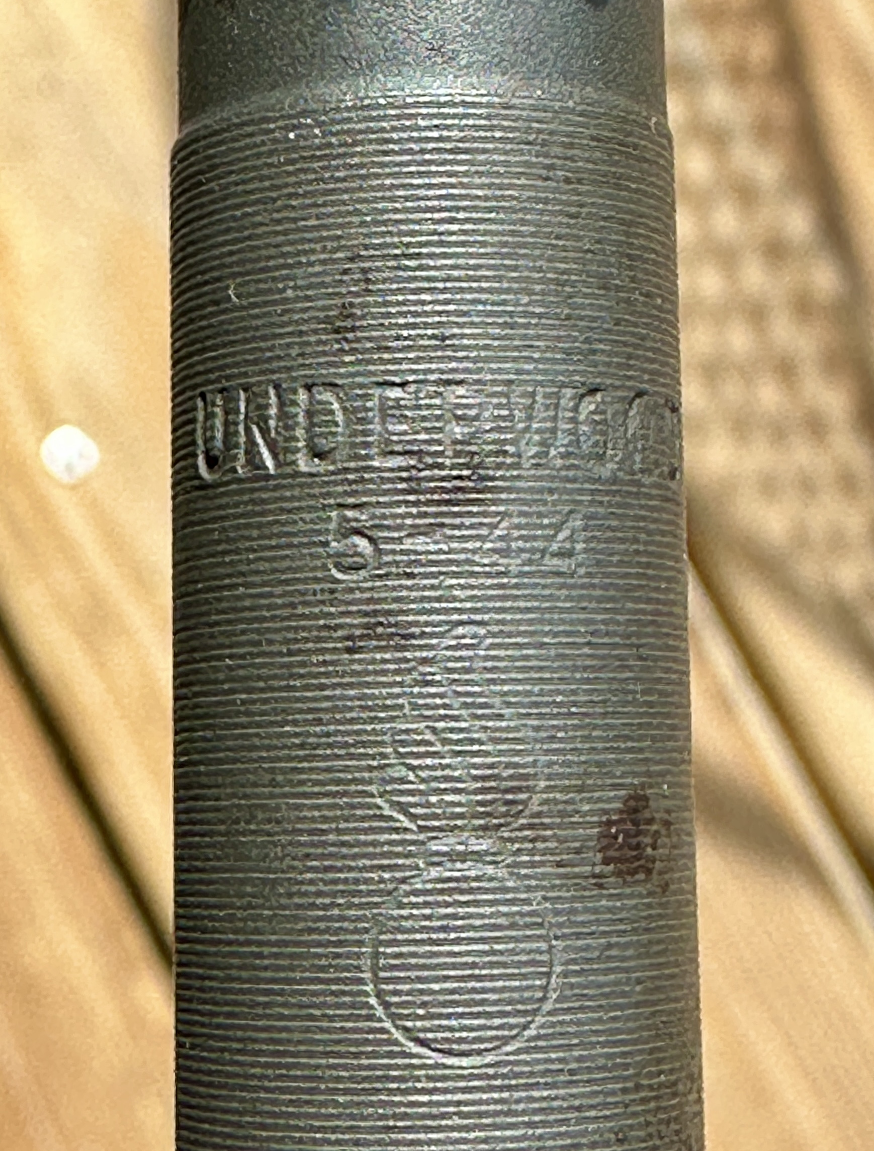

    As far as the upgrades Singer B mentioned. 1st off your stock has a Rock Island Arsenal rebuild stamp which indicates a post war rebuild. It has an Underwood barrel, Inland used Inland barrels. It originally would have had a push safety and a type 2 barrel band, you have a flip safety and a type 3 barrel band.
    I am assuming that your serial is 5171??? and not 5171??.

    Value depends a lot on where you are. The lowest I would put on it is $1300. And in a few areas, it could go for as high as $1600

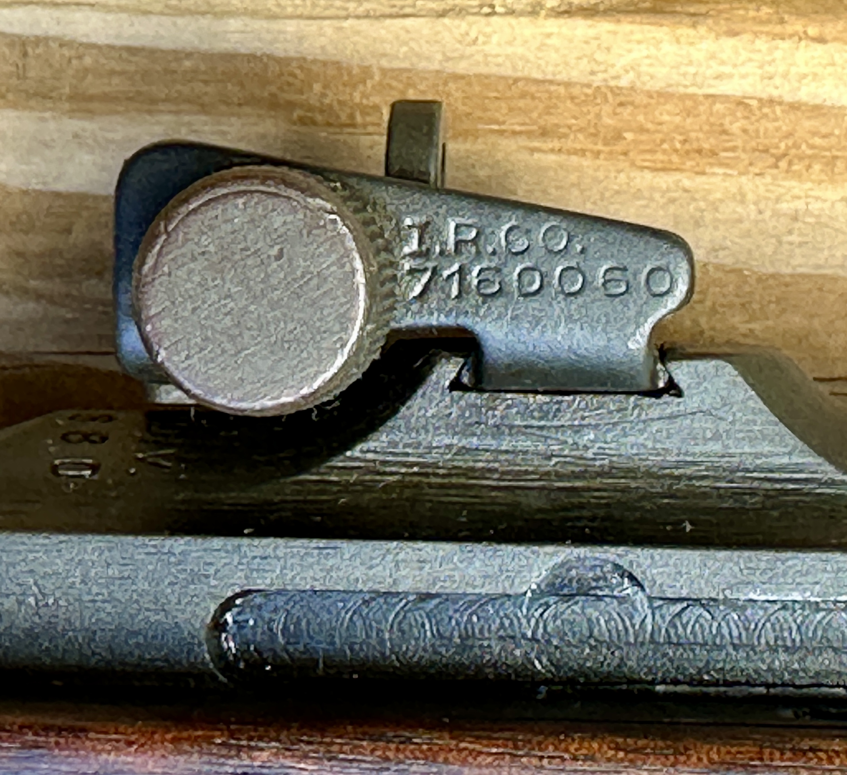

    To add to W5USMC, your rifle has the repalcement adjustable rear sight. Inland made more M1icon carbines than any other manufacturer so they don't have much of a "rarity" value as far as M1 carbines go. I also agree with him reference the springs. If the gun works fine, then let it be!

    Actually, believe his rear sight is possibly correct. There was mixed use of all the rear sights in this serial # block and the stamped I.R.CO. 7160060 sight was used by Inland starting somewhere around 5131xxx.
    Thank you, I didn't know that!
