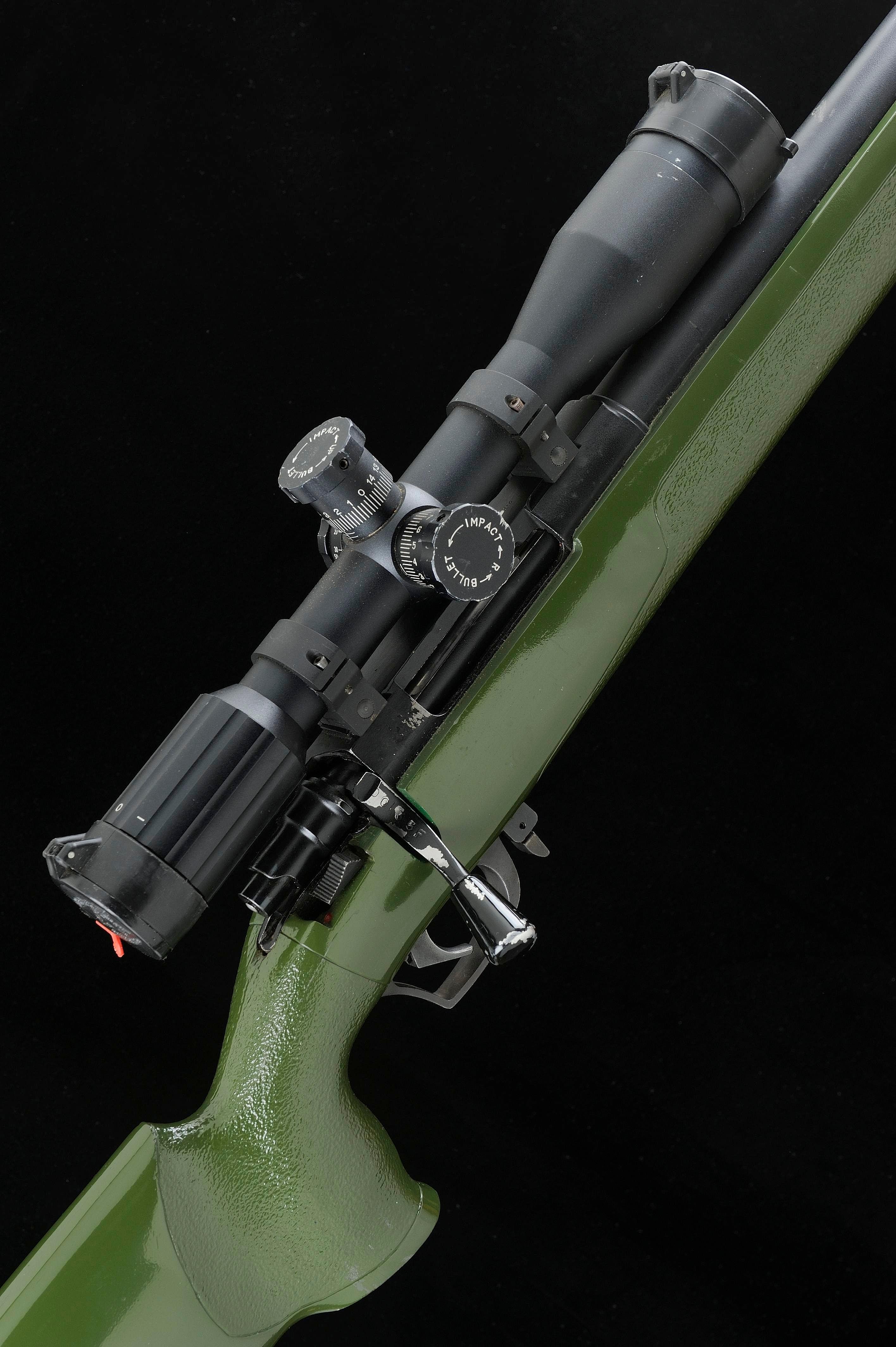

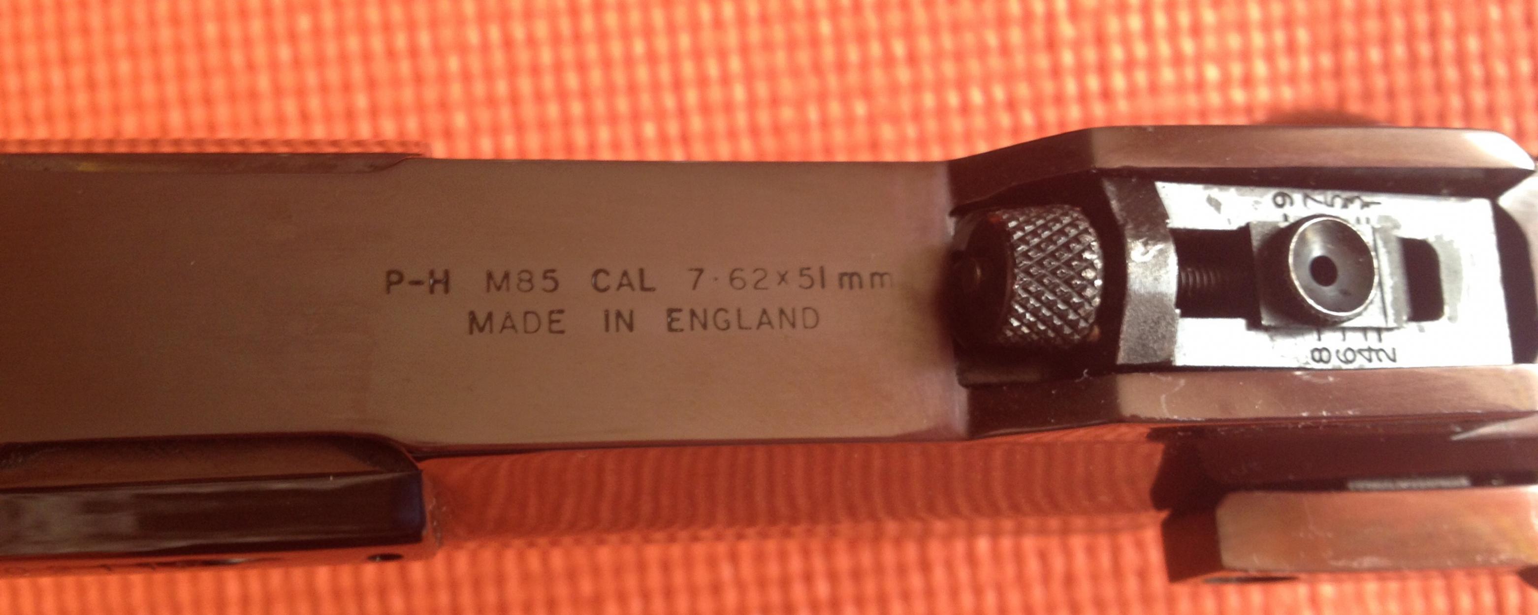

    It would be nice to see better photos, but it looks like an M85 action (extended front receiver ring) which has had the rear sight wings and possibly well removed.
    It would be interesting to know what Gil's list says regarding the serial number ?

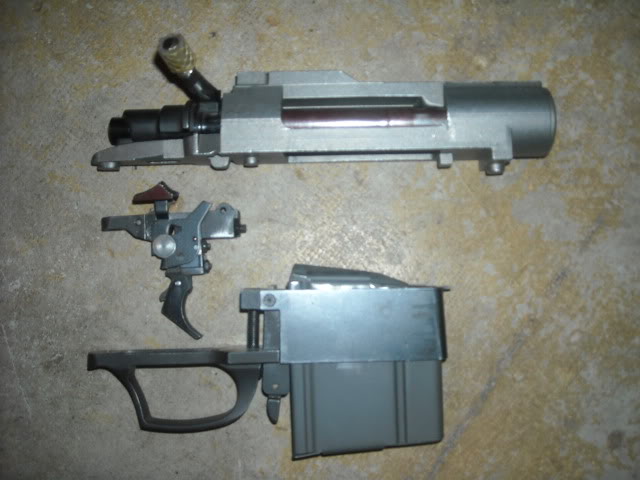

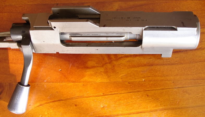

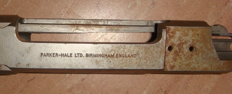

    I have attached a crop of the rifle in question and added a number of illustrative photos.
    M86/M87 action

    Could it be a Parker Hale M87 action

    This looks more likely than an M85

    The front receiver ring is too long to be an m84/86/87 action. Also the top bar extends too far to the right side.
    The action in question started as an M85 - looks to have been modified by removal of the rear sight wings and filling of the well that the rear sight sat in.
