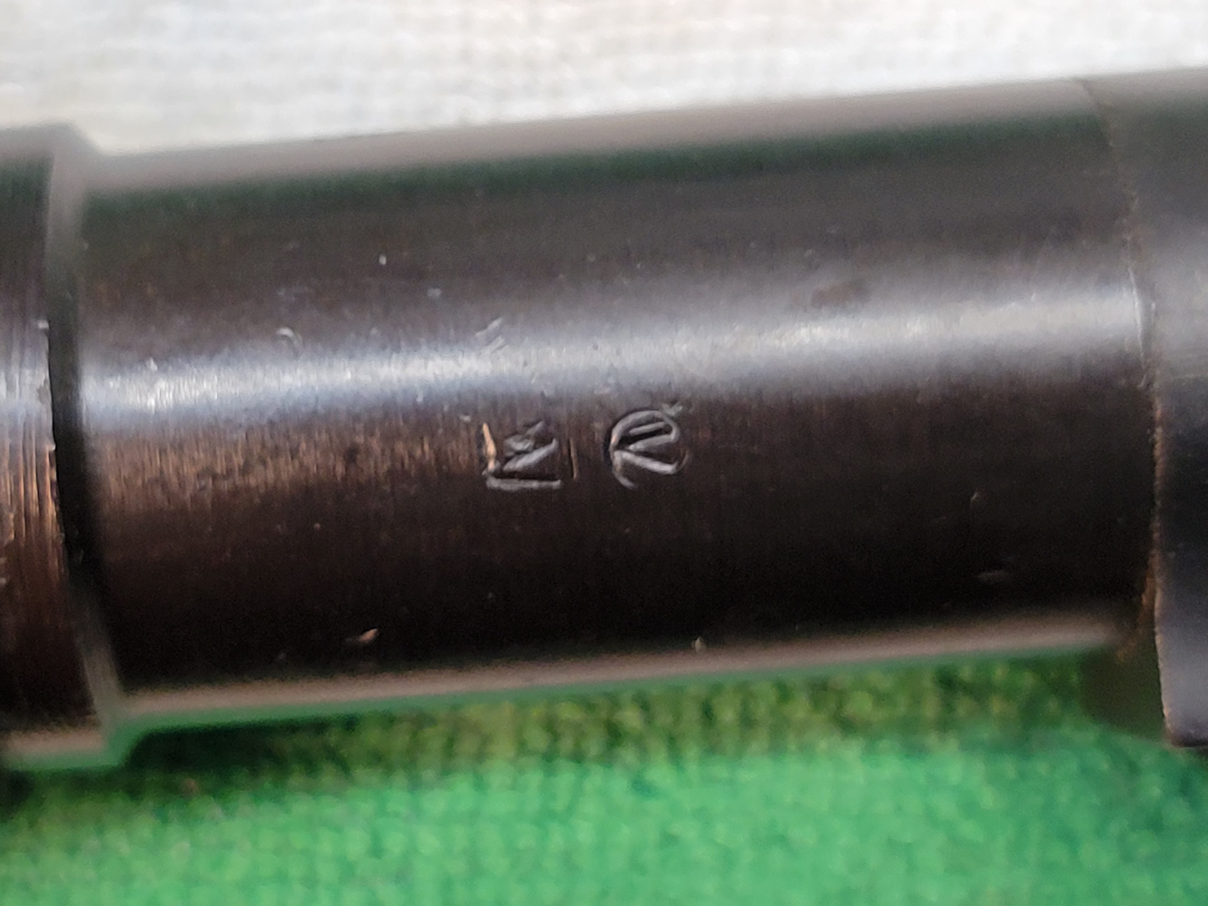

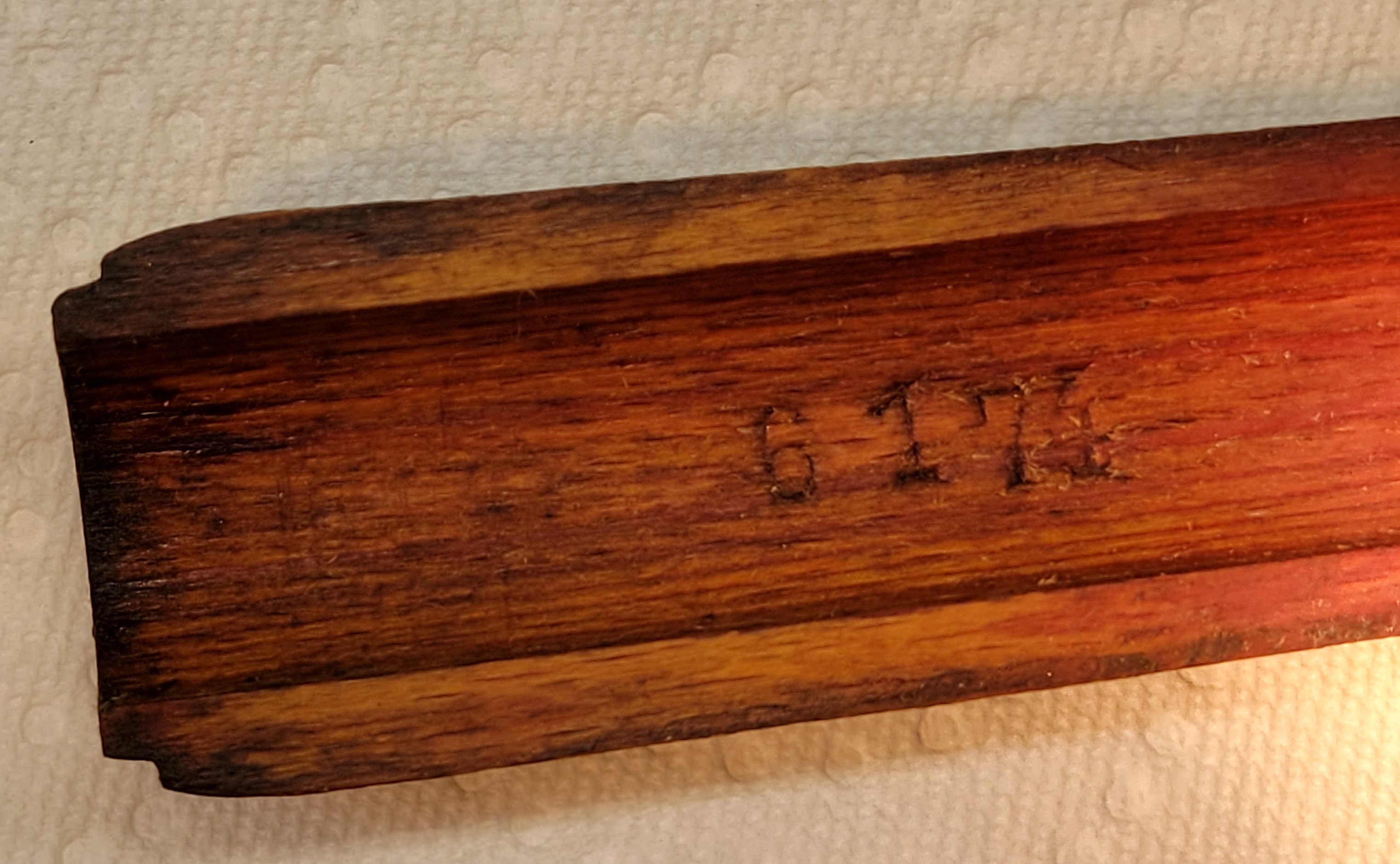

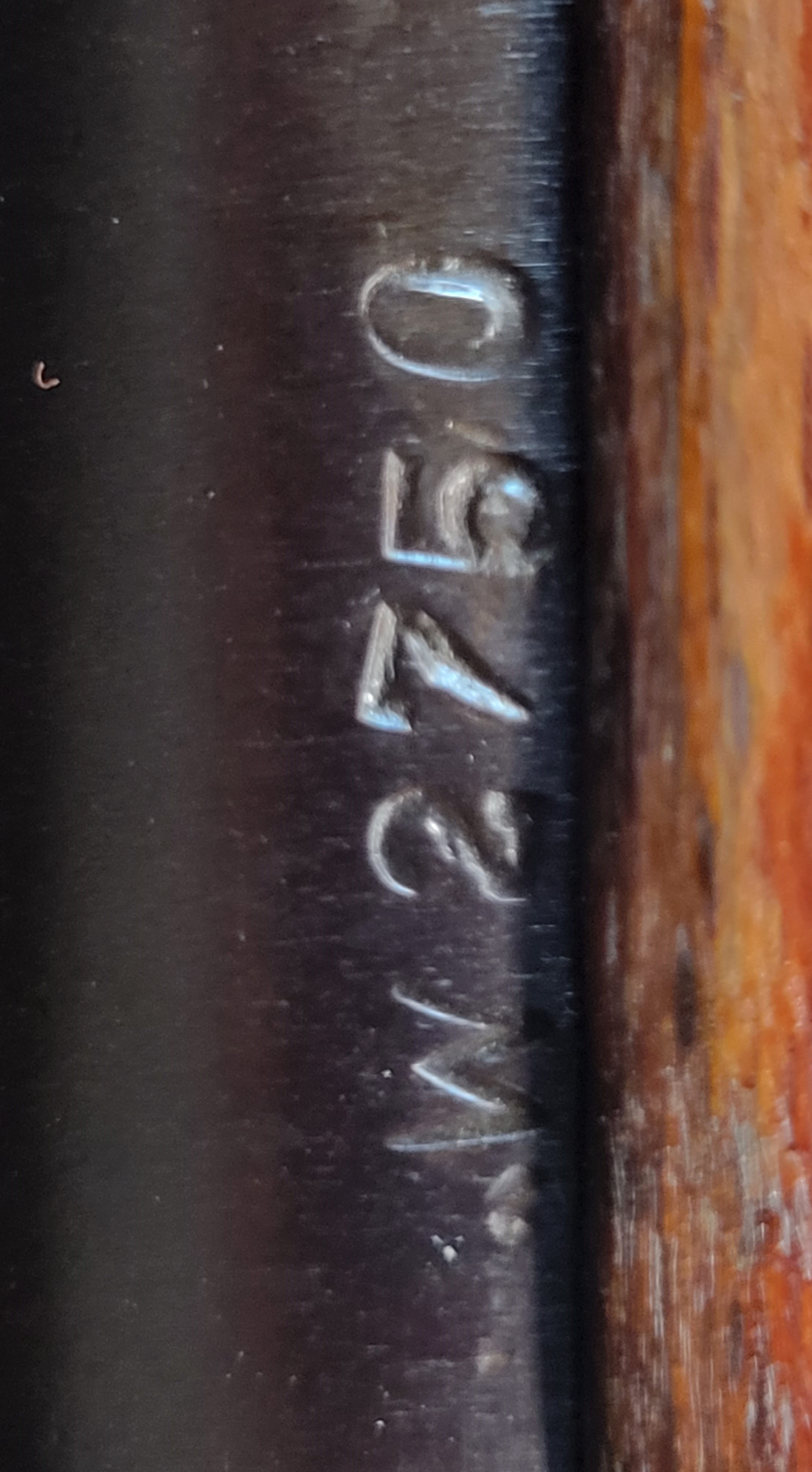

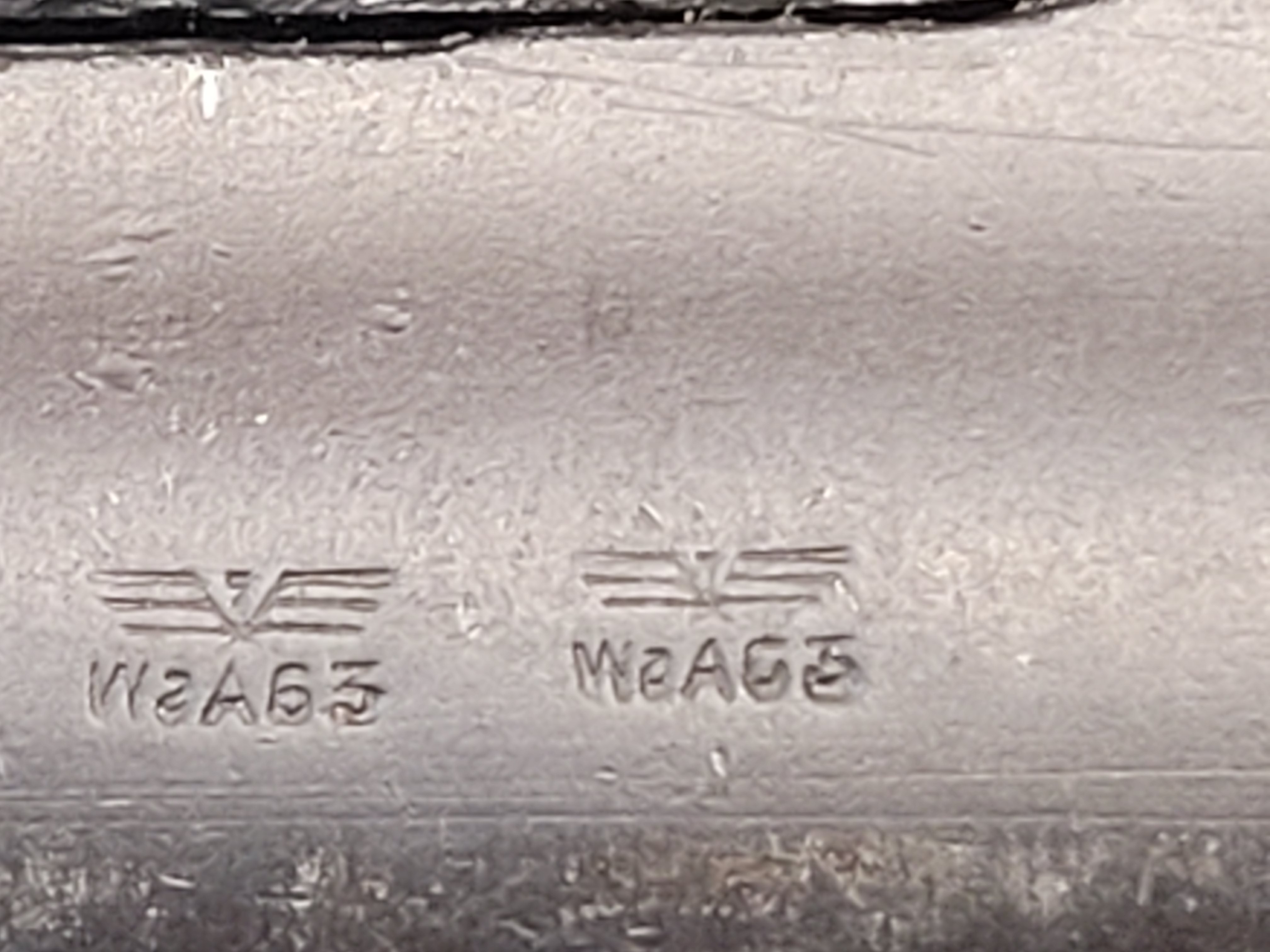

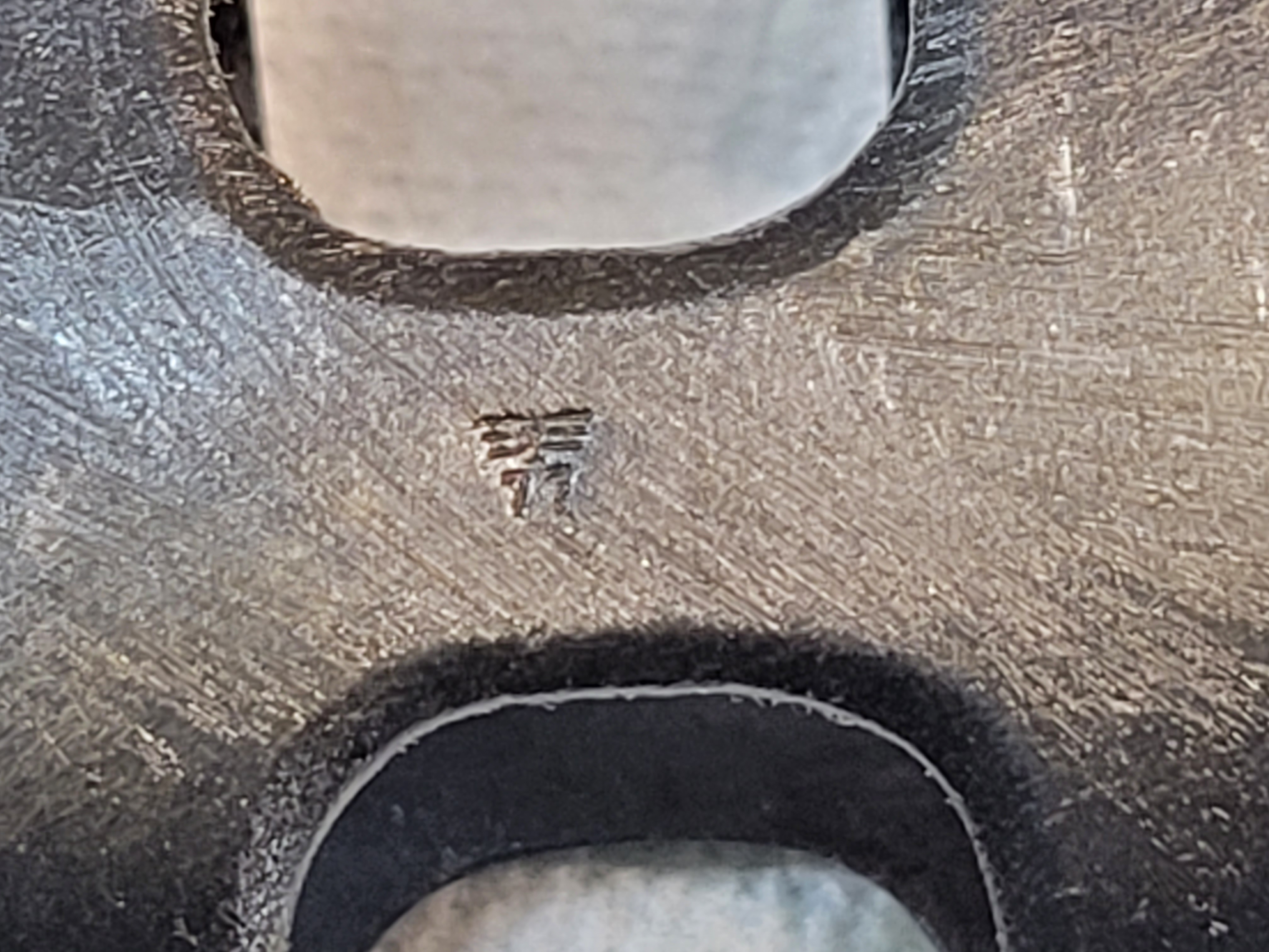

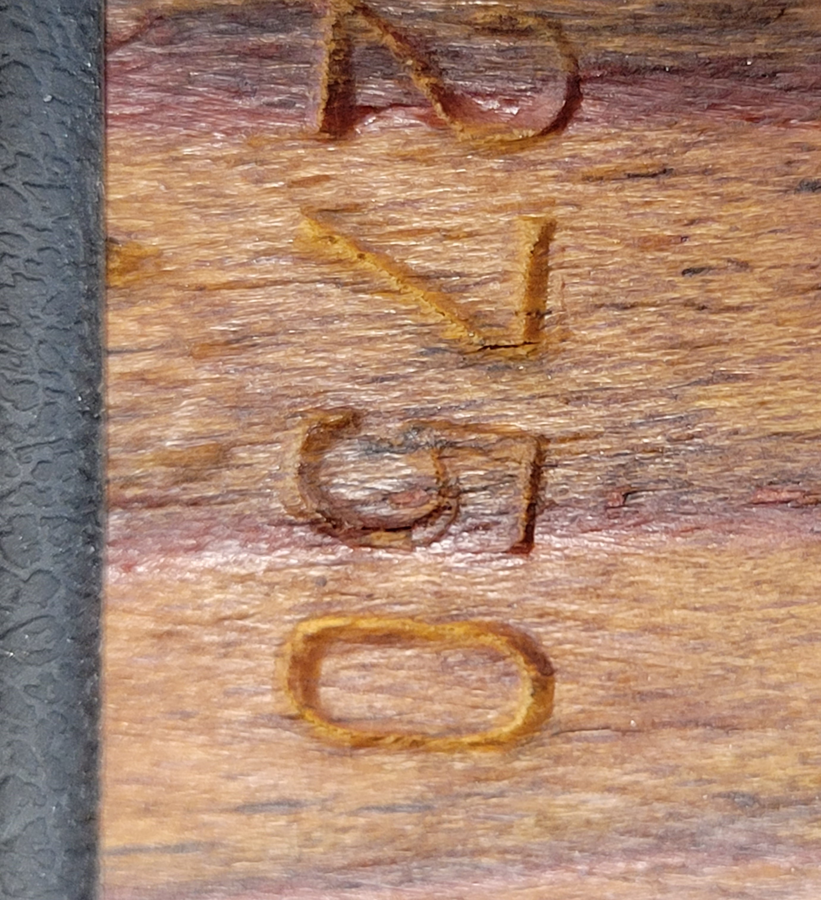

    K98k rifle identification
    Hi, I'm hoping for some help. I just got a K98kicon (byf 42), it's in fine shape, but the marks are confusing. The research says that the serial number should be 4 digits followed by an alpha. This rifle is W2750, the alpha in front of the number. On the stock is also 2750 with NO alpha.
    I have many more questions, but I'd like to start with the above. This is my first German rifle, the rest of the collection is US made and much more easily researched!
    thanks for your help, larry.k
    PS: thanks for the advice. I've added new photos, sorry I"m so late getting back to this. larry.k

    I suspect you are going to have to provide more photos in order to create more context for analysis. You are right - there should not be a prefix on a byf 42 Mauser. As you can imagine, this opens up Pandora's Box. Does the rifle have the expected Waffenant proofs? On what other parts does the SN appear? Do you have a pic of the upper receiver? Etc., etc. I think if you pose your questions framed in dribs and drabs, you are less likely to get a knowledgeable answer from a knowledgeable forum member. I know only a very tiny bit about Germanicon Mausers, and it is a vast and arcane subject with many rabbit holes.

    As said, gonna need more photo's of the rest of the rifle first, but that's not an original byf 42 serial number.

    You indicate the stock is also marked "2750." Where? Inside the handguard? On the buttstock near the bolt take down disc? More pictures are definitely needed if you really want to know what you have.

    Many of the early K98kicon re-works before 1948 did not get the familiar Yugoicon crest that later rebuilds received. Generally, these early reconditioned capture rifles were inspected and only what needed repair to bring it into operational order was fixed. Also, often times not all of the German proof marks and stamps would be scrubbed, but the four digit serial numbers would be stamped on the left side of the stock.
