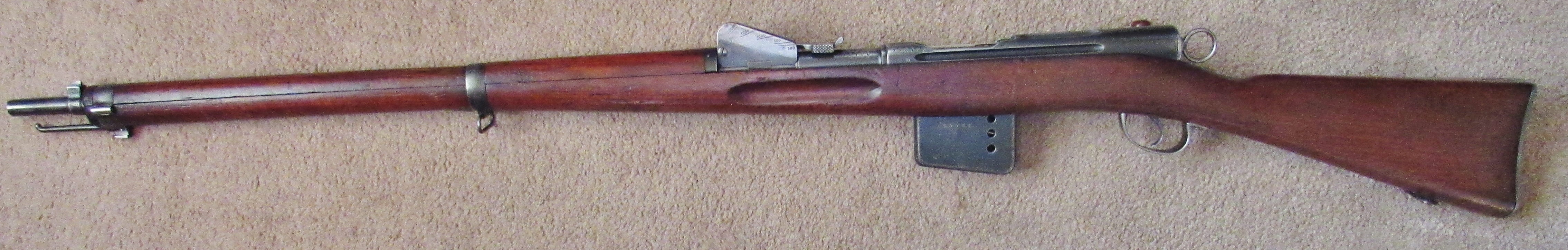

    Bit the bullet and picked this one up to expand the Swissicon accumulation. Mfg. 1893. Mag is a mis-match, but looks like the replacement was done some time ago. P30 mark on left receiver. Am I correct in that this indicates it passed out of service to an ex-serviceman, possibly in 1930?
    Didn't hurt at all that as an antique, it was shipped right to my door with no interference or interaction whatsoever from/with various restrictive governmental entities. A pleasant whiff of times past there.
    I'll be slugging the bore when I get a chance in order to produce loads appropriate to it's design.

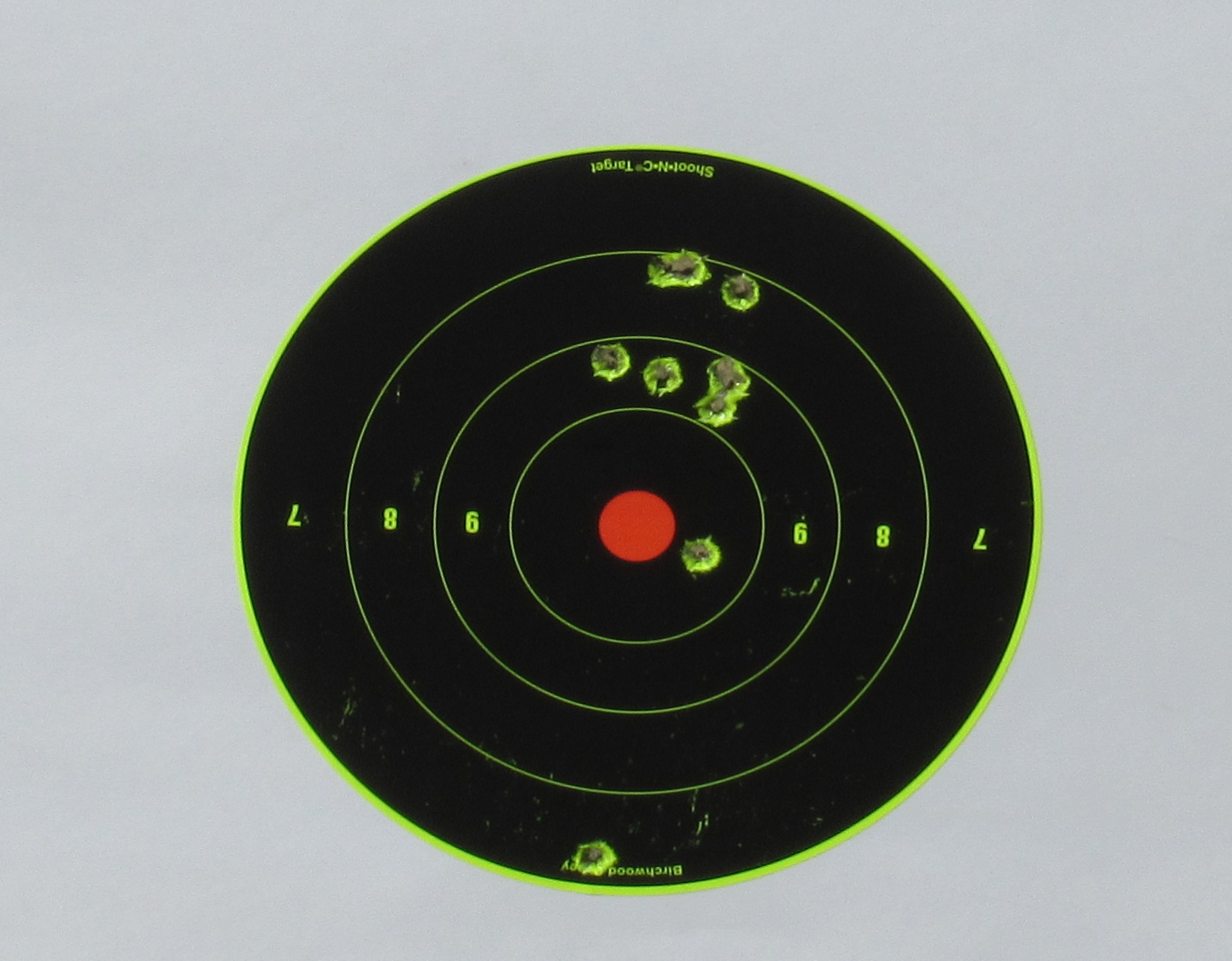

    Been a while, but got to the first test firing of ten rounds at 52 yards. First one was way low, walked up the next two. Fired the last seven for effect with the front sight buried in the rear notch, 6 o'clock hold on the bull.
    Bullets cast from Lyman 314299, sized to .311", and gas checked. New Privi brass. Used 22g of 4198 (usual disclaimer). OAL was 3.127", about as long as would feed from the mag. No leading, and good gas sealing of the brass. Oddly, didn't get the amount of case neck swelling so many report. Should help with brass life.
    Looks promising, despite elderly eyes with no corrective lenses. At least I can still focus on the front sight.

    Thanks for remembering to get back to us on this one.

    Wish it could have come sooner, but life will have it's way with us, as many here can attest. Hope it's of some use to someone.
