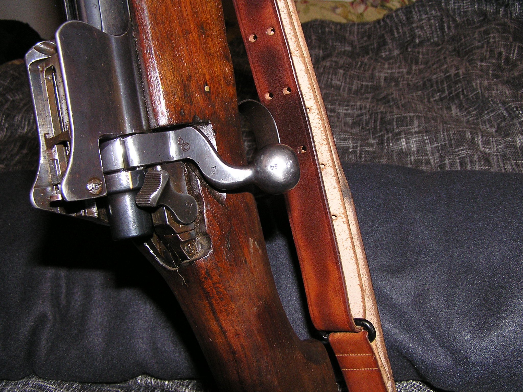

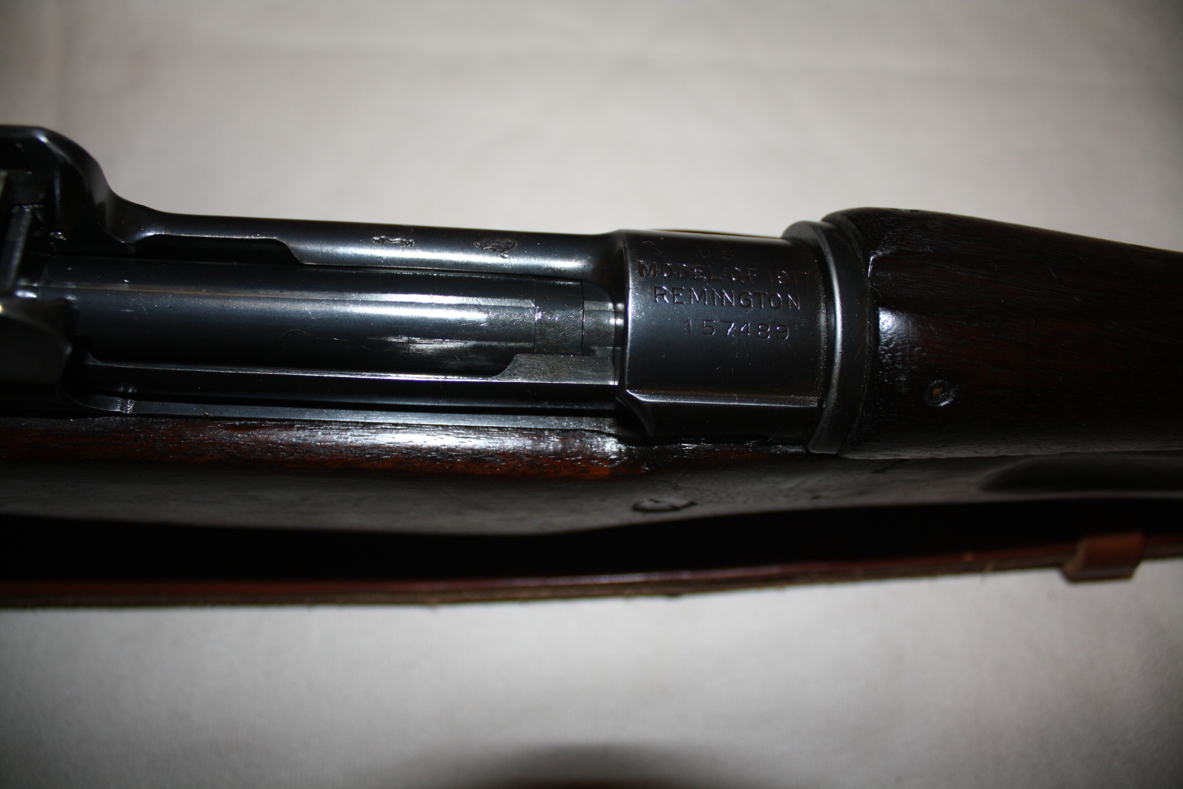

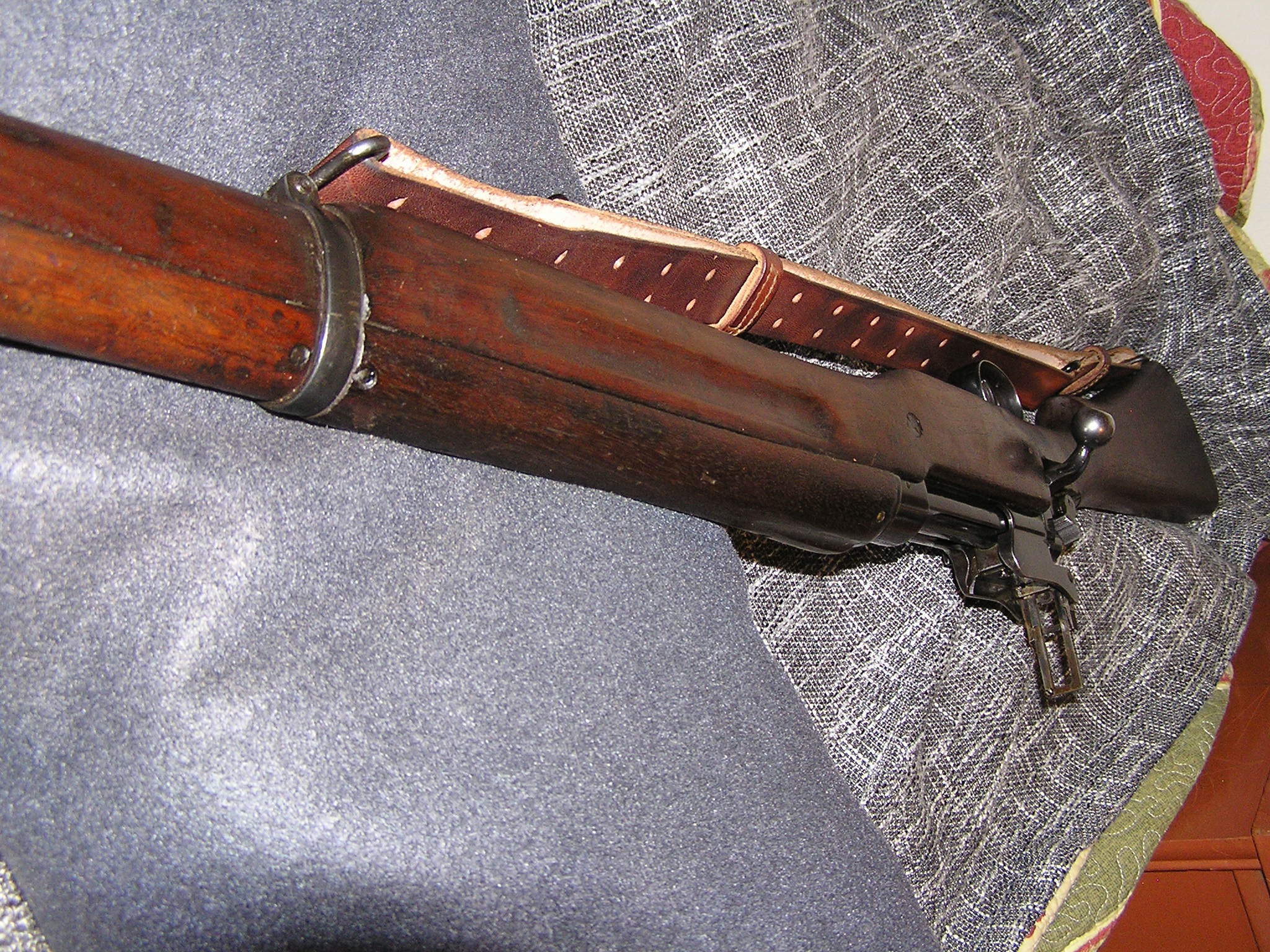

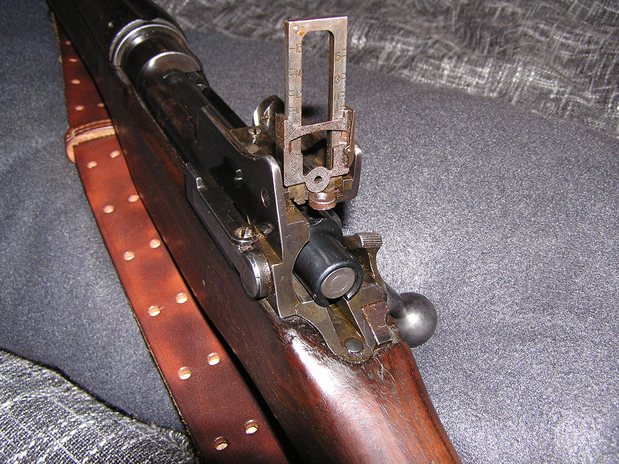

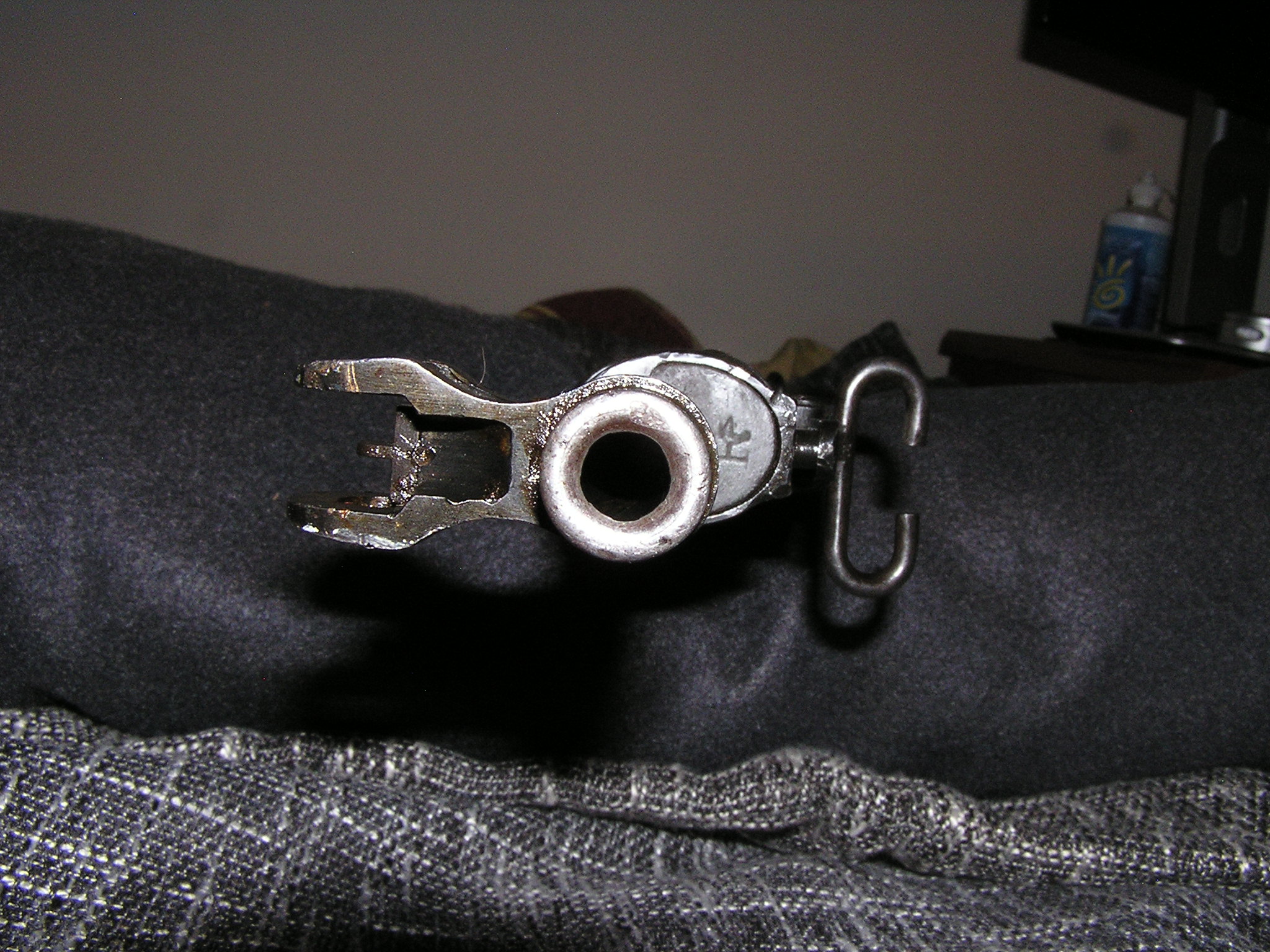

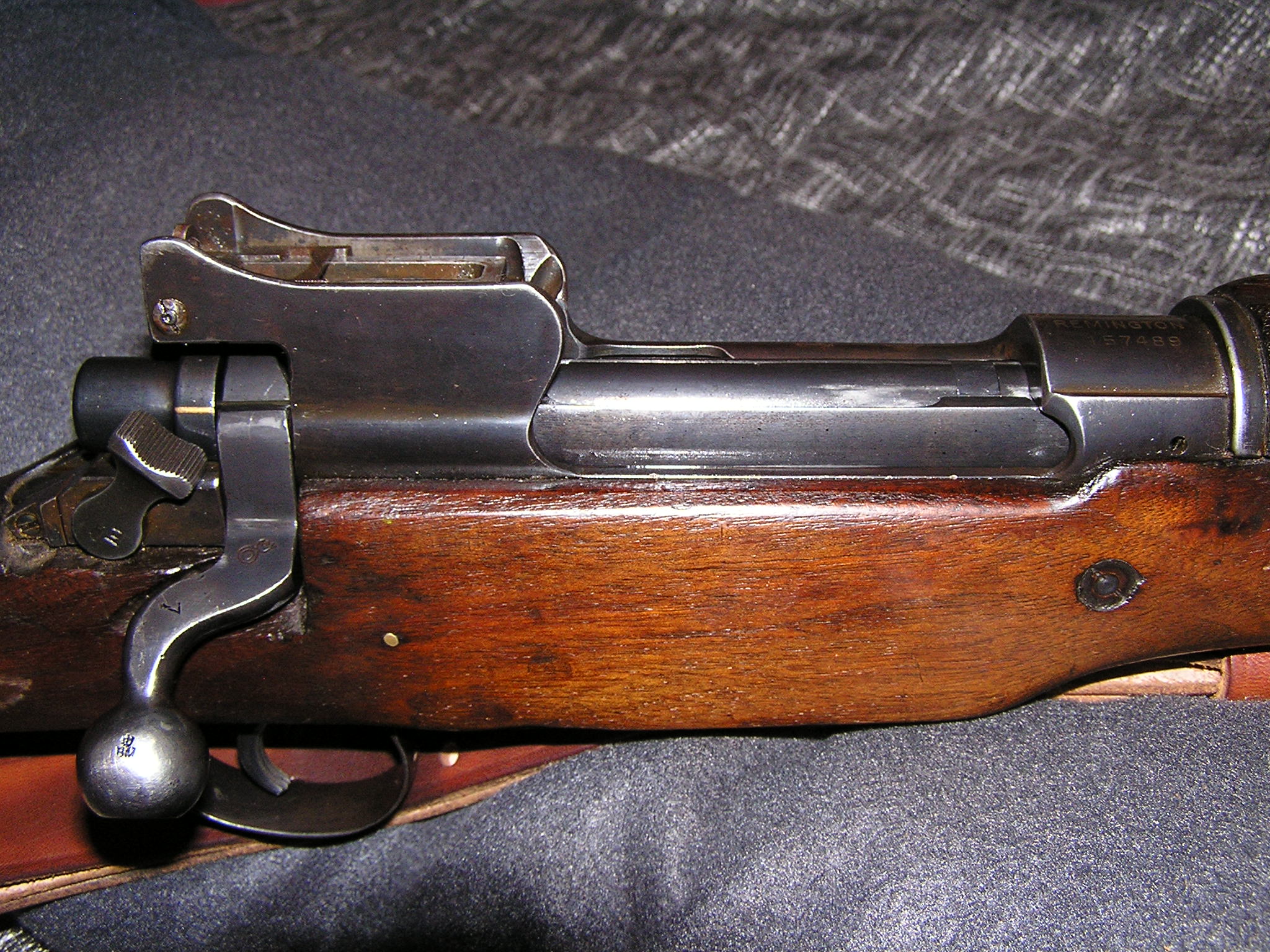

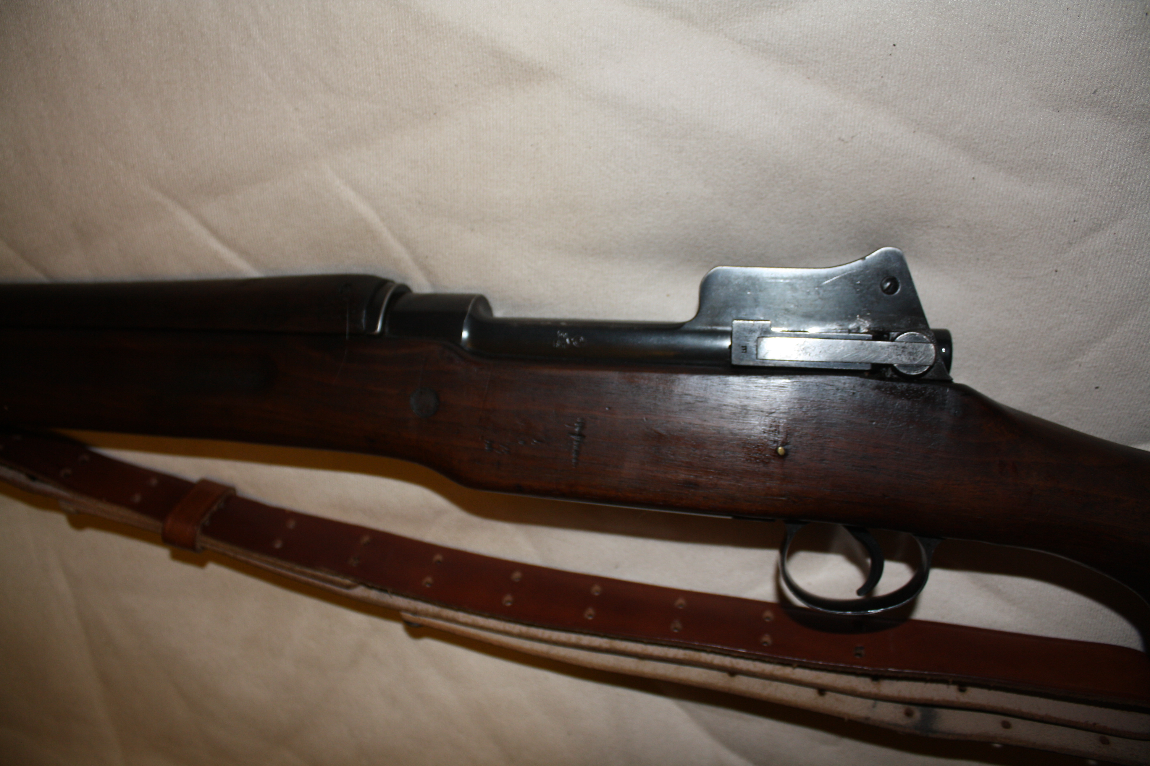

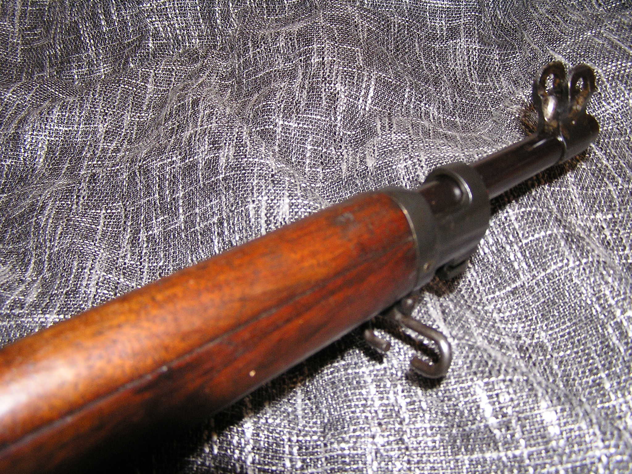

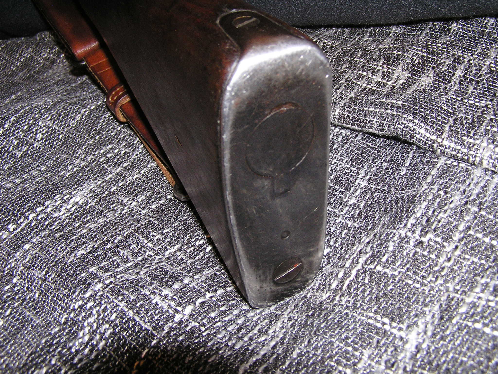

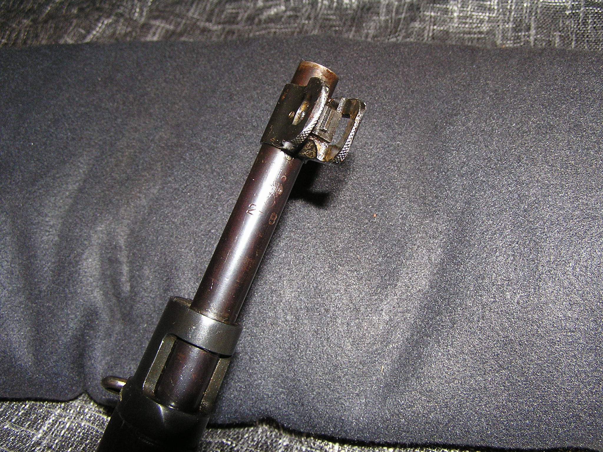

    Here are the pictures!
    There we go. Let me know if you would like more pics of something specific. I just borrowed this camera and I tried to get the best
    focus/lighting.
    -Mike

    I realized that there are no clear pictures of the left side of the receiver. This is the best one, and that stamp on the left side of the receiver is a BM with a crown over it, and a flaming bomb.
    Today @ 01:04 AM
    31,127
    06-11-2025
    12:46 AM
    Nice, that should help them see what's what.

    Quote Originally Posted by mmontag View Post
    Attachment 134236 stamp on the left side of the receiver is a BM with a crown over it
    Britishicon commercial proof mark. Should on the bbl as well (often under the handguard)

    Quote Originally Posted by Mk VII View Post
    Interesting, so this one actually came from the U.K. I don't see any import marks but perhaps I'm not looking hard enough.

    You can easily tell if the front sight is a .060" or a .090" by measuring its height above the center line of the bore. The 11 various front sight's heights will be between .985" and 1.135" so a .060 stamped sight will be 1.060" above the center line of the bore and a .090 will be 1.090". You may wonder why .060 and .985 don't add up to 1.060". That is because the first two sight heights are -.015" and 0". Remington's production started in 10/1917 and continued until 12/1918 with a total production of almost 586,000 rifles. Your barrel is original since M1917 replacement barrels would be stamped either HS for High Standard or J.A. for Johnson Automatic and would be parkerized. All this information can be found in Charles Stratton's Britishicon Enfield Riflesicon Volume 4.
