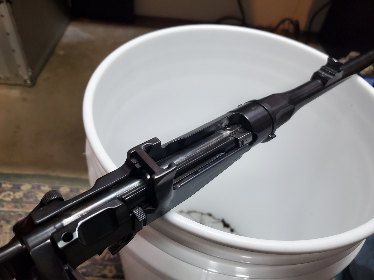

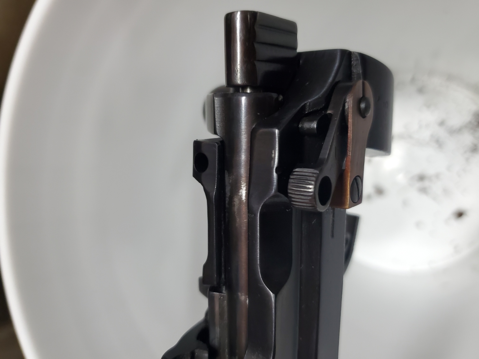

    Guys, First post. I have a sporterized No5. Someone ground off the rear sight mounts, the bayo lug and put a barrel mounted site in front of the receiver. The barrel mounted site is a williams blade sight, it is very well done - just rather have rear sight farther back for sight radius purposes on such a short rifle.
    I am not a gunsmith, but can do basic things.
    Wanting an aperture peep style rear site. I see that williams had a 5D-SMLE but that requires a drill/tap which I am not comfortable with mounting myself. Are there any other options out there?
    Thanks,
    CP

    They can be hard to find, but I believe the vintage parker hale target sights are no drill, using the existing screws for the safety.
    Edit. Looked into it, the No 4 type requires the old sight base.

    Yes - The PH sights require the use of the old rear sight mount to locate the cross-screw. The other screw uses the ejector screw hole.
    Peter Laidlericon wrote about the body of the No5 rifle 'spreading' on firing and that you could always tell a high-mileage one because the sight pivot retaining pin was broken off.
    Without the support of the charger-bridge this thing must really flex an alarming amount and must be very inaccurate

    Thanks for the feedback. I will look into the Williams a bit more with the help of a gunsmith.
    The charger bridge is still very well intact, its the sight mounting ears that were ground off.
    As far as accuracy, not bad. I can hit an 8" gong at 65 yards easily. Not tried anything beyond that yet. The barrel is in excellent shape. I had heard the No. 5's were not that great at distances to begin with so no disappointments there.

    Quote Originally Posted by baconslayer View Post
    Sorry, my bad. The rear sight transverse bolt does take a lot of load - when I fitted my PH5C I overtightened the bolt and it locked the bolt solid, so I had to slacken it off. The side of the body does flex under recoil.

    Alan,
    Thanks, but at this time I have yet to test beyond 65 yards. I have put a total of 20 rounds through it at this point, it is accurate enough given the crap sight situation. The way the existing sights are configured is difficult to get a good sight picture with my ageing eyes. That is why I am exploring other options for a better sighting solution in this thread. When I get it all resolved, I can better report my distance accuracy testing. - CP

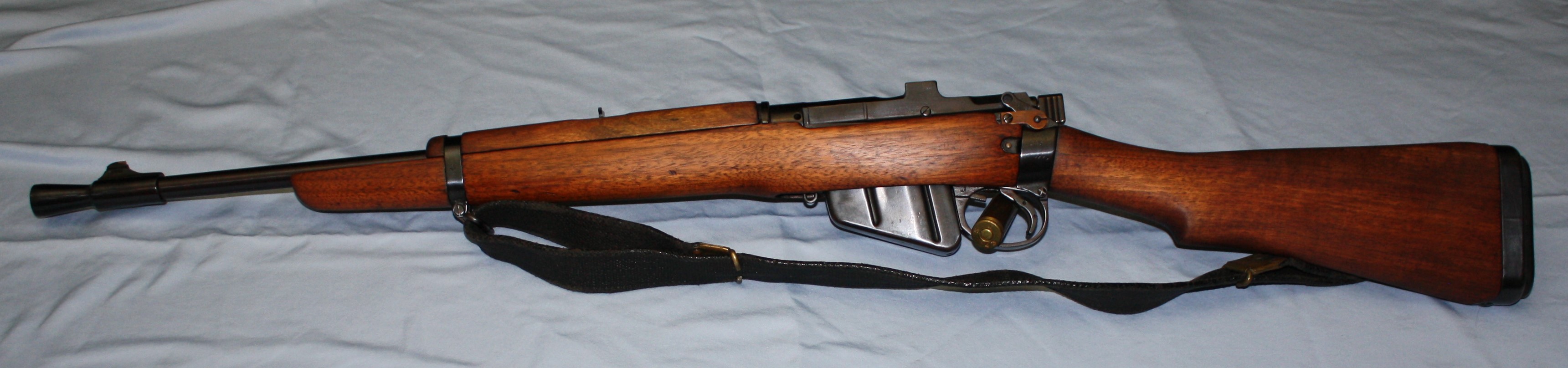

    With her clothes back on.
