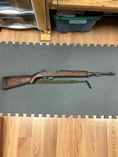

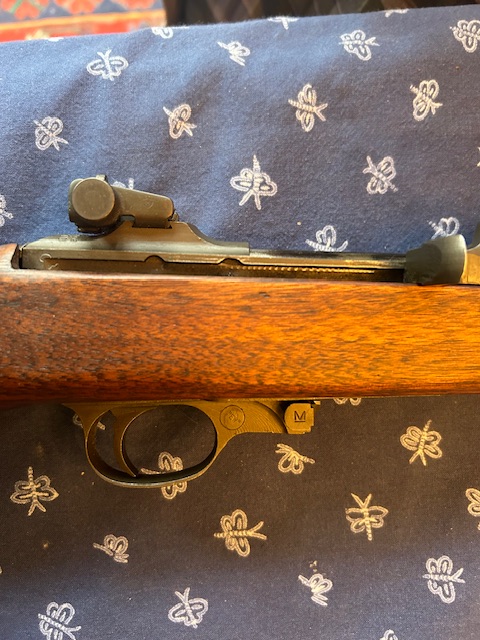

    Legacy Member cpc's Avatar
    Jul 2010
    05-20-2025 @ 02:35 PM
    Michigan
    118
    06-11-2025
    02:17 AM
    Some pictures
