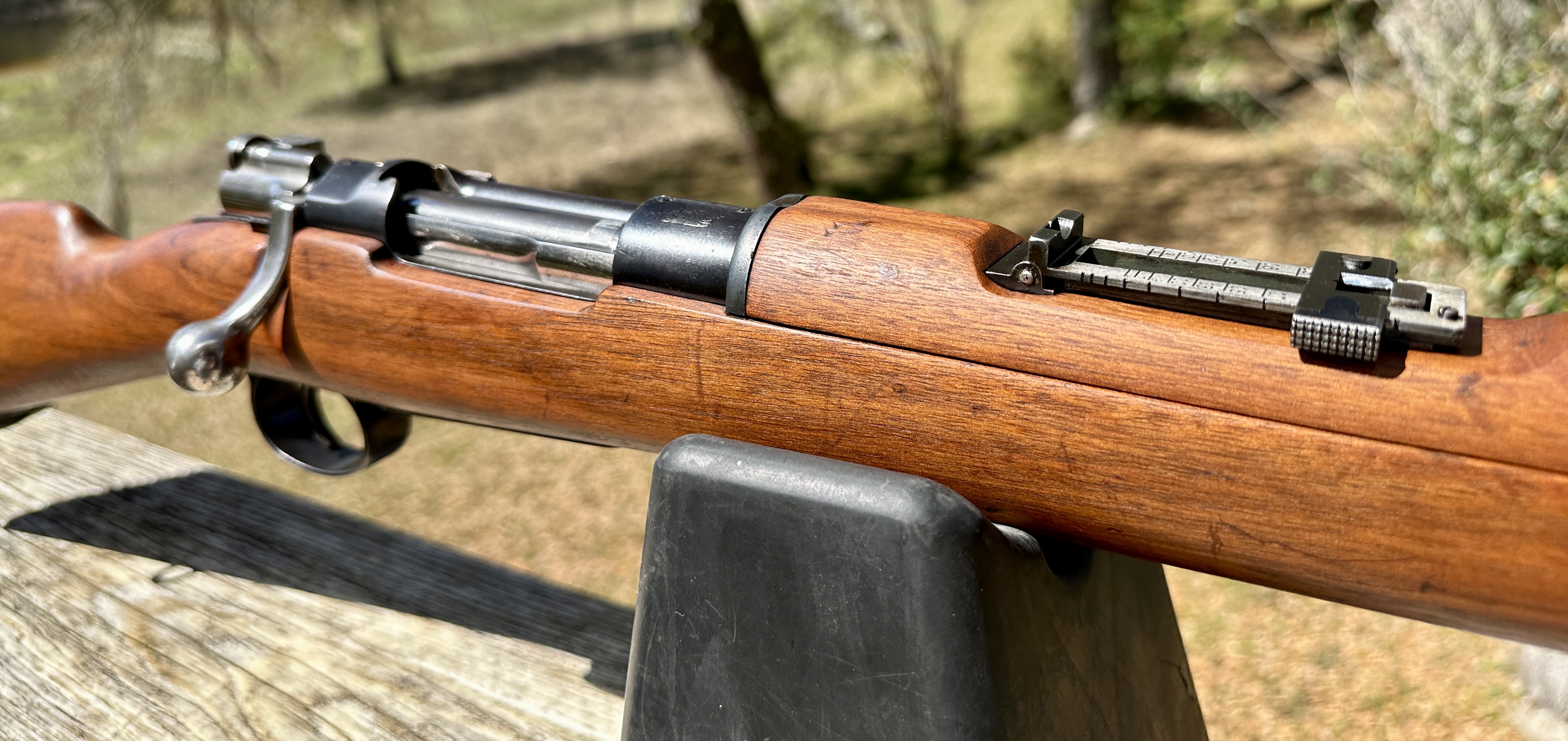

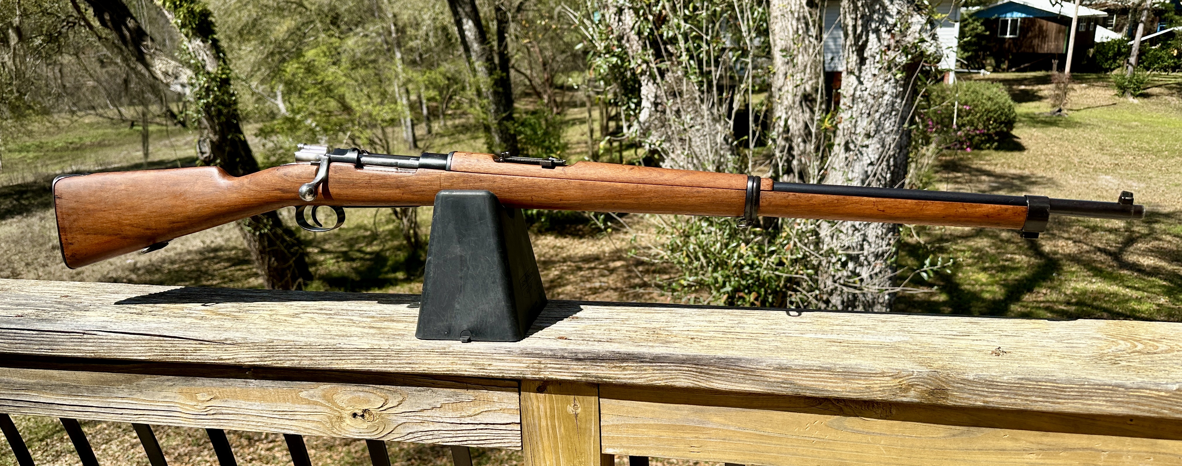

    I finally finished removing the glossy varnish from my 1895 and hand rubbing four coats of raw linseed oilicon into it. Looks good. So I took it to the range. Still shoots.

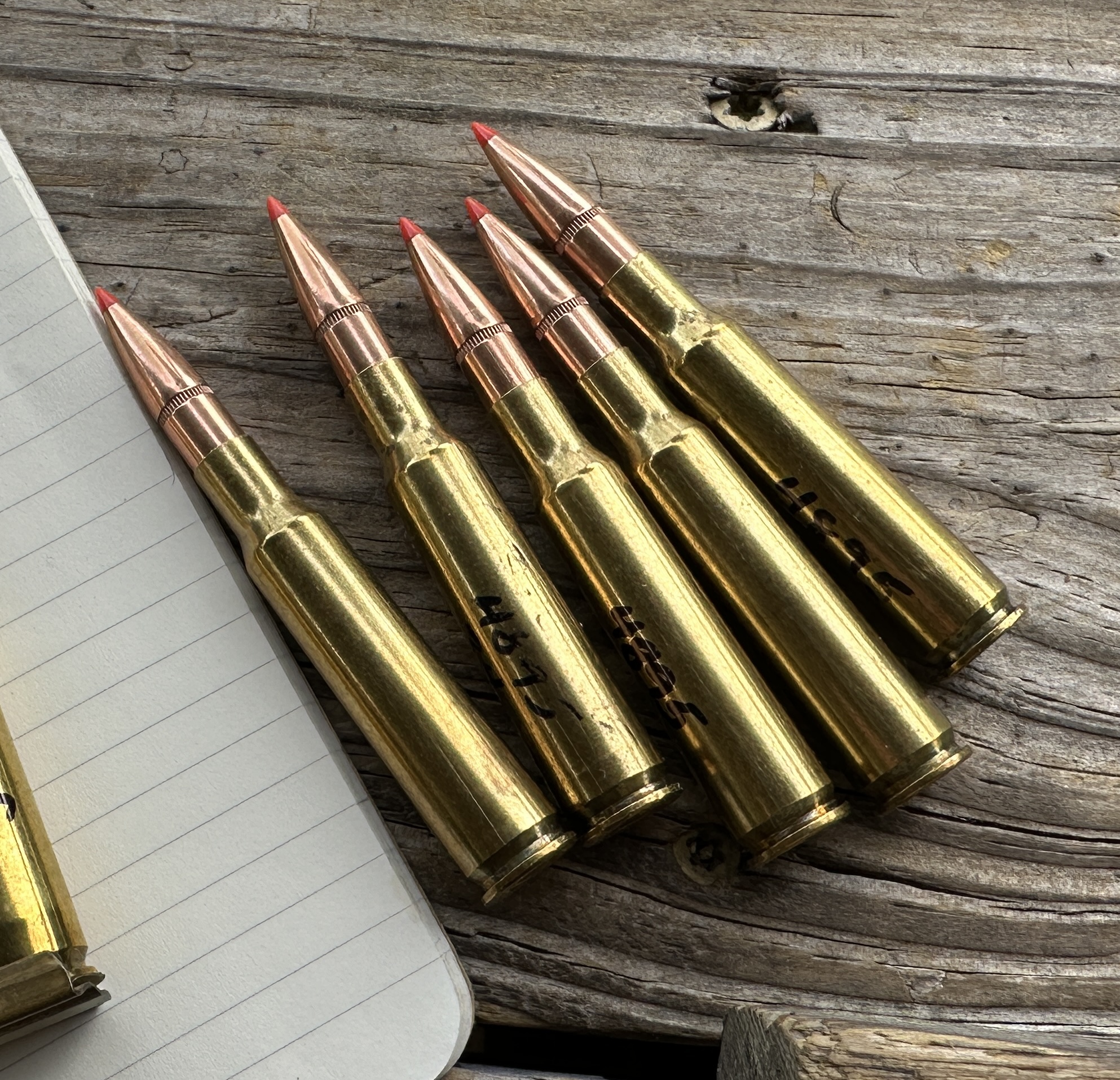

    I decided to start by seating just shy of the rifling. These are single fed as they are longer than the magazine.
    Velocities were also quite a bit slower than the book (Lyman 51). I am shooting Hornady 154 grain SST’s (2nd’s) and IMR 4895. Next time I’ll seat deeper.

    Nicely done, it does look good, and seems to work quite well too.
