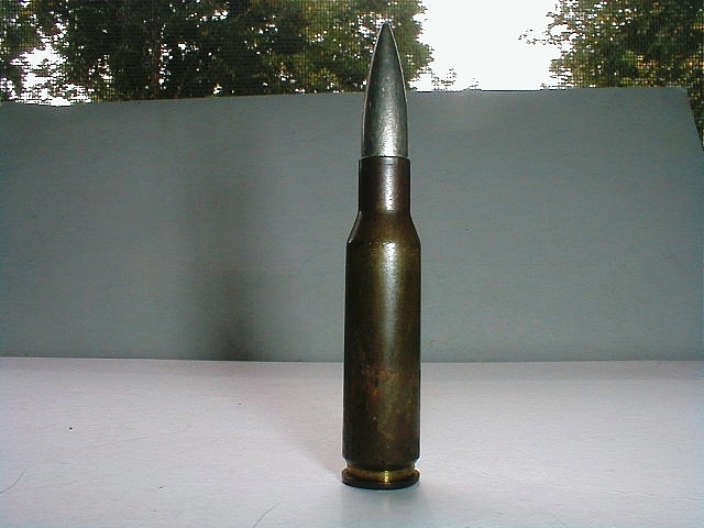

    7x49mm Liviano cartridge
    one of my favorite cartridges that came from the 7,62x49 US case necked down to 7mm
    by FN and chambered in the early FN FAL rifles for Venezuela

    After Venezuela changed over to the 7,62x51, thousands of 7x49mm cartridges were imported to the USAicon. As there were no weapons that chambered this cartridge.
    it sold for around the same price as 22 rim fire cartridges. Some FN FAL collectors had barrels made to use the 7x49mm cartridges and it was well liked by these shooters
