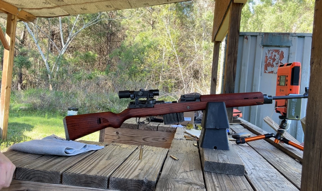

    Got to range to test the two batches of FNM 8mm ammo I got. One with headstamp 71–11 and the other 73-5.
    These are berdan primed cases but my understanding is they are non-corrosive. I cleaned both rifles the next day with Hoppes No. 9. I did not use soapy water.

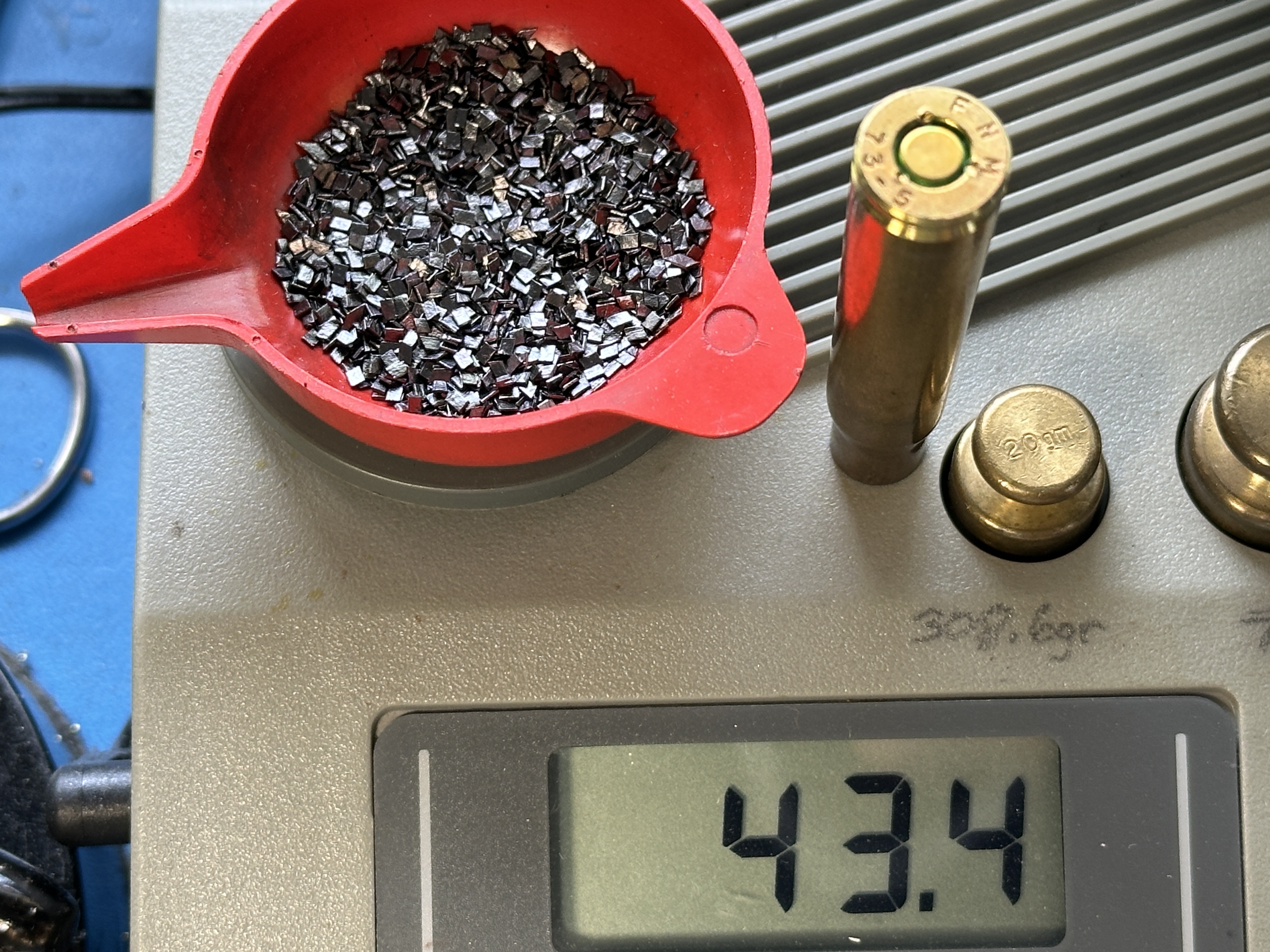

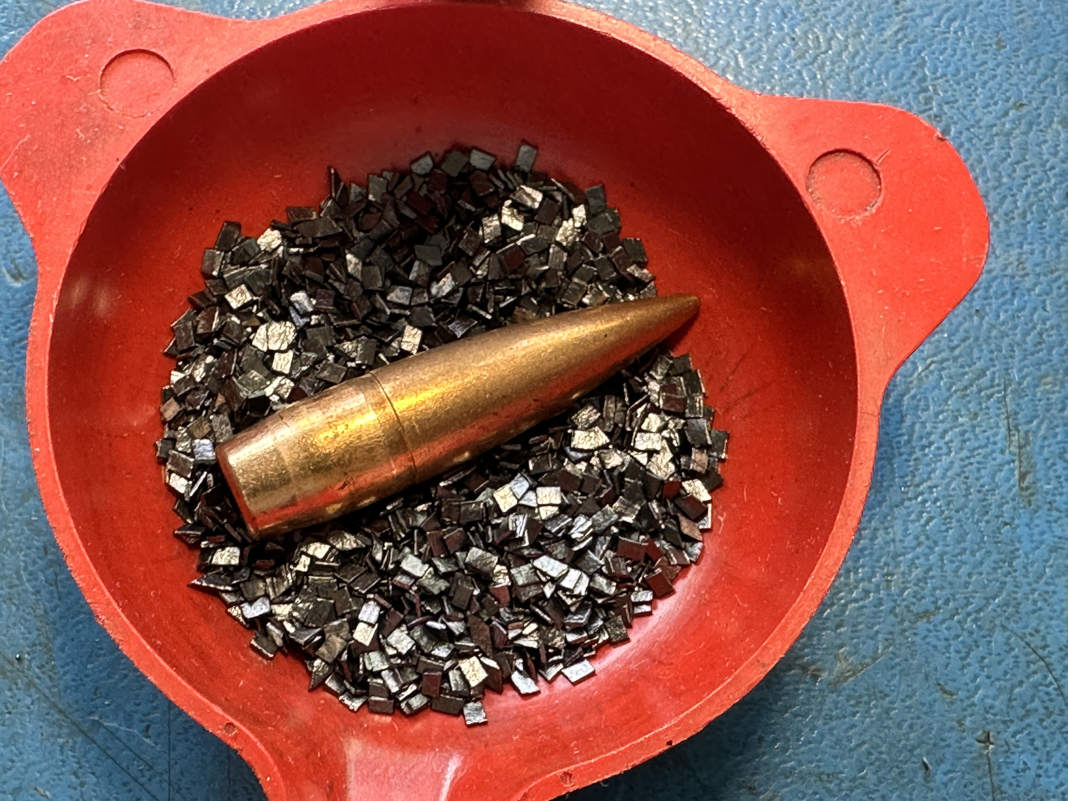

    I pulled one each of the ‘71 and ‘73 headstamps. I found same FMJBT bullet of 197.3 and 197.5 grains respectively. But I was surprised to find the ‘71 has 45.1 grains of a small spherical powder but the ‘73 had 43.4 grains of a gray square flake powder.
    In my dou44 K98K the ‘71 averaged about 2434 fps with a 19.8 standard deviation. The ‘73 averaged 2348 fps and 19.9 standard deviation from same gun. Sampling size of 10 shots. 100 fps difference in production dates.
    In my ac44 G43 I only tried the 73-5 rounds, 10 shots. Average velocity was
    2314 fps and 31.1 standard deviation. Cases ejected 8’-10’ using second smallest gas port installed.
    Accuracy in the K98K was pretty good at 2-3/4” and 2-1/4” respectively at 100 yards.
    I had troubles with my zf4 scope on the G34 so no measurements for it.
    Please share opinions on the supposed no-corrosive nature of this ammo.

    Shot G43 with FNM again yesterday. Only at 25 yards to get my zf4 zeroed for it, as well as find the right gas port size for proper function. All went very well. Groups pretty tight with the FNM, but it is only 25 yards.

    Still need to tweak scope a bit.
