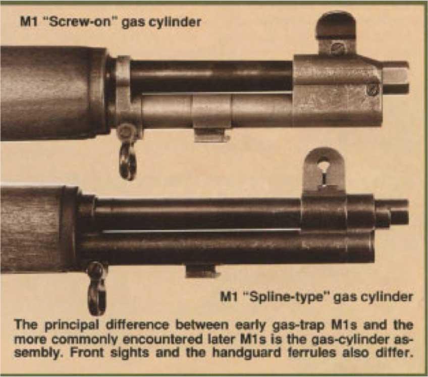

    what is a Schuster fake gas trap block - do you mean an adjustable gas plug if it is the plug it will in no way look like a gas trap rifle

    This is what I had in mind. Not sure how frequently they do runs of them. M1 Garand Gas Trap Conversion - SCHUSTER MFG INC

    It seems like a good concept, installs on an unmodified port barrel, looks close enough for shooter grade.

    Did Schuster go out of business? I understand they don't do frequent runs of the gas cylinder, but it appears that no item on their website, even their flagship ported gas plug, is listed as "in stock".
    I also tried the email address they provide in "about us" with no response, no phone number. Does anyone else make a ported cylinder like it?
    I also put a WTB up a few days ago, if anyone is getting rid of one.

    Seem's Schuster doesn't keep a large inventory. I bought my first one a long time ago, went searching a couple years later for a spare and just like you all was gone. Then last year they were around....now they are gone again. Patients.
