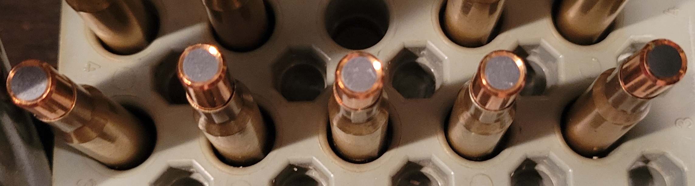

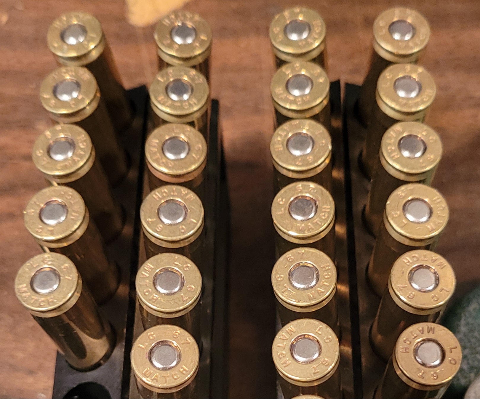

    The head used is a Nosler Partition 150gr Spitzer. Pricey yes but it happens to be one of the very few bare lead semi-skirted base bullets available. Brass is LC Match therefore the load is reduced a half grain. It also received a light kiss of a crimp from the Lee factory crimp die. I didn't setup the chronograph for a true reading but will next time out. As outlined in range reports this is the resulting initial 5 shot group.
    150gr Nosler Partition
    47.4gr W760
    Federal 210 LR Primer
    COL 3.260
    COL is based on OAL gauge measurement of this bullet in the throat of my rifle. Measurement was 3.270, I gave .010 breathing room.
