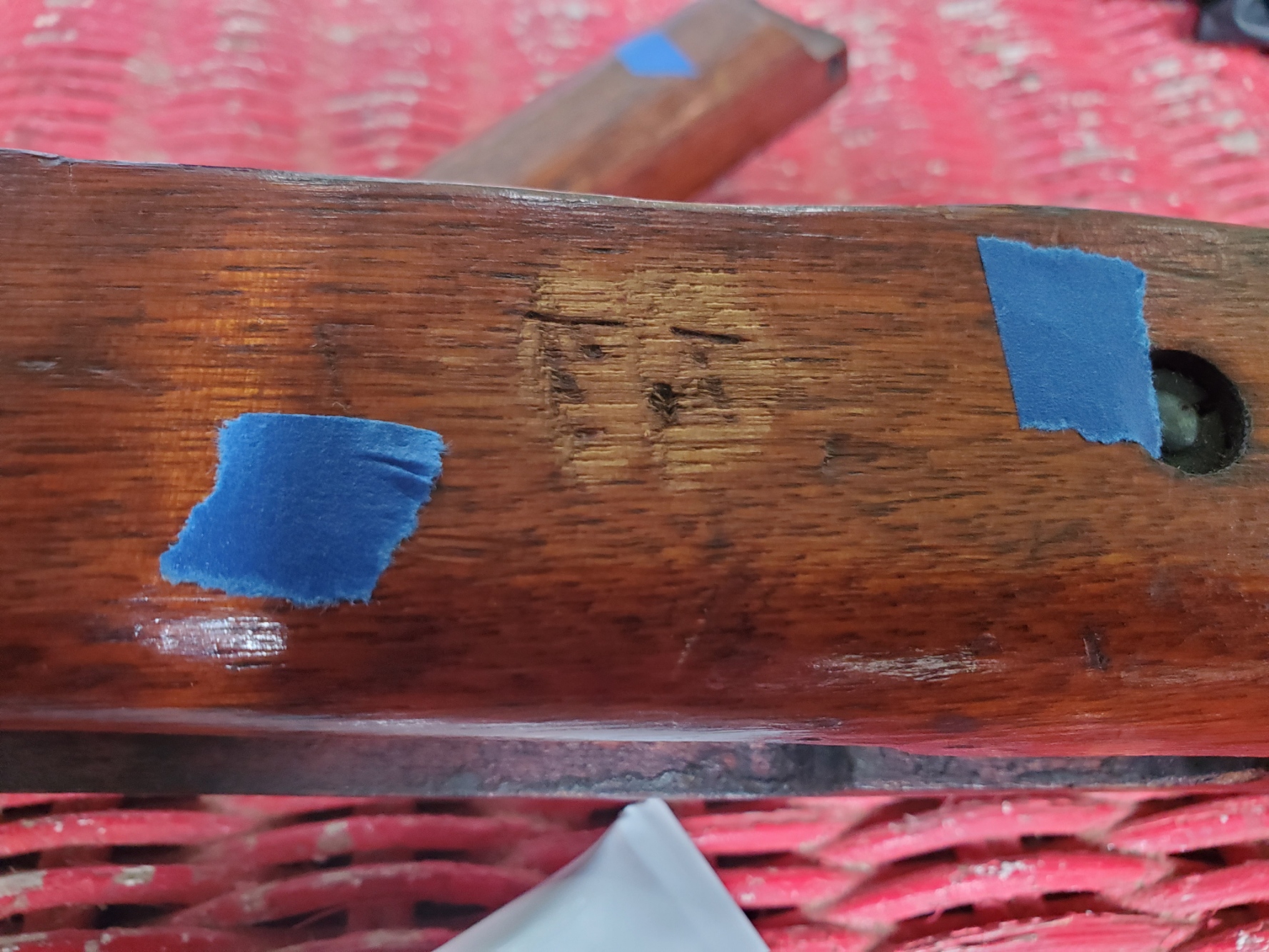

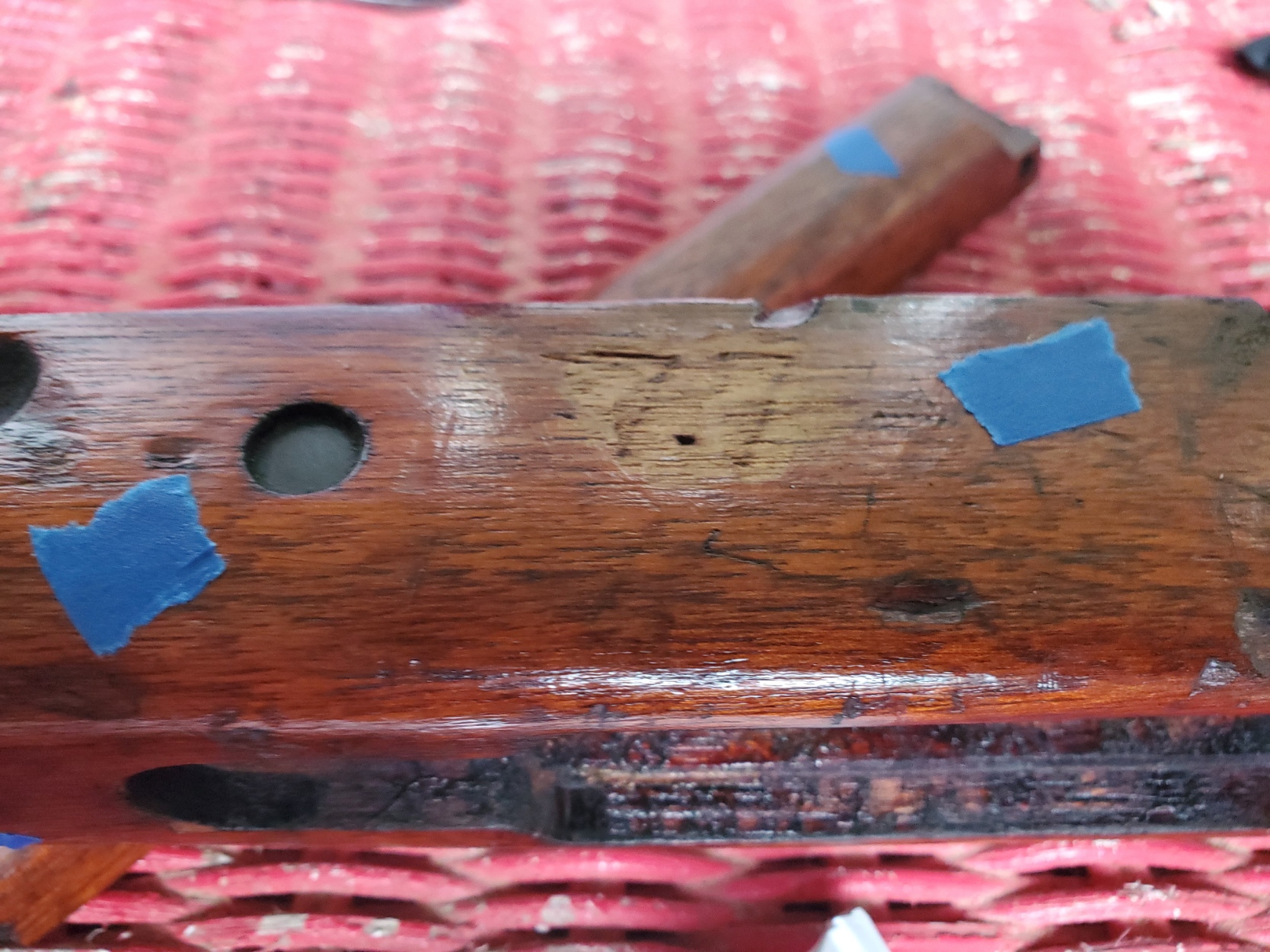

    Several months ago I purchased a T99 long rifle that had several scratches, dings and 2 - 1" areas on either side of the receiver where a previous owner scratched "7.7" into the stock. I assume the same owner or later owner then tried to scratch the "7.7" out and in the process removed the urishi lacquer finish and removed the underlying wood layers. Each location is rough and in a slight depression in the wood felt by rubbing finger over the area.
    There are several other locations on the stock that have been scratched, dinged, frayed over the years exposing the underlying wood.
    I intended to touchup the stock, not a complete re-finish. The rifle being a type 99 long, the chances of easily replacing the stock is not likely. Since the stock was damaged, my intention was to apply urushi to specific spots to seal the exposed wood. This is to preserve the wood, protect it and maybe improve the look of the rifle. My intention was not to cover up the damage that is part of the rifle's story through time.

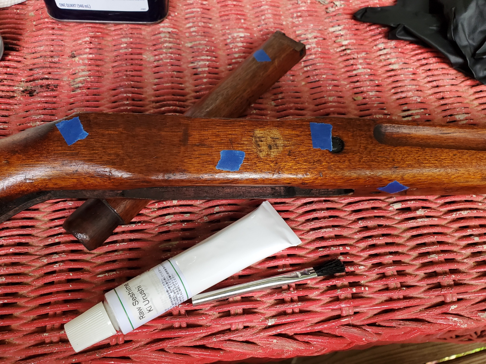

    I purchased some raw Seshime Ki Urushi from Amazon. It came in a sealed metal tube with with the allergy warning stickers. I wont go into the Urushi allergy concerns since most folks here are all familiar with it, if you are not please google it. Proper curing of urushi requires warm temperatures and high humidity. That is exactly what we had in July 2024 in Georgia, USAicon. Three weeks of high humidity, rain and very warm temps - perfect time to do this.
    I had a leftover hooded paper chemical suit laying around, a surgical mask and some gloves. I did the work in a screened porch exposed to the outside heat and humidity, with no direct contact with the rain. I used a small disposable brush, condiment cup, paper towels and some steel wool to work with the urushi.

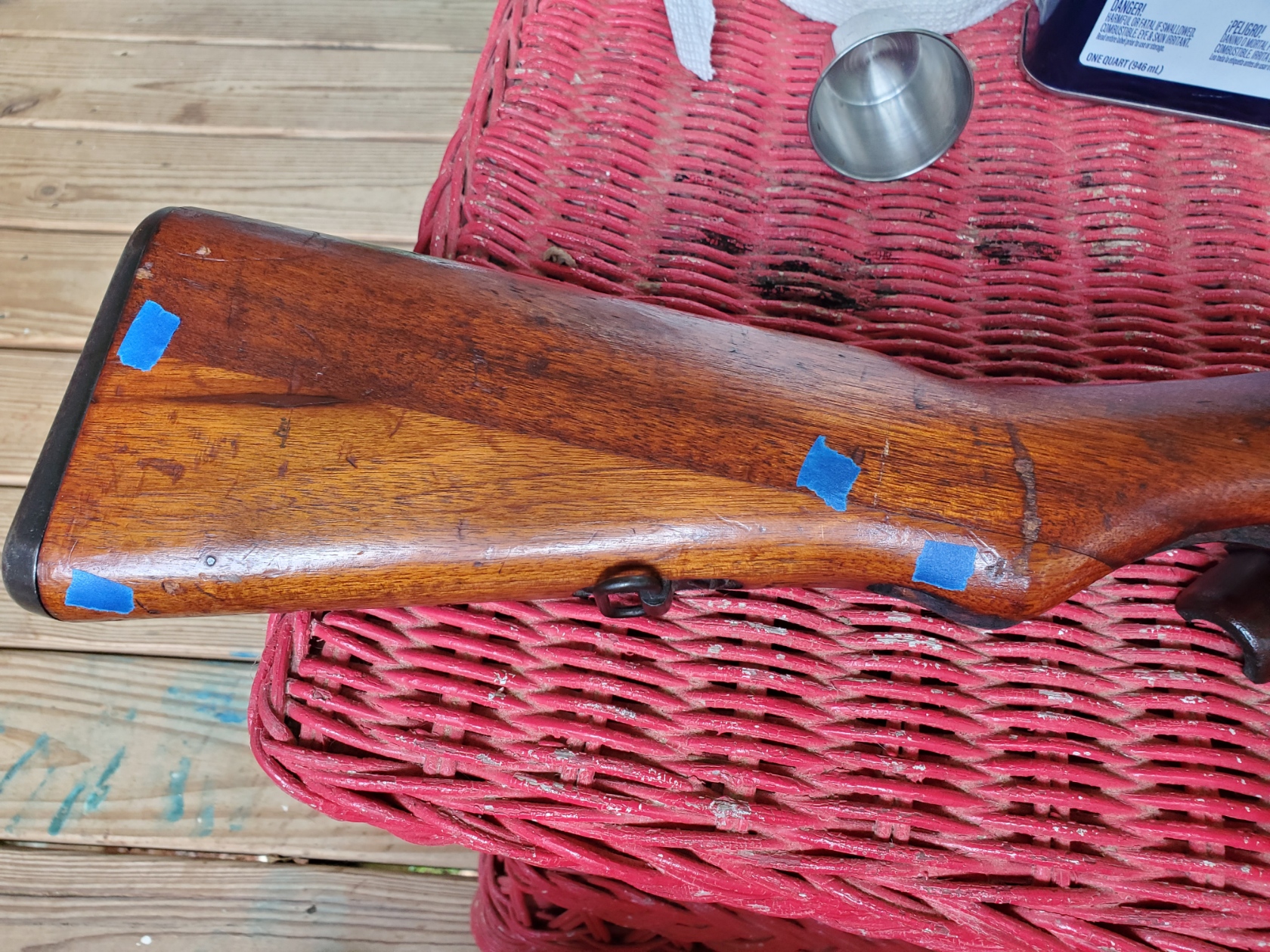

    3. Marked the stock with masking tape all the places intended to apply the urushi.

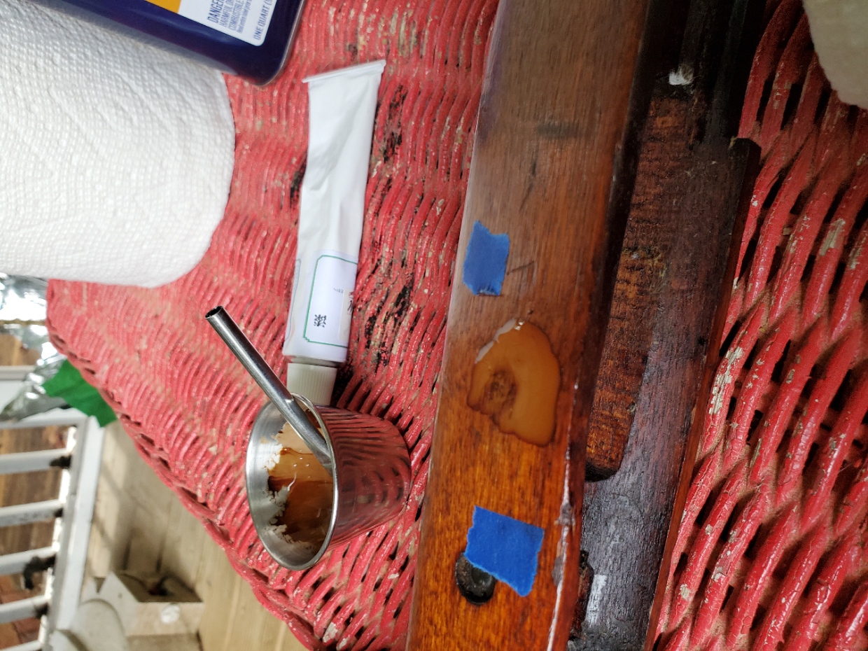

    5. Shook the tube of urushi, a liquid, to mix it. Opened the tube of urushi, and squeezed out some into the condiment cup. It was initially a light tan color.

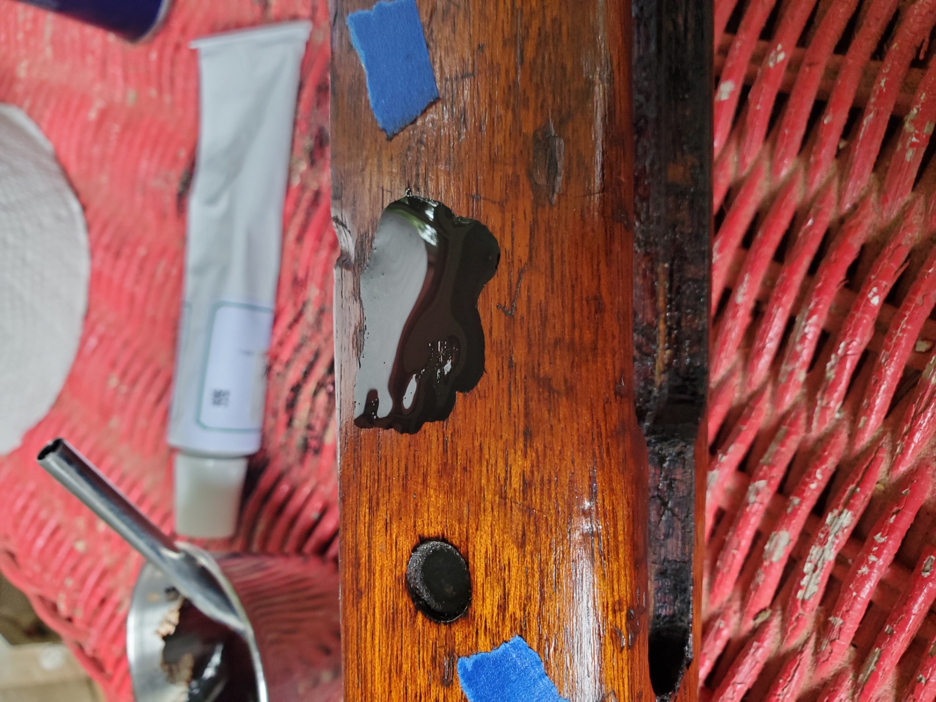

    6. Applied the urushi evenly to the areas with the brush.
    7. Left the urushi on the stock for 15-20 minutes. The urushi quickly changes color to a reddish brown, then a dark chocolate and finally to a black.
    8. After 15 minutes, I wiped off the urushi with a paper towel.
    9. I then used the steel wool to knock down any high spots and applied another coat of urushi. Let sit 15 minutes, then wipe off, etc...

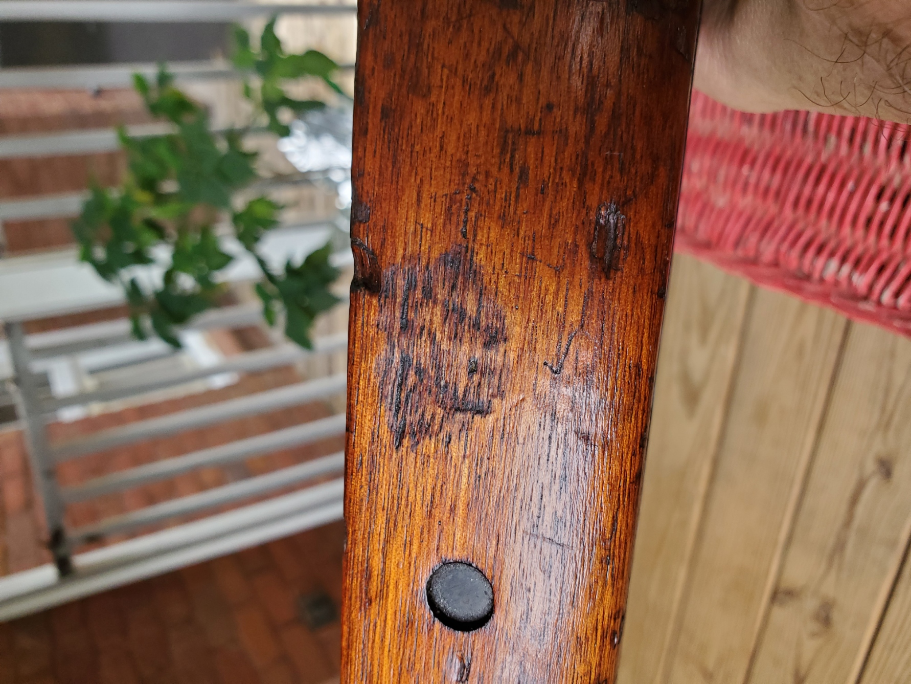

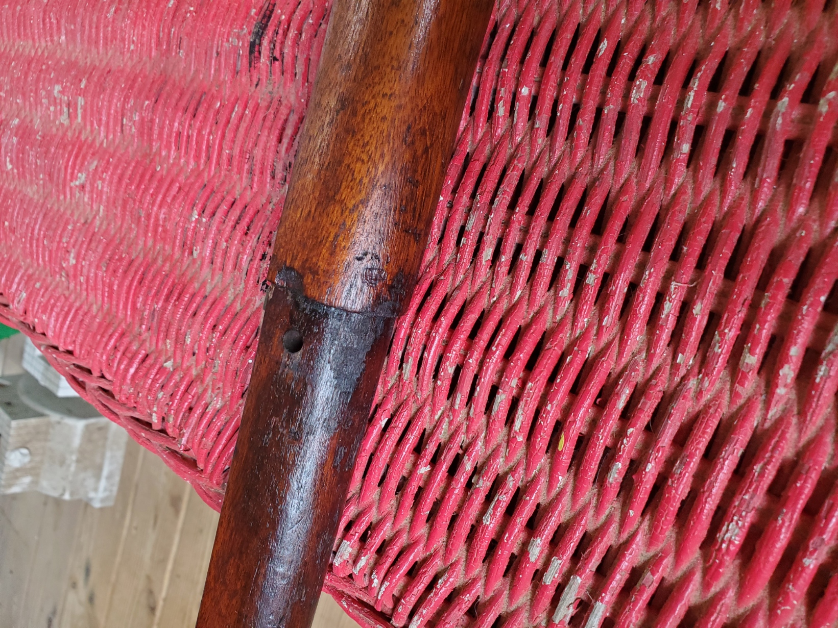

    Pictures:
    Before with places marked with tape:
    Application of Urushi:
    Results:
