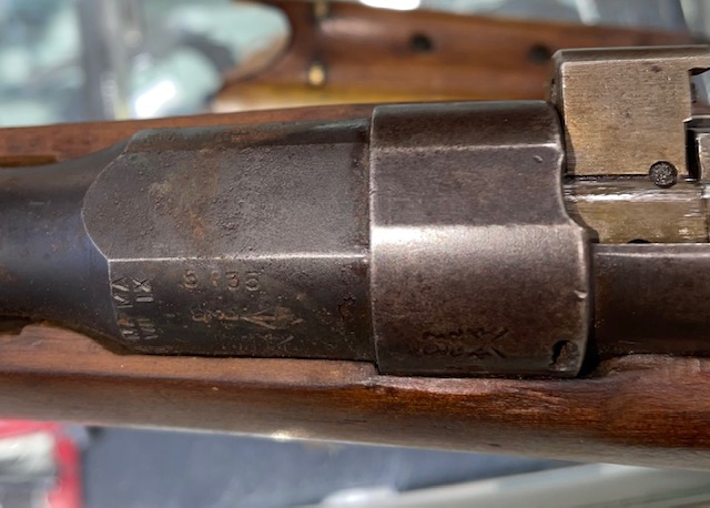

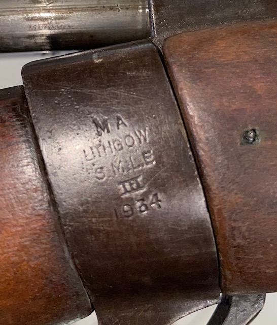

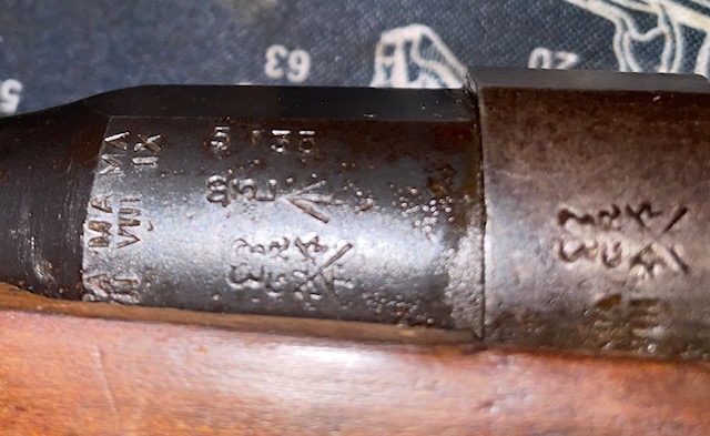

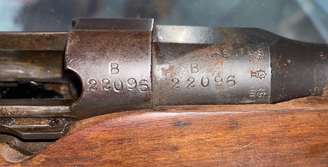

    This 1934 Lithgowicon MK III followed me home from the local pawn shop yesterday. The receiver is marked 1934 and the barrel is dated May 1935. It has been sporterized with a mismatched bolt, but the barrel is full length and looks pretty good. For what I paid for it, I'm definitely restoring it.

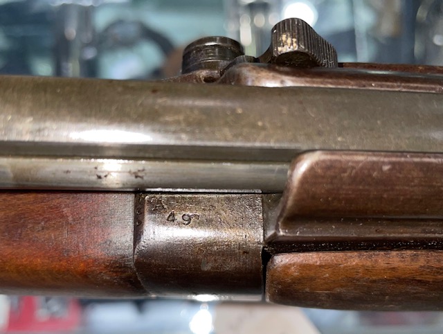

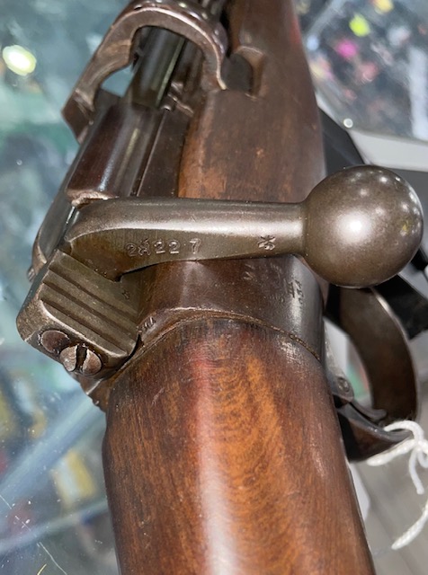

    The bolt is a Bathurst marked "28227"" and all the parts are Ozzy. The receiver main serial # is "B22096" and the Lithgow Serial by the bolt track is "A49". The bolt looks like it has been with this rifle for a long time. Head space is great, but I haven't checked the locking lugs yet.

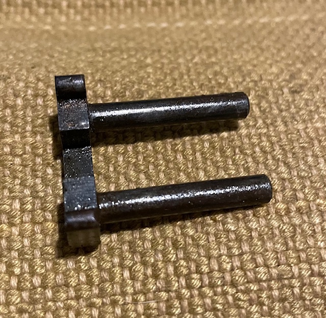

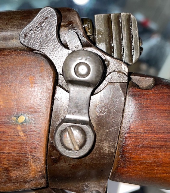

    An interesting find is the stock was fitted with the rear tie plate with the steel pins going forward (see Pic). Even with these installed, the stock is pretty hammered at the draws.
    I have a good bit of what is needed to get her back, but I'm gonna need help for sure.
    Opinions? Observations??
    Thanks!

    I just happened to go by the place and saw it on the rack with a bunch of other uninteresting guns.
    Was there procedure on marking replacement bolts by the Australians? This bolt is BA marked, but the serial number on it (if it came from another rifle) would be much earlier than WWII.

    Coatimundi most ww2 production rifles where put together of parts from forbe, orange Bathurst and Wellington feeder factories ,if it was built in 1934 it would have a lot more MA marked parts on it . You will find on most FTR rifles there is a mix of those feeder sites stamps .still a rare year rifle i may be able to help you out with a Ma butt plate let me look today for you

    Thanks! Maybe a rebuild before they started stamping the MA and date on the receiver for FTR.
    The barrel is dated May 1935 and the rear sight is original and serial matching. The tie plate at the back of the stock has the metal rods to reinforce the draws which I understand was only done for a short time which is neat.
    The wood has been really sanded so all the usual info is unreadable.

    If the bolt is marked BA, it was most likely a replacement bolt for an earlier rifle at one time, probably a 1915 action.
    If it was paired to this action by any military workshops it would have been numbered to match.
    The recoil pin arrangement was not effective. Time consuming and the few forends I’ve seen with them were buggered. The pins never even lined up with the sear lugs properly anyway.
    I did have a bolt at one time very close to that but it is long gone
