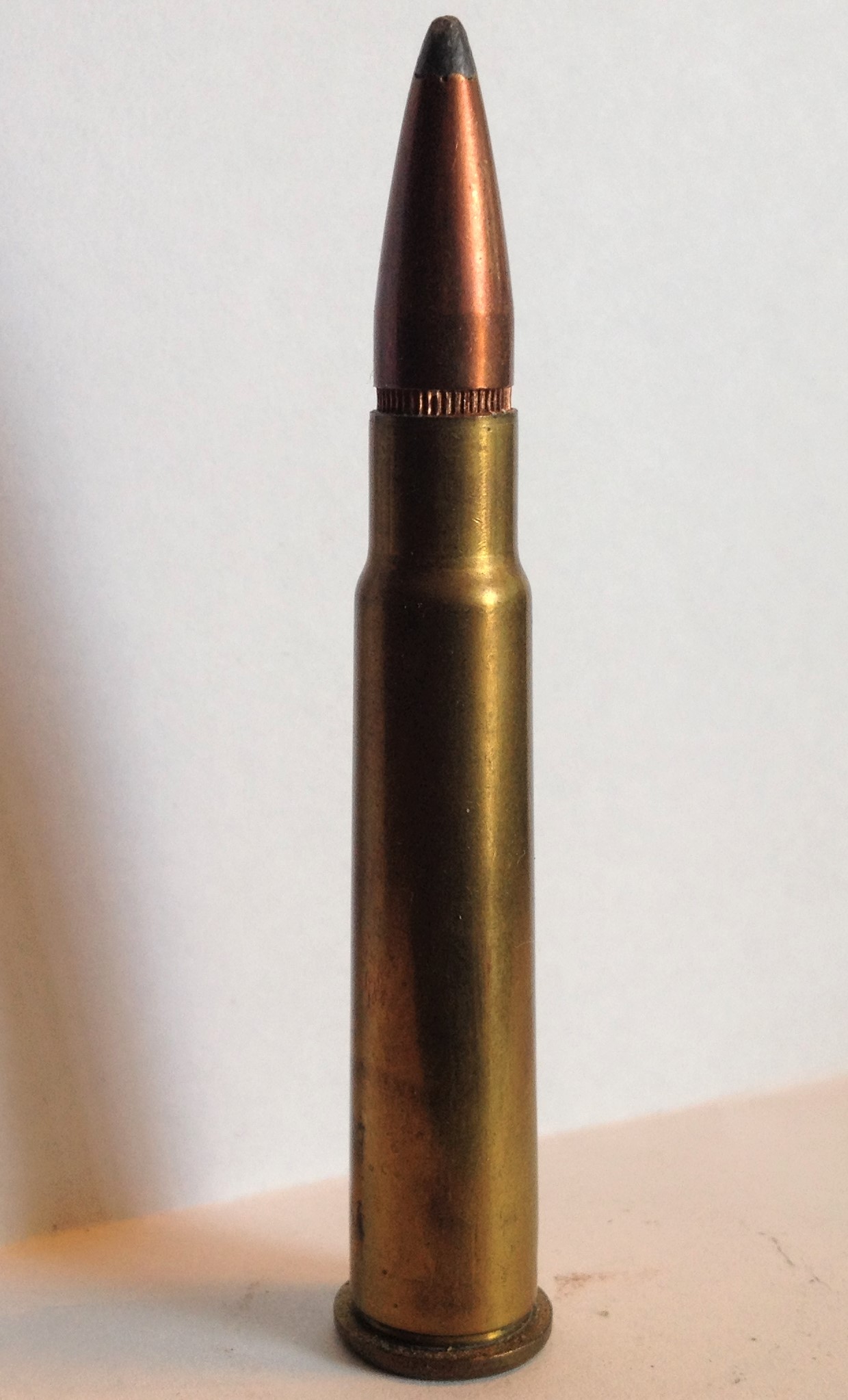

    I also lucked onto 400 174gn FMJBT's Highlands a little while ago (3 years) so have @500 of them tucked away for a rainy day but the bulk of my 303 are Sierra's which can be fickle depending on load.
    I have had good success with the Hornady .312" SPFB 150gn they fly very well indeed I've only shot them to 500m out of my 2 groove No.4's they go pretty good.

    See pic how I load them with a medium crimping into the cannular.
