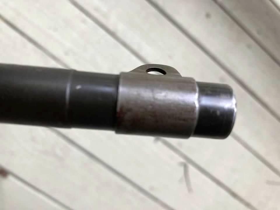

    The barrel bad is marked 'IS" (or "SI"?).

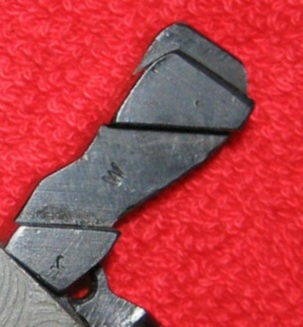

    Here's a pic of a Winchester marked hammer for comparison to yours. - Bob

    SI Bayonet band was made for Inland.

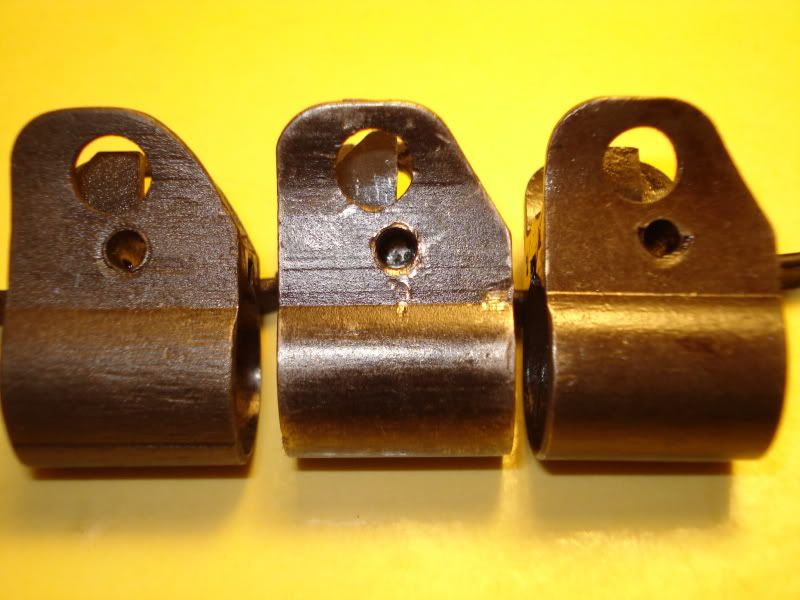

    Your Recoil Plate will have a letter code on it below the wood line. The Screw with the x or + mark is known to be a winchester thing.
    Front Sight has what most call the Thumbnail print and associate with Winchester, but this can be found to some degree on other makers Sights also.
    Compare the rear slope of the outer ear of Your Sight to the picture I added of L-R:
    a WRA - N- RMC, The WRA sights have a arced slope, the other 2 a straighter slope with no arc.
