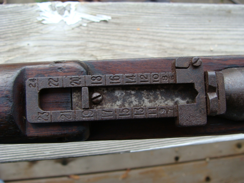

    and the rear sight slider

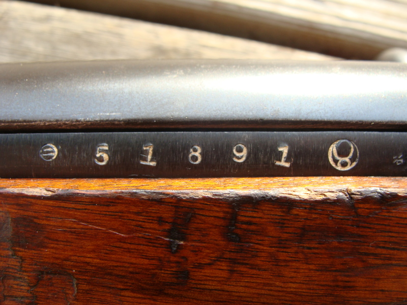

    Matching bolt

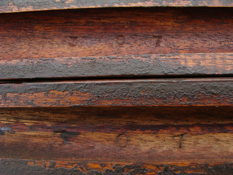

    and handguard and stock.

    The rear sight
    is matched to the bolt catch and bolt catch spring
