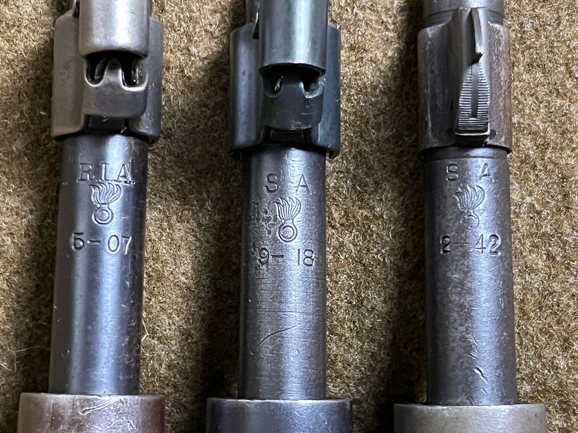

    That barrel is out to lunch, the markings are in the right place relating to the front sight but I'll bet you'd find the front sight keyway area was cut off and this piece was grafted(sleeved) on to bring it back to having a front sight. That's why the sight is out of place and a long muzzle.

    Thanks Gents, I must admit never noticed the front sight, looking at a few pics in Brophy’s book, it looks like the site is positioned correct but barrel is longer, I’ll get more pics up as I’m going to strip it today to get some heat in the timber to sweat all the crudout.
    Can anyone give me a measurement from the front stock to the sight block and from the stock to the barrel muzzle please.

    Roughly 2" behind and 1/2" in front.

    Before being stripped I measured the sight block , it is correct ( 1/8” short of 2” from nose band to rear of block, the protruding bit of barrel is 1 1/4” from front of Sight block, I can’t see any Join but guess it’s under the block, I think someone has took a measurement of the barrel but not included the barrel tennion, so measured from the rear sight base and they were short of 24” which is what’s required for a shotgun over here ( U.K.) so they’ve added an inch. Then bored it out to smooth bore.
    Butt plate is a smooth one, mag follower machined, I’d say it’s just the barrel that’s been replaced and the original possibly was ok, going on condition of rifle I’d of kept a decent barrel and used a shot-out one to smoothbore it.
    It's at the back. That's why the step at the back of the foresight looks a bit odd.
    Quote Originally Posted by bigduke6 View Post
    That makes perfect sense. They didn't know to use a rod in the bore to measure...against a closed bolt.
