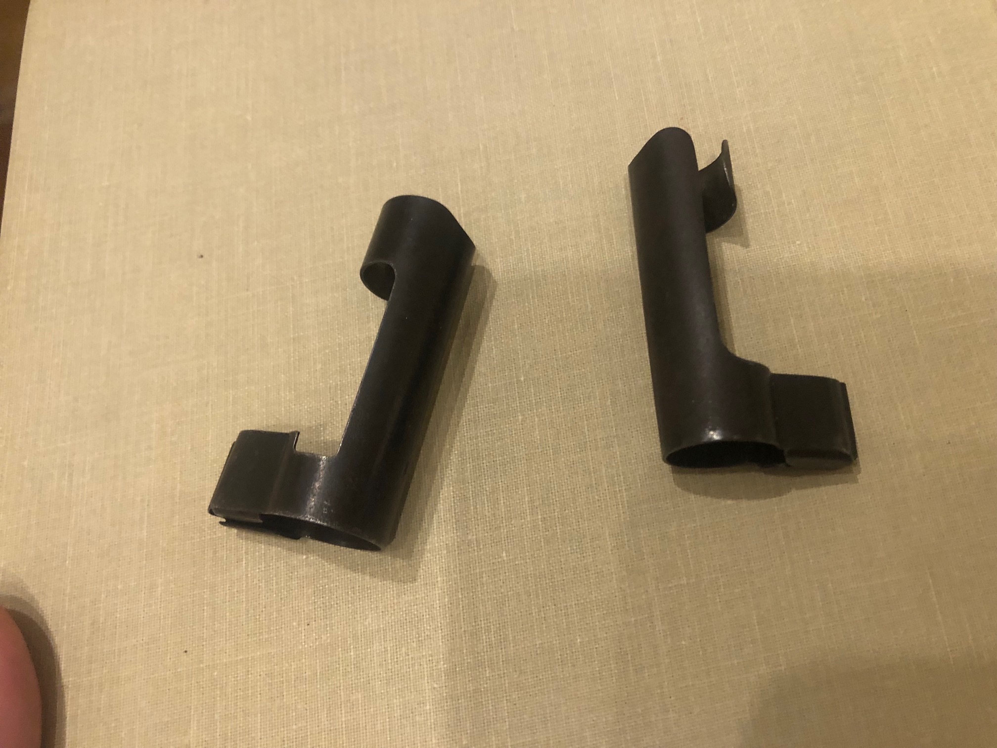

    I picke dup a few things today but I'm struggling to identify some of them - all input would be gratefully received.
    In no particular order:
    1. A Salter spring weight weigher which is similar to those used with the Lewis MG but this is made of steel and the T-Shaped addition looks as though it would fit on the end of a wooden rod. It is Broad Arrow marked.
    2. A brass implement with a scribe attached on a chain. You can see the Broad Arrow marking and Crown above INO above 303.
    3. A bore inspection mirror for something like .50 Cal but unlike others I have seen, especially with the two rivets and a screw at the rear.
    4. A couple of Protectors, Sight which could be used on Lee Metford, Long Lees and Martini Enfields. One is Broad Arrow marked and has the Serial No. 611

    Not sure of the rest but the string steel sight protectors are for all models of long lee, except the CLLE variants with pattern 14 style front sight wings.
